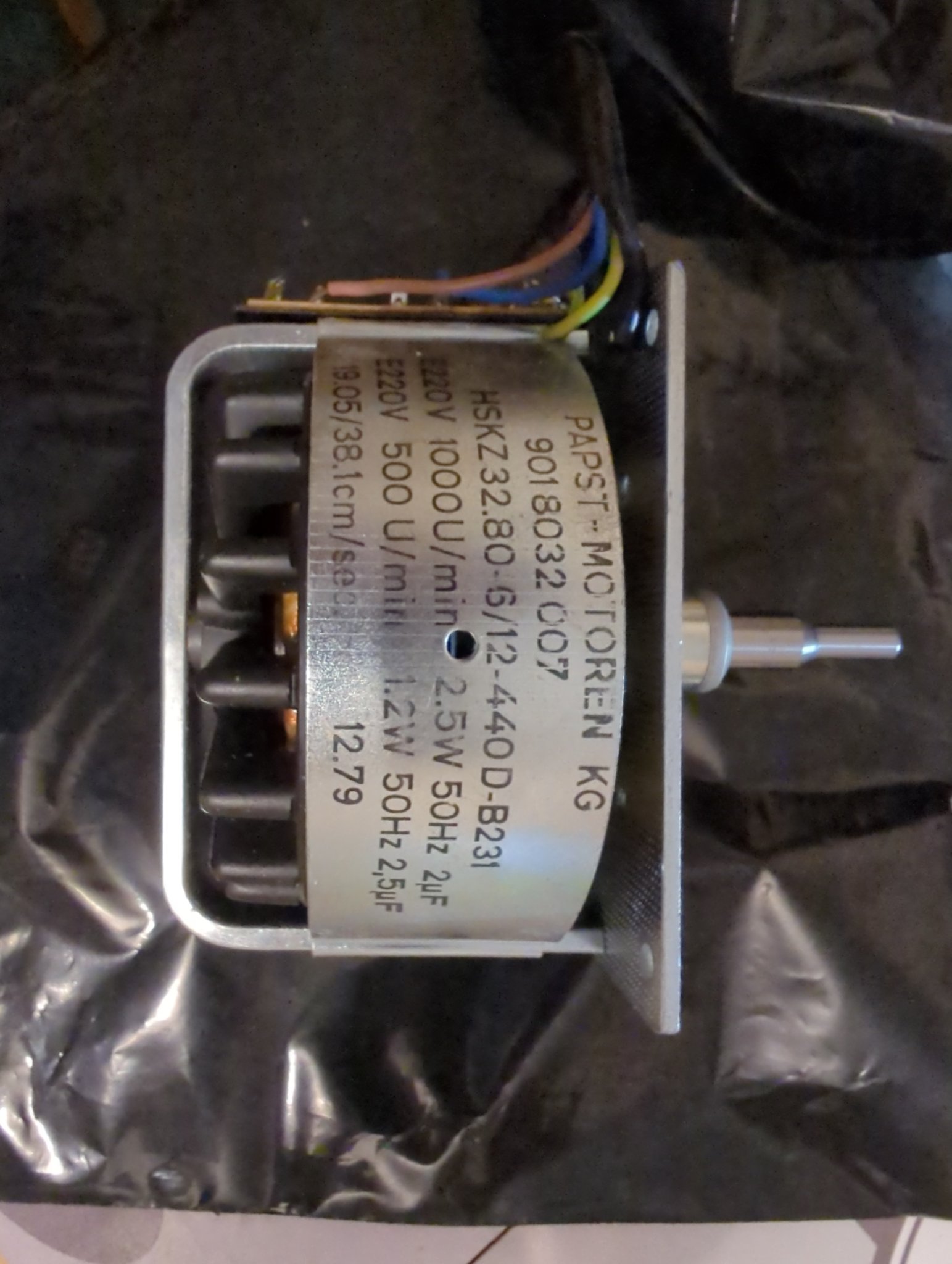

I am ready to run my Papst motor in 3-phase. It lives in my Fairchild 412-1A, model Papst HSM 14.50-4-675D. I live in Europe and am ready to upgrade my farmer-bodged pulley to compensate for the 50Hz.
I have been following these discussions for some years and noticed that several of you—Ralph, Bill, twystd, have used the SG4 to run these Papst motors in 3-phase. Can you tell me if there is any thing more that I would need aside from:
SG4 kit
3 channel 200W CLASS D Amplifier Board which Ralphfcooke linked earlier
3 x 60VA transformers for powering each phase
Thanks !
SG4 kit
Thanks !
Yes, an NTC between the amp output and the transformer is a good idea (NTC 5D-9), in addition a low pass filter/attenuator between the SG4 and the amp inputs, something like this, post #86, even better if you replace one of the resistors with a trimpot so that you can balance the transformer outputs exactly
https://www.diyaudio.com/community/...vpi-synchronous-turntable-motor.295367/page-5
Thanks Ralph. And with three 60VA transformers you suppose I don’t need a fan like you did with the three 80VA ?
I like the fan, a 12v unit running at 8v makes no discernable noise, but keeps the amp at near enough room temperature. It's only the transformers that get warm.

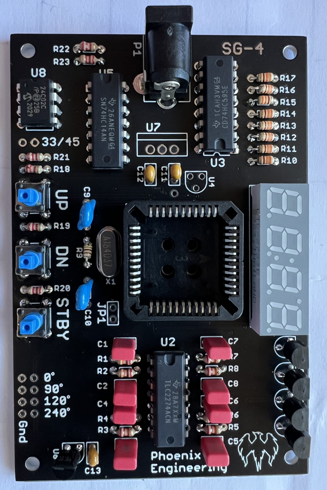

Is your MCP101 the D or the H version? can you also send an image of the reverse of the board?
Both these are needed to definitely confirm the correct fitting.
Thank you Pyramid for posting schematics!!
And thank you Ralph for your response!
I was able to figure it out. Sorry for seeming lazy, I didn’t notice the schematic PDF at first.
These are Rev A or Rev B since “pin 1” (the pin nearest the U4 marking) goes to ground—which means it was designed with the DS1833 in mind.
My MCP101 is the “H” bondout (version) so it gets installed backwards.
DS1833: 1-Vss (ground) 2-reset 3-Vdd (power)
MCP101 “H”: 1-Vdd 2-reset 3-Vss
Please correct me if I got any of that wrong.
