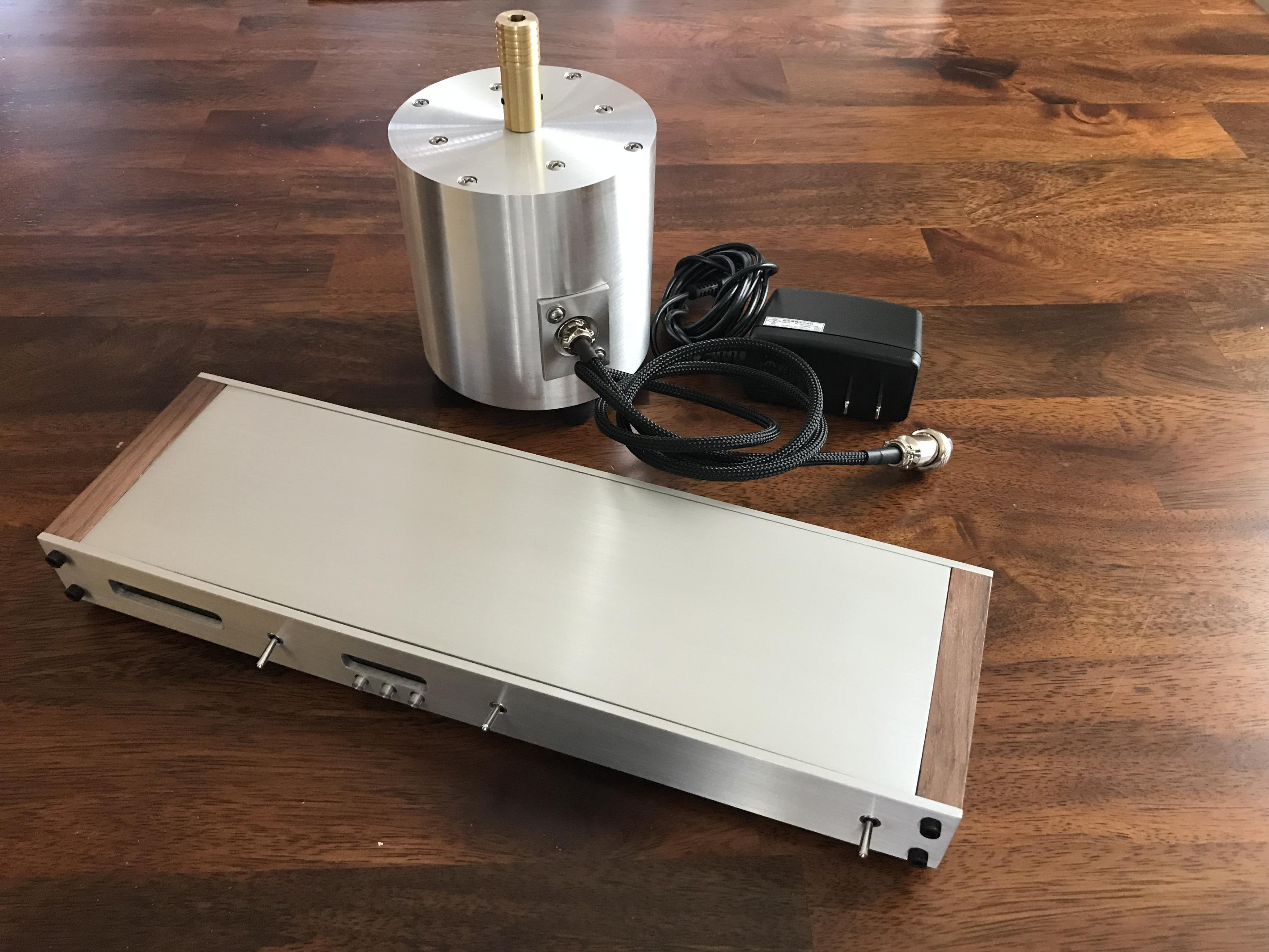

There is a jumper on the board to accommodate both 50 and 60 Hz operation. Details in the manual pdf at beginning of thread....doh to slow. Will cover up with a semi-money shot...hope to be spinning with it by the weekend.

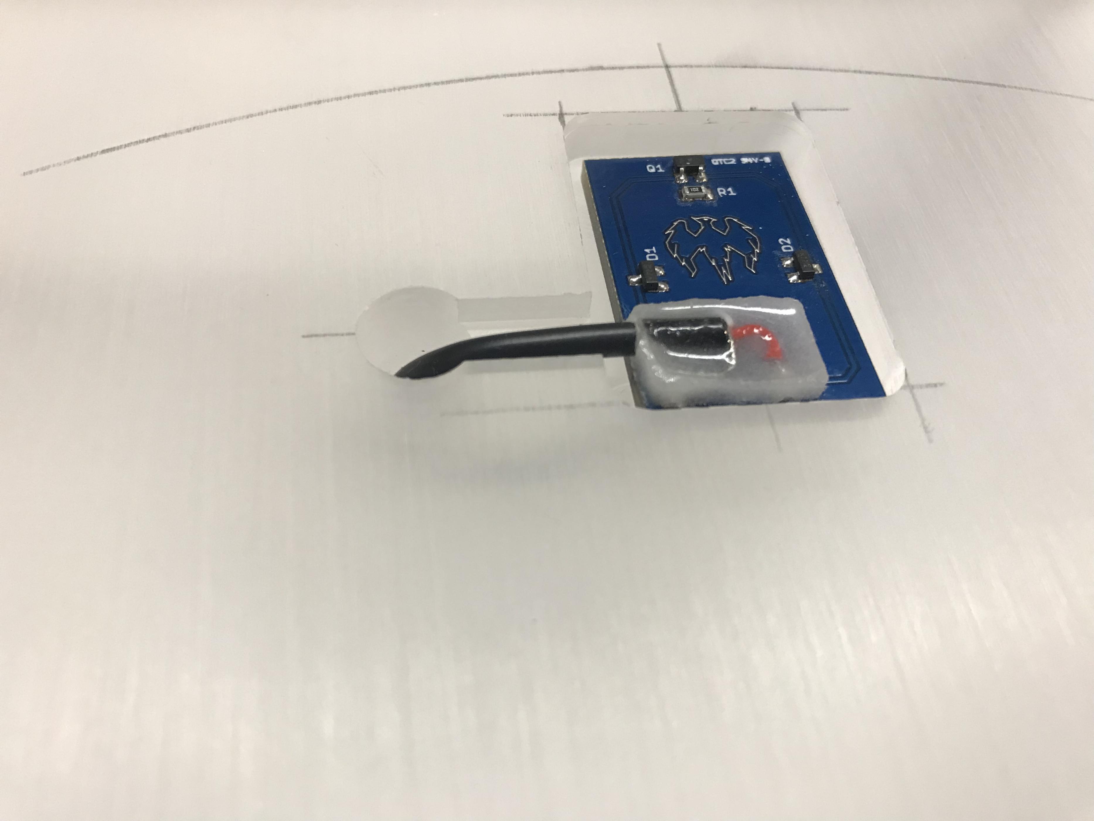

I’m working on some last OCD details on my turntable project that I’m using the SG4 based drive system with that I built.
Since I integrated my Roadrunner in the same case to keep things compact and clean I also decided I didn’t want the wiring for the Roadrunner sensor hanging off the side of the table.
To that end, I removed the bulky stereo jack on the Roadrunner sensor pcb and the elbow plug from the sensor cable. I soldered the cable wiring directly to the sensor pcb and bonded/potted the end to the board with epoxy to seal and stabilize it.
The result gave me a height less than half of the original connection that would be easier to tuck completely under the platter out of sight where the wiring can be passed through the plinth.
I then machined a recess and hole in the plinth for the sensor and wiring (picture).
I just need to mount the sensor with the wire passing hidden through the plinth.
I need to make sure I have a viable distance between the sensor and the magnet. I checked the manual and looked for threads/info, but couldn’t find a specification.
I’ve got a small gap of less than 2 mm between the bottom of the platter and the plinth surface. The top surface of the sensor is about 2 mm below the plinth surface without adhesive in place. So I’m guessing a gap of about 3 mm give or take.
I may have to adjust the height of the platter during setup. I’m pretty sure I’m currently within the proper gap range for proper sensor operation. Can you give me a ballpark figure on what the maximum gap can be and still have proper operation?

With the 1/32" thick magnet, you need to be within ~1/4". If you go with a stronger magnet (1/16" thick) you can get away with a little more. The closer the better without making contact.
I used a 13mm X 2mm disc type neodymium magnet and it would work at somewhere half inch to 3/4" gap. I wonder if narrowing the gap would have any effect on the accuracy or stability in theory? I did experiment a little and didn't see anything significant, unless its entirely out with no reading.
Thanks for the response. I have the smaller neo magnet to work with right now. It is about 1.25mm thick if I remember correctly, and the gap between the plinth surface and the bottom of the platter allows it to fit with about .5mm of clearance.
The only issue I foresee is if the platter is slightly too low to clear the sensor pcb wiring which is just proud of the plinth surface. I think it will clear, but if it doesn’t I will have to shim the bearing which will add another 2mm or so to the gap. That will put me in the 5mm gap ballpark, which should still work well I hope.

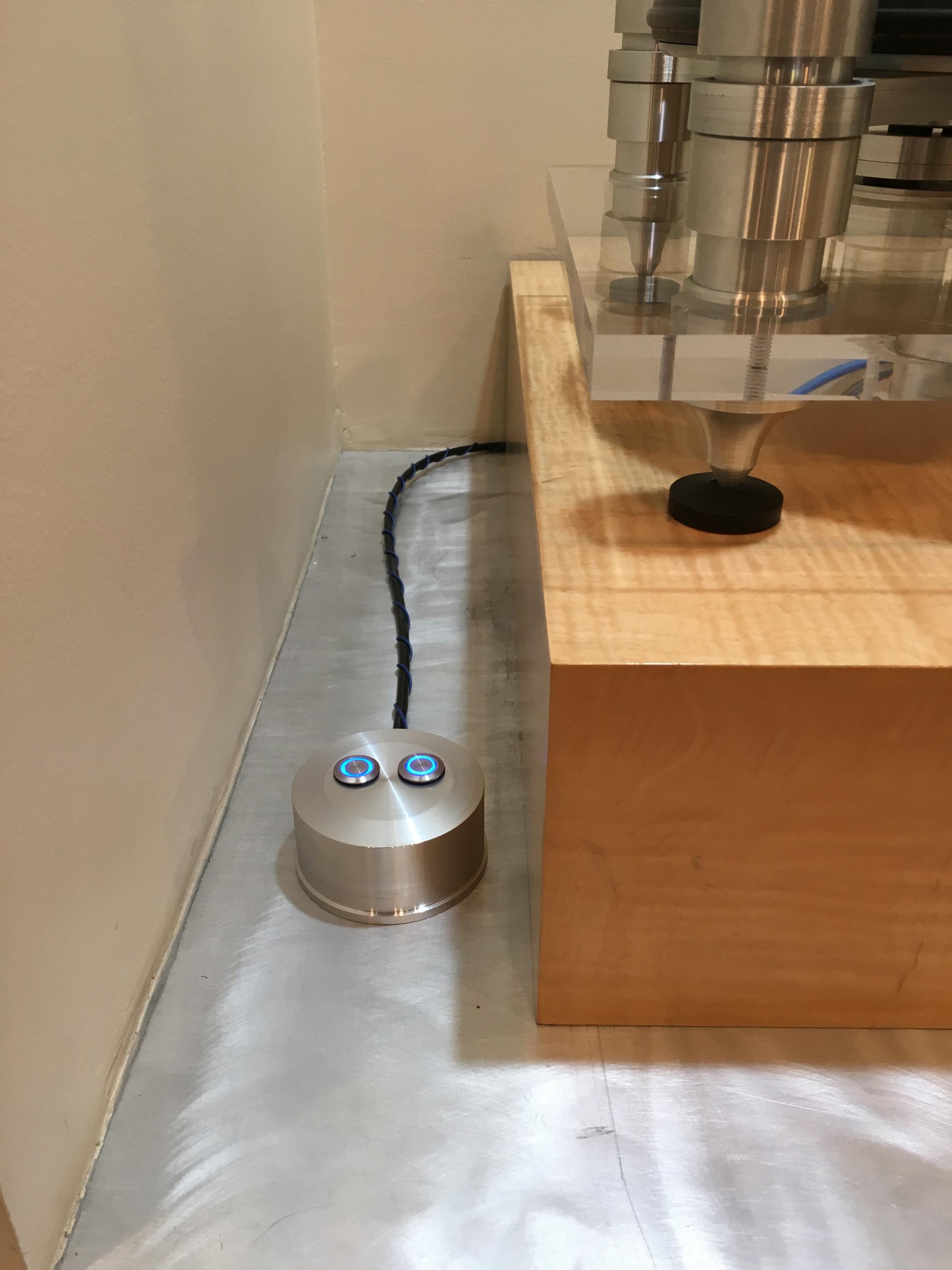

I made a remote stby & speed selector switch for mine that is near the turntable. I tend not to make speed adjustments once they're set so this works fine. I'm making a smaller version with micro buttons and will machine buttons to work with them.
Gregory
Very, very nice! I like the idea of a separate standby switch so I mounted one next to the rotary encoder. Love it! Just 2 short wires soldered to the Ground & Standby points at the encoder board. Your idea encouraged a practical solution to have a remote like yours needing a 3 wire connection, ground being common for both 33/45 switch and standby switch and plugged to the back panel with a 3.5mm stereo jack & plug. Perhaps I'll also omit having a speed selector switch at the front panel, just encoder knob, power switch and LED display, that's it. Neat!
