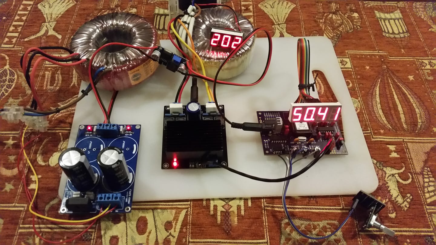

This is the latest rigging up of everything under test and putting it through its paces.
I added an output AC voltmeter and buck converter to power the SG-4 module. The buck converter module is far cheaper and possibly a better bet than good ole LM317 to power the SG-4. I really hope its reliable throughout.
I think buck converters are a great choice for DC step down. Input is 33V adjusted to 12Vdc sourced from the Linear rectifier board that also power the TDA7498 amp.
I'm using massive sized transformers just for test for these are the only ones I have lying around and suitable. Actual ones to be used are in process of being purchased. Currently on back order.
At this moment, there's a voltage drop of 2-3VAC with motor load connected at the output. Not a problem.
So far so good. I sensed a more superior sound from the table. There's no looking back. This project must be finished.

Great testing setup.
Could you please share what is the display in the picture. Can I also kindly ask you to give the pi out translation and which pin of the display goes where on the Pcb. This will be greatly appreciated.

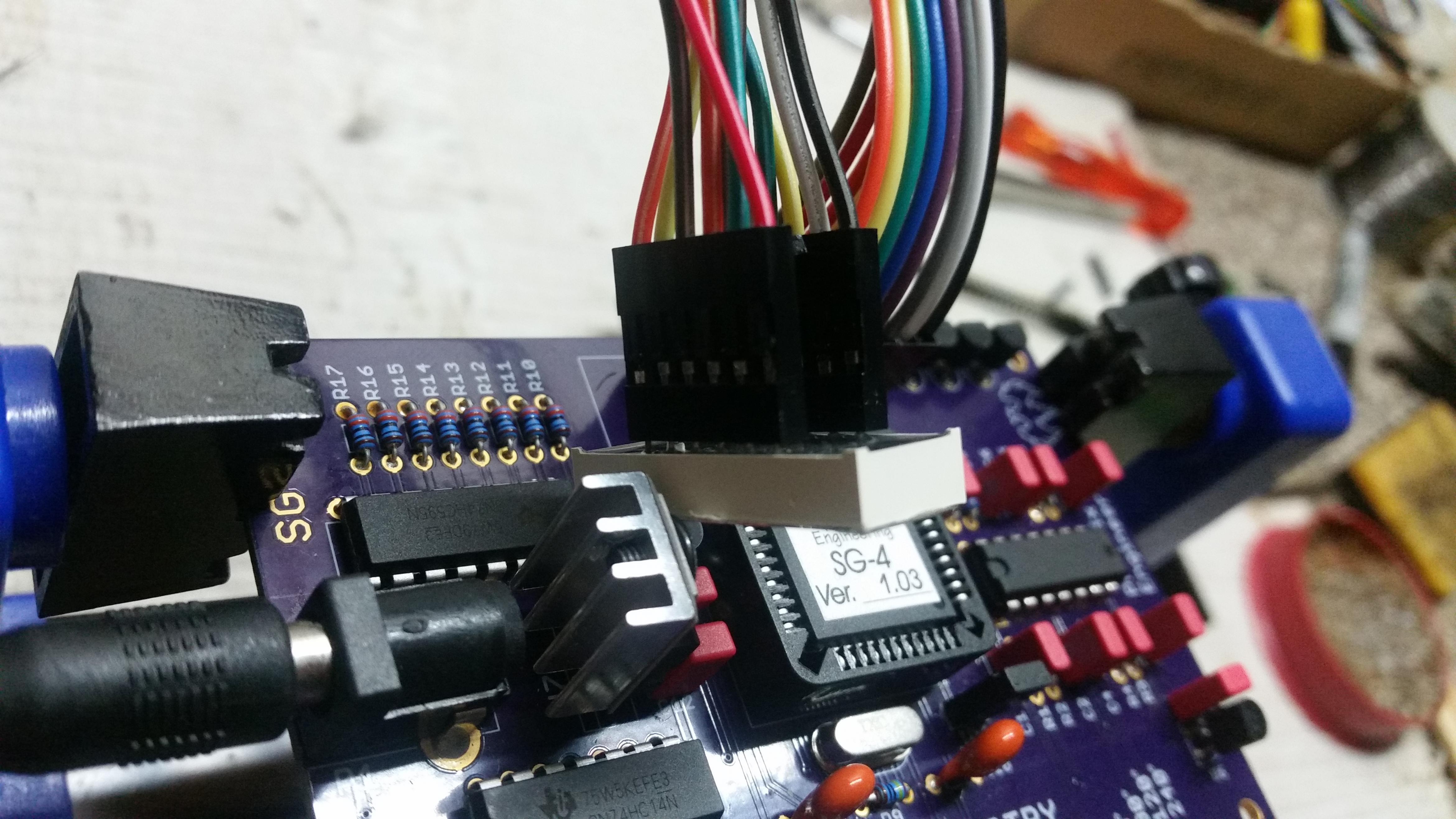

The display I used is an unbranded China made 0.56" 4bit Red common cathode which I can easily find locally for 2 bucks. For now, as long as it works, I'm happy about it. I can always replace to some better make later on for the aluminum chassis. (which I still trying to figure the best front panel layout). I'm finding 0.56" a bit too large. I may go for 0.36". The suggested 0.28" is too small for my liking.
Here are details of wiring up alternative 4bit 7 segment Common Cathode LED display commonly found on Ebay or Aliexpress vendors.
Check the display applying forward bias to Pin 1 & 12 to light up at 1st digit Segment E for pin compatibility as per details shared here.
I matched up my display to SG4 following these pin designations.
Next picture show the use of Arduino hookup wires (not seperated), slightly customed with all in a row arrangement sleeve, marked so that its easily plugged on both sides anytime without mistake. I reckon this is the most practical solution for me at this time. Its possible I could do better with some ribbon connector and IDE type connectors but I couldn't find the right type here in my place. These Arduino wires are a little stiff but they're functioning well and won't break.

I´m using a similar buck converter as yours, so to keep it safe I was considering adjusting the output to a lower value, like 10V or a bit more, but if the SG4 won´t fry at 13-14V, then it´s better to leave it at 12V.
Also found another option:
MP2307 DC-DC Switching Buck Step-Down Module - ElectroDragon
The maximum input is rated at 23V but may work at 24V and is a lot smaller board if someone needs to assemble it into a small case.
Also, an IMPORTANT ADVICE here: take care when checking the heatsink of the TDA, one of the screws here was loosen and I decided to remove both to see if the thermal compound was ok. I was very gentle but ended up with the whole amp IC pulled off from the PCB, ruining the amp... 😱
Already ordered two of these amps boards, they are cheap but it´s kind of a lotery to buy one that works 100% as it should.
While searching for an alternative to the TDA7492, I considered the TK2050, the board looks better/slim, has a LED that confirms it´s working, the size is exactly the same as the SG4 pcb, making it easy to stack both PCBs on a small case AND it would work on 12V just as the SG4.
JINSHENGDA TK2050 Dual Channel Class T HIFI Stereo Audio Digital Amplifier Board 50W+50W-in Amplifier from Consumer Electronics on Aliexpress.com | Alibaba Group
But then one of the feedbacks showed the same disaster that ocurred to me!
Sometimes they just use a strong glue to attach the heatsink over the IC and don´t fasten the screws properly or simply don´t use any screw at all to secure it over the IC and the PCB.
When I recently recieved 2 amplifier modules, the first thing I checked was the heat sinking and replace the heat sink compound. Also to check if there is anything unusual. I will also check everything else for bad soldering or unusual again, thereon powering it up without signal or load, take measurement for dc offset at the output. Lastly I wont use any glue to adhere the heat sink. Properly tighten the screws will be good to go. Better be safe than sorry. About the buck converter, there is 2 models easily availble to buy locally and so far they're good. I compared mine to bad specimens reported on forums.
What is availble to me here is the 3amp low and higher voltage modules. The lower voltage model works fine for SG4. No issues by accurately adjusting from 9vdc to 12vdc. I'm set on 12vdc for SG4.
