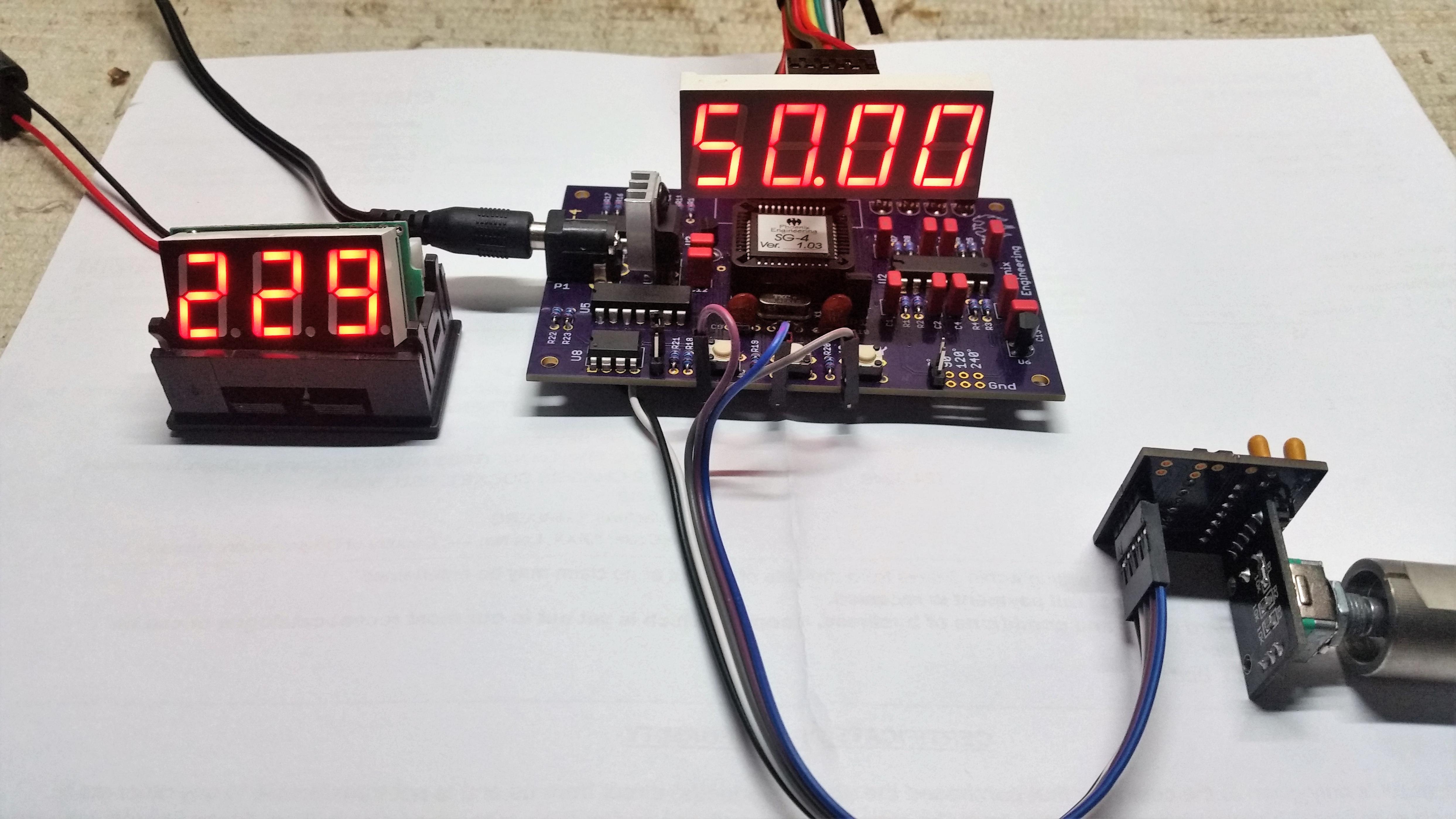

At last, I may have found the right product to implement for my SG-4 controller project.
I've changed SG-4 LED display to 0.56" size and found a same sized AC Voltmeter display that will be connected to the output to the motor. Now I can have both on the front panel in the near future. I found this while shopping for electronic parts locally. Glad I saw it for real and don't have to guess from online vendors. I seem to like what I see. Now I've to think how best to locate it on the aluminum front panel. I will have the panel machined out to fit for a professional finish as done on my Arduino tachometer.
RPM Tach? Do tell!!!!
