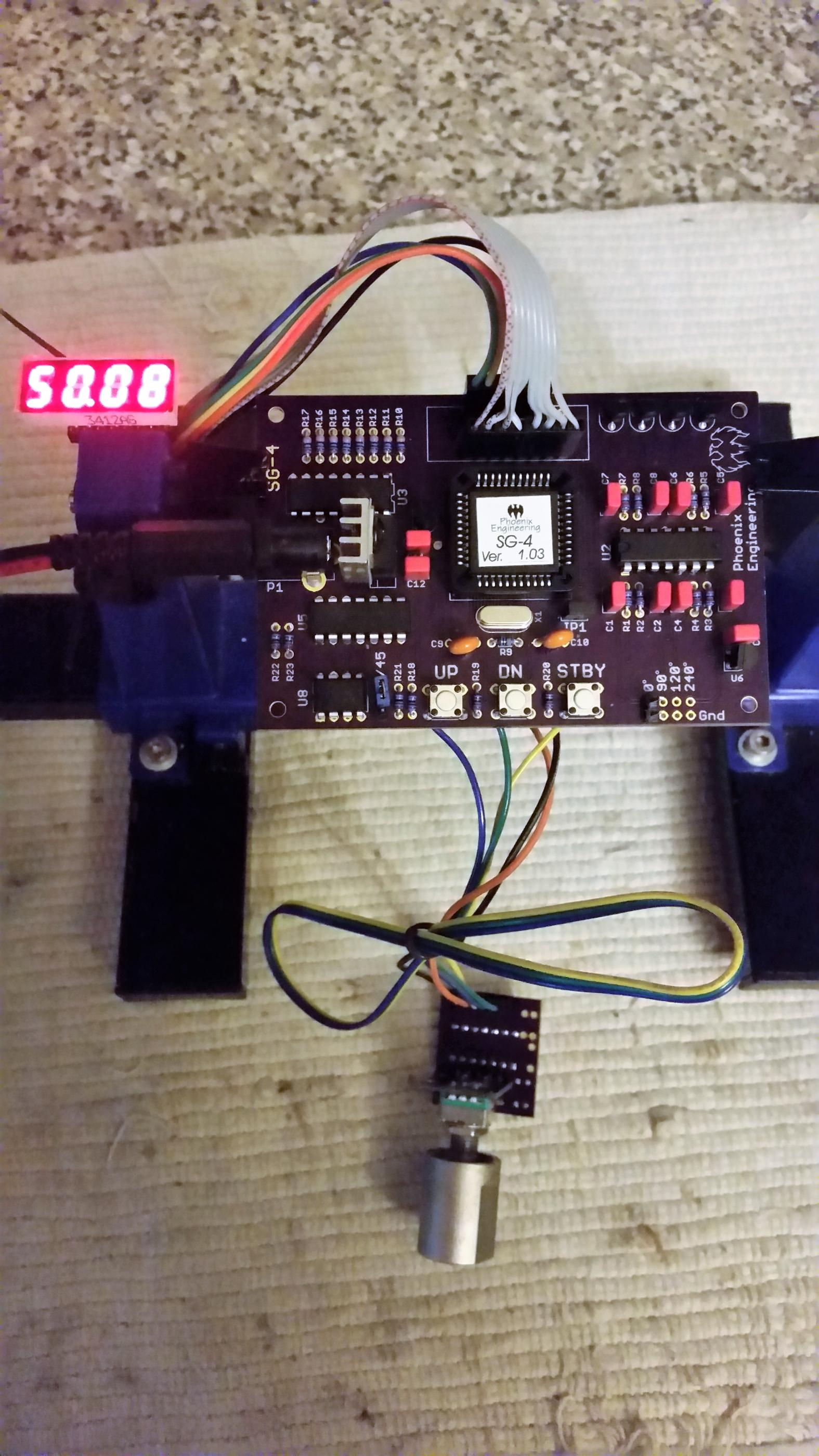

It looks like digit 2 is partially lit (a lower case "t" is barely visible). The other digits appear correctly, so the 7 segment driver (U3 and R10-R17) are all OK. The display is common cathode and Q2 controls when the second digit is displayed (pin 14 of the display is grounded to enable digit 2). If you temporarily short drain to source on Q2 (or short pin 14 of the display to ground), the second digit will be enabled always and you will see an "8" (the second digit will display "S", "t", "b" & "Y" so all of the segments will be lit). If this happens, then the display is OK and the connection from Q2 to pin14 should be OK.
If you have a scope, look at the gate of Q2; you should see a square wave with a period of 20mS and a positive duty cycle of 25% (digit 2 is on 25% of the time). If you don't have a scope, a DC voltmeter should show ~1.25VDC on Q2 gate. Q2 gate is feed directly from pin 24 of the microprocessor. Check that there are no shorts to ground or open circuits from U1 pin 24-->Q2 gate; from Q2 drain-->display pin 14.
The output op-amp has an 8V regulator for a supply; with 7VDC input, you will only get 5-5.5VDC output to U2 opamp and the output signal may be distorted. You should use 12VDC to power the SG4.

I have successfully finished the encoder board on a test PCB. It is working fine although there is one small issue: When i rotate the encoder clockwise the frequency decreases while turning the knob counter-clockwise the frequency increases.
I have checked the schematics countless times and can't find any mistake. Probably it is something simple i do not see?
Also, turning the encoder fast it can't simulate a long press from the momentary switches. Probably it is only for a fine tune of the frequency?

Either swap the input wires coming from the encoder switch, or the output wires going to the SG4.
Thanks.
The only button that has a long press function is Stby, and that should be connected to the momentary push switch of the encoder.
You will still need to access the plus/minus buttons on the SG4 in order to enter reduced voltage mode (minus button pressed while exiting standby) or phase adjust mode (plus button pressed while exiting standby).

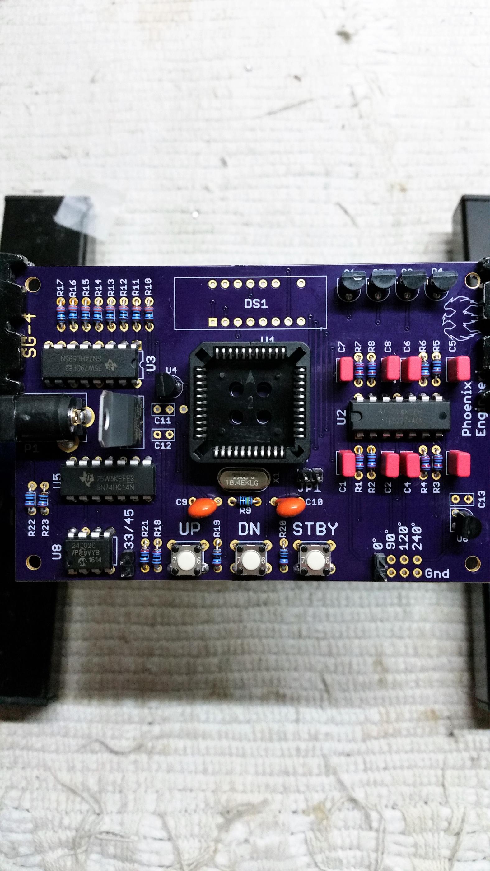

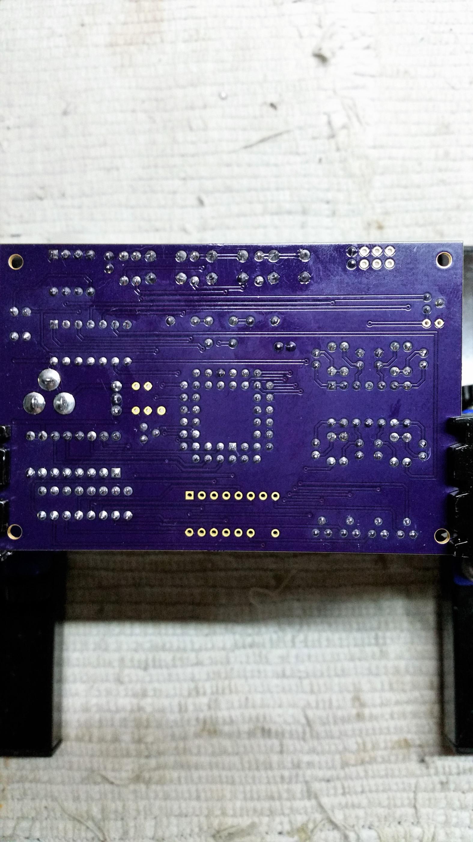

A load of parts arrived today and have started the build. Populated most of the stuff except a few caps which I missed out in the BOM. Later on I'll have to figure the wiring to adapt to another make of 7 segment display as its not pin compatible.
