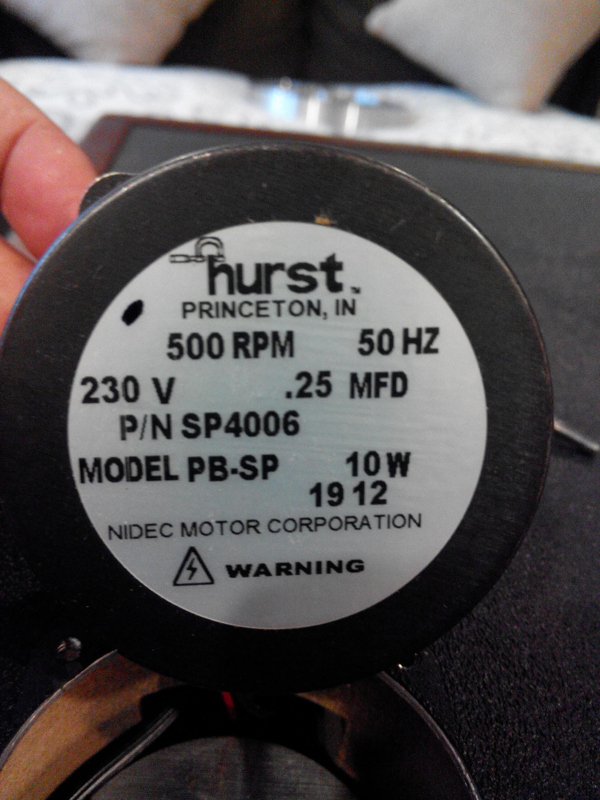

Hello all, About the VPI motor. I reckon you guys are with a 110V VPI Hurst motor. I'm not sure how its wired up inside the deck or pod, but I've recently come across an issue with Asia Pacific 230V/50hz specific motor. There's a 3Kohm/10W resistor wired in series to the Live to the motor. While its good with direct to wall power, it pose an issue with speed controller (Nigel Speed controller with 80VA step up to 230V, TDA7293 bridged amplifier). What is happening is with the resistor there, which possibly form a current limiter and to slightly reduce the incoming by 10-20V less and less vibration, the speed controller will not start at 45rpm at all. The pulley is seen juddering and stationary. It would start up normally at 33rpm but not at 45rpm select. Removing the 3kohm resistor solved the problem. Hurst datasheet points to direct wiring without any resistance in series for all motors, but VPI put one there. The phase shift capacitor is also different value from the datasheet. I've seen mine with 2ea 0.22uf in series = 0.1uf, another Classic 1 tt with same motor but 0.22uf instead. I reckon I'll have to remove the resistor when my SG4 controller is ready sometime in the near future. Just for info.
Thanks for the heads up! Are you sure the motor is designated for 230VAC from Hurst, or is it a 115V motor and the 3K resistor allows it to be used at 230VAC?

Hi Bill,
I don't see issue or blame any suitable speed controller but I was surprised the VPI with this motor and resistor posed a problem at 45rpm startup.
Here's the picture of the motor. This motor is with an old part number. Current/equivalent according to official Hurst data is 3203-007.
No mistake about 3Kohm resistor wired with this.
It's not surprising the motor would have trouble starting at 45 RPM (67.5Hz). At 10W, the equivalent motor load is ~5290Ω, so 3K in series would lower the voltage quite a bit. At 45 RPM, the voltage should actually be higher than 230VAC to develop the same torque as 33 RPM (50Hz). Even without the resistor, the motor will not develop rated torque at 45 RPM unless you raise the voltage above 230VAC, due to the increased back EMF generated by the motor at the higher speed.
Which VPI table is the motor used with? I wonder if the resistor was an attempt to lower motor vibrations?
Thanks for enlightening me on the matter. So far, I've only seen this motor used on the Asia Pacific VPI Classic 1 (ver 1 & 2). The final version of Classic 1 before it was discontinued (exported here too) is with motor at the rear left corner having an entirely different motor, Hurst 24V/60hz/600rpm/5W/Series AB. Fixed inside the deck is VPI designed 24V fixed speed controller to match the motor.
