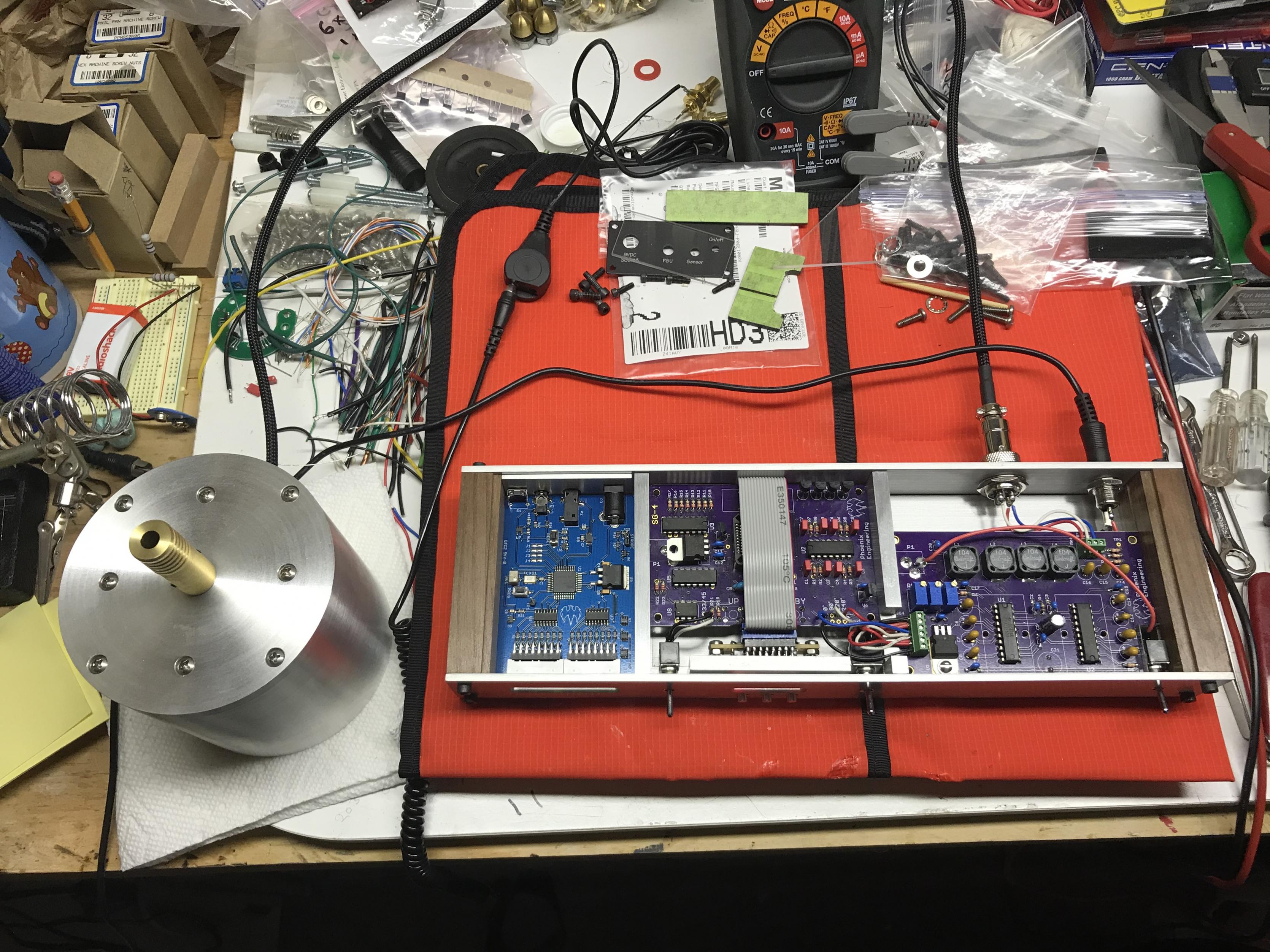

Hi Bill
Thank you for this very well thought out and supported project. I was able to properly finish balancing the channels of my MA3D with your guidance in the other thread.
My new drive system is pretty much finished except for some details with its case and getting a few things on my table sorted so I can set it up with the new system.
One question I had was about ventilation for the boards in the case I’ve built. As you can see in the picture I’ve attached, I have integrated my Roadrunner into the same case as the SG4 and MA3D. There was no ventilation in the original case of the Roadrunner to speak of. I designed my case to be compact enough to slide in under my turntable and since it is tightly packed with the SG4 and MA3D I am wondering if I need to ventilate the case for one or more of the boards?
Also, is it normal to get a slight “flutter” from the motor as it initializes rotation? I have noticed this when I was testing for rotation direction with some tape on my pulley as I switched between reversing the polarity of the 120 and 240 phases with the dpdt switch I integrated for this purpose.
I appear to have been able to make myself a pulley that is concentric to about .0003-.0005 as read on my dial indicator during testing on the motor. Not sure if any of that is in the bearings on the motor or if it’s all in the pulley. I was struggling a bit turning it on my old Logan lathe. It may not be good enough for rim drive.

If the "flutter" is only at start up, it may be from the voltage ramping up from zero. This is done in the SG4 primarily for the applications where an amp is driving one or more step up transformers; if the output is started at full voltage, the xfmrs present a very low impedance for the first second or so. By ramping the voltage, it prevents the output amps from shutting down due to overload.
Once the motor is up to speed, it should run nearly silent.
The SG4 will generate very little heat (about the same as the Eagle controller); the MA3D should also run fairly cool, so I don't think you will need any additional ventilation.
Great looking case by the way, both the motor pod and the controller.
BTW, you can power the RR tach from the same 15VDC supplying the MA3D and the SG4.

Thanks very much. The fabrication always presents it’s own set of problems. I enjoy building things. I’m running the Roadrunner off the 12V output of the MA3D with the SG4. I had asked about that previously... thanks for that guidance as well. I hid it’s power supply wiring under the boards and soldered it to the the bottom of the RR board. The RR power jack is closed off on the back of the case.
I’m brainstorming about a way to build a separate chassis that would contain step up transformers so I could just connect it to this unit and drive some of the other tables I have that would require the step ups, particularly an old Rek O Kut idler I have.
I wouldn't use these amps to drive step up transformers for a number of reasons:
1. They are only rated to 10W/channel and would likely be unable to drive the low impedance at start up, even with the voltage ramp up. They are also too small to drive the motor.
2. The outputs have 7.5VDC on them, you cannot connect them to a xfmr without coupling caps. On the AA motor, all 3 windings see the same 7.5VDC so there is no offset and no DC current flows.
3. The ROK motor is most likely expecting 60Hz drive signals for 33 RPM. The AA motors are running at 20Hz. You would have to reset the freqs for both 33 and 45 when switching between them.

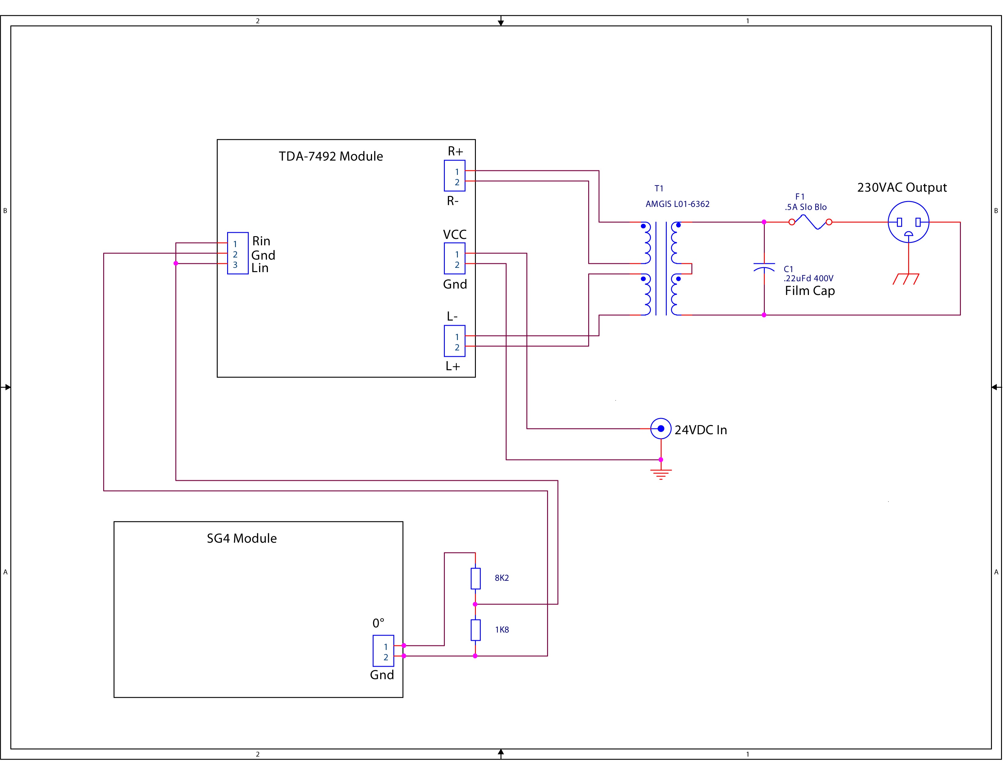

Please, I´m about to use the SG4 with a Lenco L75, but noticed that it already has a capacitor installed at the power switch under the chassis.
So, do I keep the original configuration for a monophase motor with the .22 uF capacitor at the transformer output or remove one of the capacitors from the circuit?
The capacitor on the Lenco switch is for arc suppression. You should install the .22uFd cap across the transformer output as shown in the schematic. It is needed for filtering as well as high frequency stability.
Leave the Lenco power switch in the on position and start/stop the platter with the SG4 standby function. If you want to retain the removal of the idler from the motor to prevent flat spots, then jumper over the switch so that it is always "on" and engage/disengage the idler when done listening.
