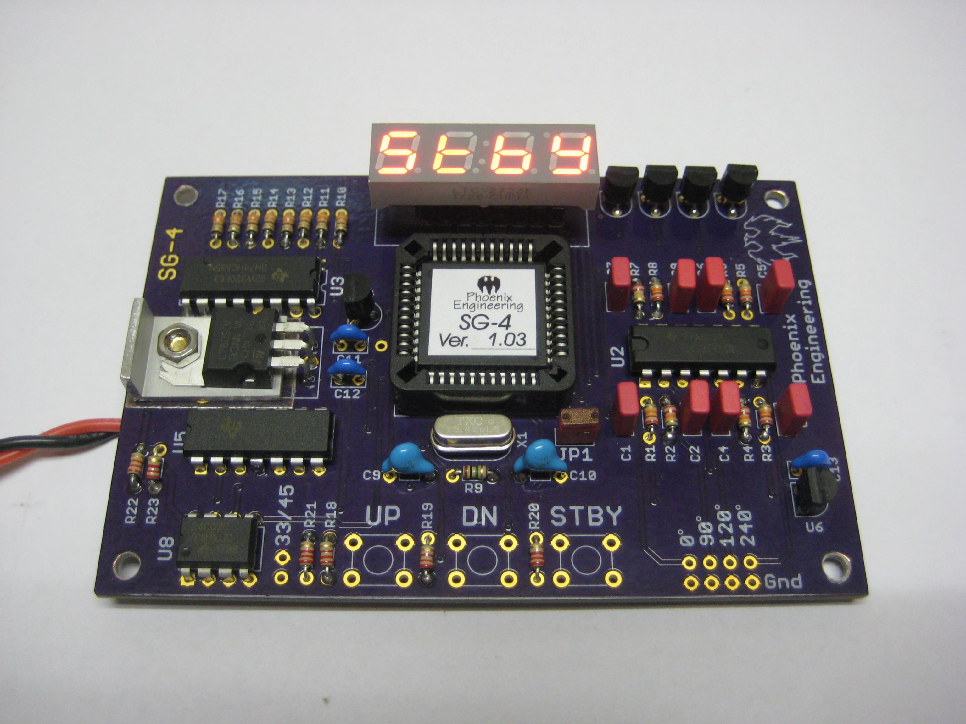

Thanks very much, Bill. This is just what I need. I built my first SG4 controller but the faceplate is a bit dicey looking. I'm going to order one from Front Panel Express and these dimensions will be helpful.
I did download a Gerber file viewer but still haven't been able to find how to extract the physical dimensions. I'm sure it's in there and will give me a learning exercise - even better since I now know the answers.
Thank you very much for all your efforts!
One thing to note on the drawing re: DS1. The coordinates are for the center of the DIP16 socket. The display is symmetrical top to bottom, but not left/right wrt the 16 pins.
The center of the display is actually at 1.875, which is also the center line of the PCB.

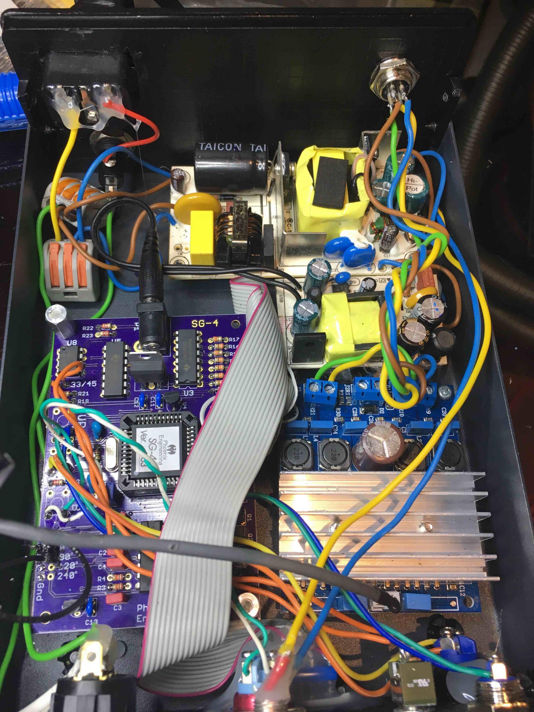

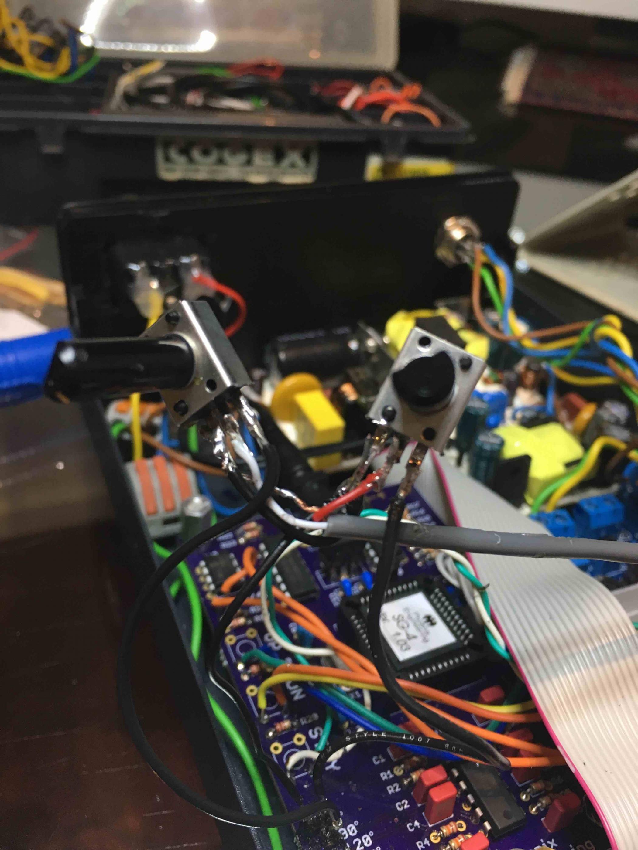

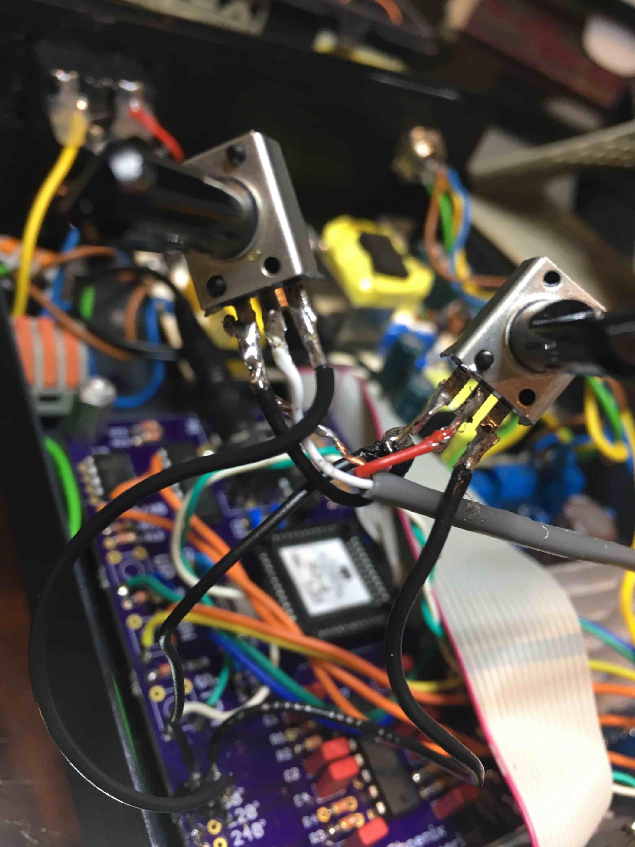

Hi Bill,
It’s 2 AM and I am still trying to setup my SG4. I’m really confused. I am sure it’s from my ignorance in electronics.😕
I have used two linear 20k pot I had on hand and installed them. At the 128 value, the amp outputs around 23.71v AC but when I reduce to 64 the output only drops to around 21.50V AC.
I wired the pot ( if you see it from top) to the left ground, middle to the amp inputs and left SG4 outputs 0 and 90.
What I’m doing wrong?
Hi Bill,

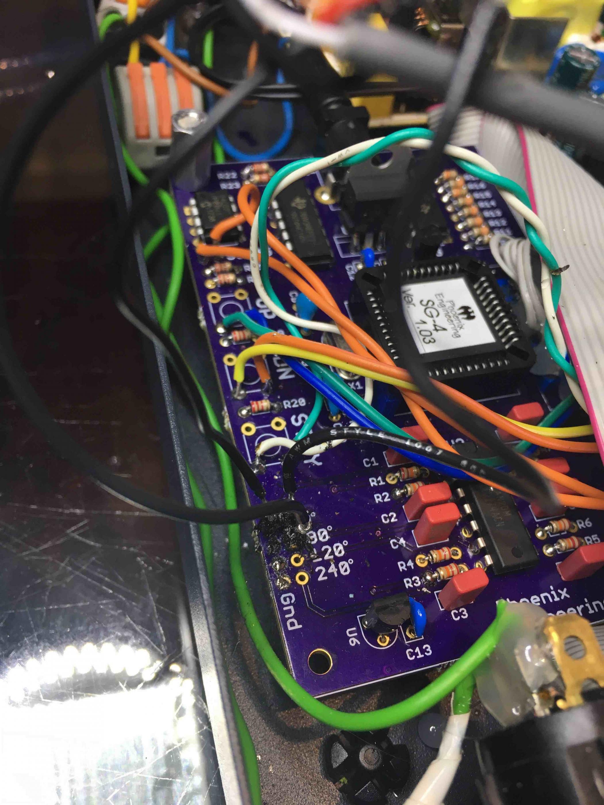

Hi Bill, thanks for your support....
The data:
DC to amp: 24,68v
DC to SG4: 12,23v
At 128 setting and 50Hz frquency:
0º VDC 2,533v and VAC 1,793v
90º VDC 2,534v and VAC 1,793v
Amp output 23,71v AC both channels
SG4 output frequency: 50HZ at 0º and at 90º
At 64 setting and 50Hz frequency:
0º VDC 2,533v and VAC 0,8898v
90º VDC 2,534v and VAC 0,8906v
Amp output 22,41v AC left channel and 22,389 right channel.
The frequency at 67,5Hz is 67,5Hz at both settings.
Attached are four photos, please pardon the bird nest but I'm in testing mode...I beg your pardon. Also in the photo that shows the outputs from the SG4 look dark or burnt, it is not the PCB, they are pins for testing and I will clean and tidy up with a proper cable and solder.
Regards and thanks again Bill.
Jorge
OK, a couple of things:
Are you running this direct to a 24VAC motor without xfmr? If so, they cannot share a common return; each winding will connect to each channel of the amp.
With a 24VDC supply, you cannot get 24VAC output, even in bridge (BTL) mode. The maximum undistorted AC waveform you can expect to see is ~17VAC. The output of the amp can only produce a 24VPP signal with a 24VDC supply. Because the amp is BTL, the effective voltage is doubled or 48VPP. The RMS voltage will be 48/2.828 or 16.97VAC. 24VAC is ~68VPP. To generate 24VAC in bridge mode will require an amp that can tolerate 35VDC supply.
If you are reading 24VAC at the output of the amp, the output is most likely squarewaves or severely distorted. This is probably why the output does not drop when the SG4 output drops in half (as it does from 1.793 to 0.89VAC); the waveform is still mostly distorted and you see a slight drop in RMS value at the output, but the amp is being severely overdriven.
If you adjust the pot between the SG4 and the amp for 17VAC at 128 setting, then the voltage should drop in half to 8.5VAC at 64.
