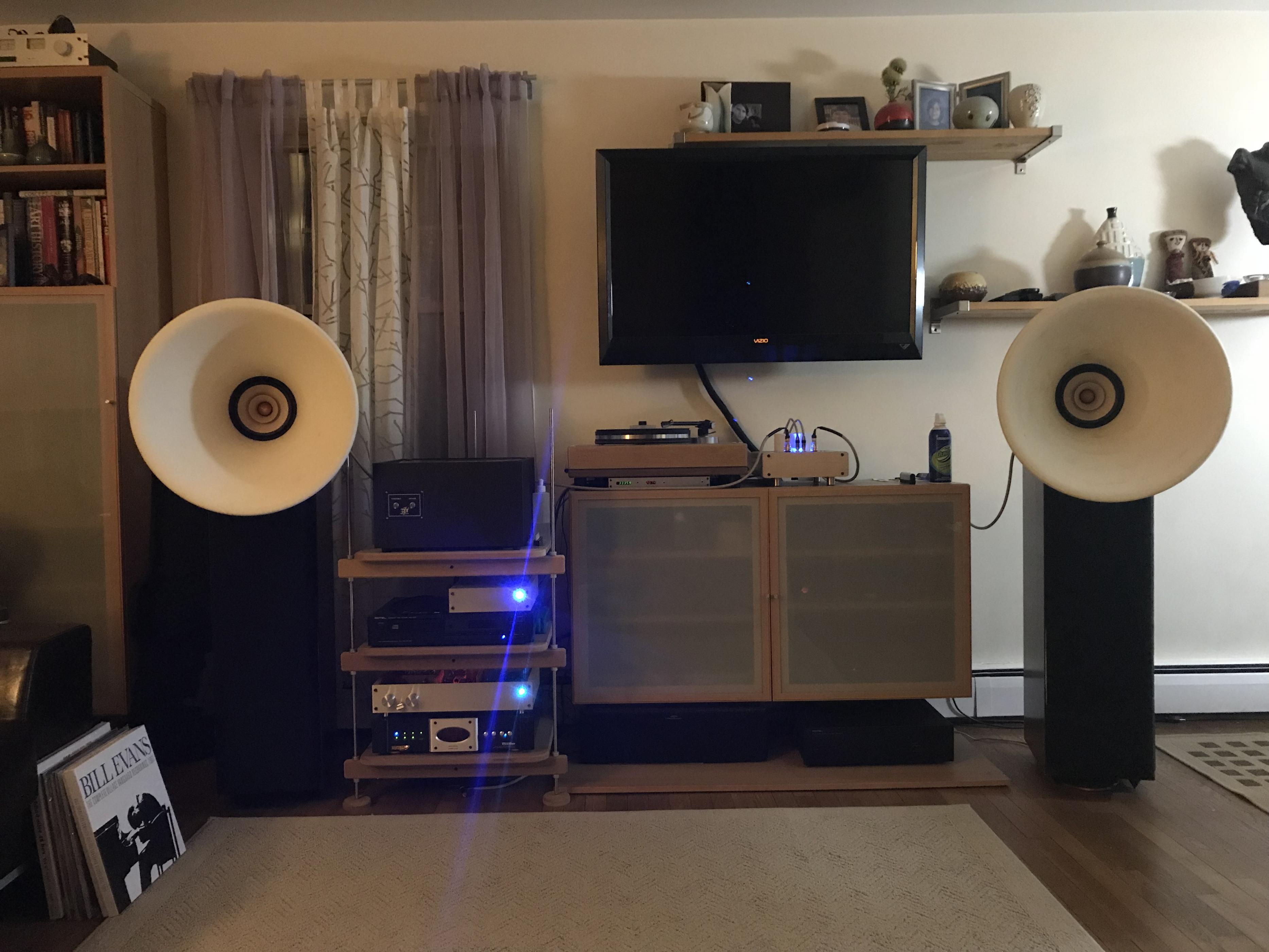

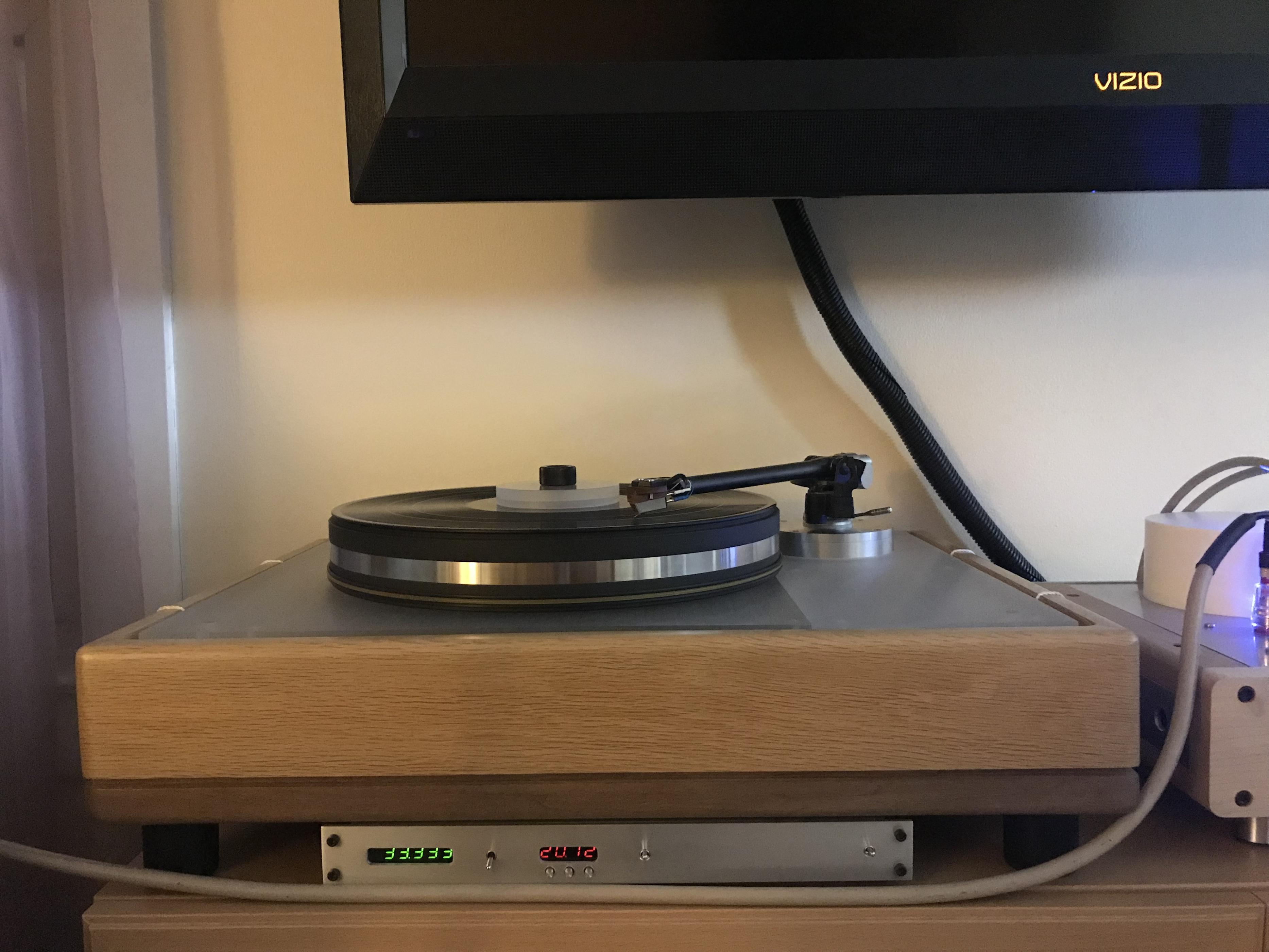

I just wanted to express my gratitude to Bill for everything he has done to offer this project to the DIYAudio community. Thank you for your continued support and guidance with this and all your projects. It would have been easy to retire and move on to other things. Instead, you are here giving even more to the community than you had with your excellent commercial products. My little experimental system is finally back up and singing like it never has before with the completely rebuilt front end. Thank you.
