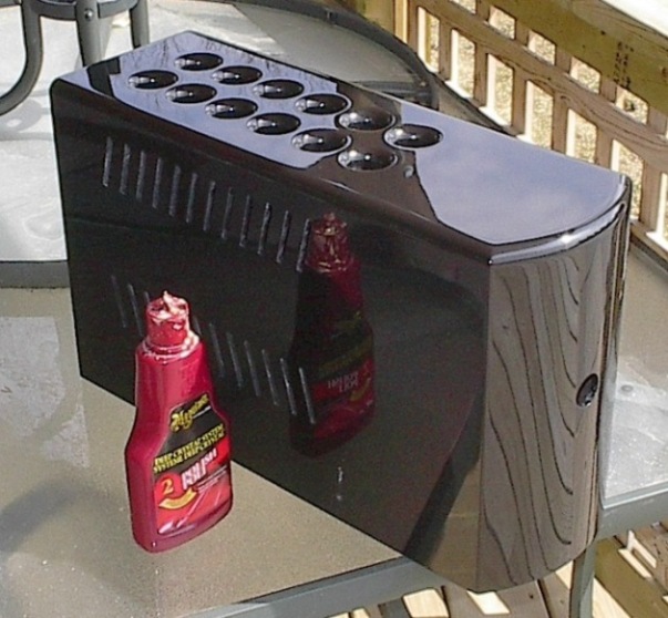

Interesting enclosure you show. Cardioid but are those ports I see?

That is not a speaker, but a sub amplifier enclosure. The "ports" are heatsink chimneys. Look it over here. About half done at this point.

Nice amp case BTW.
