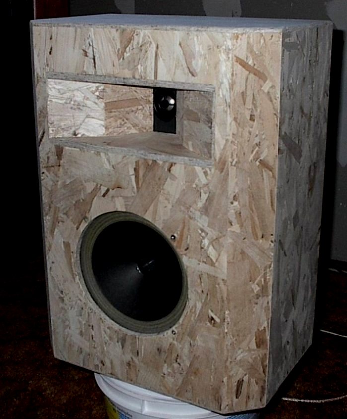

I agree with Ant... MDF works like a champ... as long as you pay attention to the details and understand its properties and limitations. Anyone ever used particle board for a cabinet...:devilr: :devilr: :dead:
I even built a prismatic pentagonal isobaric sub out of leftover 1/2" OSB 10 yrs. ago... still works great, but I'm gonna scavenge the drivers for the last two speakers in my (soon to be) 7.1 HT setup, seeing as I only have 20 drivers running as a 5.1 setup right now😉 😉
John L
What are the important details we all should be paying attention to? Can you do a brief summary of the properties and limitations of MDF?
OSB:
details
OSB:
What's really fun is cutting miters, dados, compound angles in OSB... eh?:bigeyes: 🙄
Funny you should ask. I' was trying to track down any significant details on plywood, MDF, Baltic Birch, etc. googling this afternoon, but came to the unfortunate conclusion that the technical details are difficult to pin down. I found all sorts of conflicting data re: strength in tension (MDF much lower than plywood parallel to the lams, about the same across laminations or even lower, due to joint failure). Strength in compression wasn't much different (kinda makes sense since they're both composits of wood and glue), but here again the data was highly variable depending on the source(s)... ah well, not like the aerospace flight tested data on metals and such which I'm all too familiar with...🙄
AFAIK, seems the material is much less important than the method re: bracing and construction. Ant uses the "heavy duty" approach and appently has exceptional results. What I've found using MDF is that as long as you pay attention to the joints by using both mechanical connections (dados, face fasteners, etc.) and high quality glue with adequate surface roughening and pre-treatment (re: pre-apply glue, allow to rest, then reapply b4 clamping) MDF seems as good as, or better than plywood I've used. It also doesn't suffer from blowouts/voids I've seen even in high quality stuff.
Plywood, OTOH, holds screws perpindicular to the plys much better than MDF, but not as good end on (I wouldn't recommend using end-on screwing for either, certainly needs pre-drilling at least as well as metal screw inserts). When I internally brace with MDF, I double the thickness b4 cutouts for larger spans to stiffen the flexural modes. I do the same with plywood (but I stopped using plywood after Hugo trashed the $$$$ market).
Finishing is different for sure, but I haven't had any real problems with either material, just needs differnt treatments (stain vs. paint, that sort of thing)
IMHO, the damping with MDF can be superior to plywood due to incresed density and higher acoustic losses at some frequencies. Of course, ymmv. These are just my experiences/preferences after building speakers for over 40 years.
