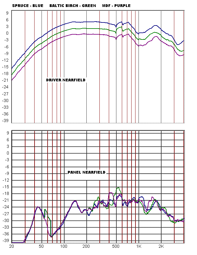

dlr said:
"MDF just seems to suck the life out of a speaker." There would indeed have to be some significant issues for this to be the case. "suck the life out" must without question be measurable as to where it's sucking it out, whatever that means in the real world. I'd just like to see some objective support for the obviously subjective statements.
The measurements linked earlier that showed actual tests, to my eyes, directly refute any significant differences in the resonant nature of panels with the same dimensions.
My own crude tests show this also. The cone output from each box was nearly identical, as was the side panel output.
I think if there was an audible difference, the mic would have easily picked it up.
A tuning folk will resonate when excited by a tone the same as it's tuning frequency. A different tone will not do this. Like the wine glass doesn't suffer from destructive oscillation when there is loud music playing.
I just did a little experiment. I have a pair of speakers built in Dave's method - very well braced, undamped panels made completely from Baltic birch plywood. I connected a function generator to it. I used a jerry-rigged accelerometer (4"midrange diver) and connected this to my scope.
Strongest output from the box was around the tuning frequency of the box ( It's a small TL, but given the driver used it would be around 80Hz.)
There was another visible resonance at around 1300Hz, but it was 1/10th the amplitude of the lower one.
Once again, these are crude experiments. I lack an accelerometer, so I improvised.
Results: higher resonance was not excited by the lower frequency input to the box. The only thing that excited this resonance was the direct input of that single tone, and still it was very minor.
Not audible to me either (and yes, I had my hearing aid in).

MJL21193 said:
Make that tuning fork resonate with a tone different from it's tuning frequency.
When you mechanically strike something, the energy imparted is not at a single frequency.
Yes, I see now. Good point. A whack is would be broadband stimulus.
If you don't think that is true try this experiment:
The speaker will be driven by the frequency generator at the frequency of the tuning fork. After the speaker has been on for a few seconds, it will be turned off, and the tuning fork will be 'humming' at this pitch. This is because the natural, or resonant frequency, was matched, and drove the fork to oscillation. The louder the speaker is driven, the greater an amplitude the tuning fork will have. A similar demo can be shown using two tuning forks of the same frequency. After one is struck and left to oscillate, next to the other one, it should be stopped. The other will be left again, oscillating at their natural frequency.
dave
