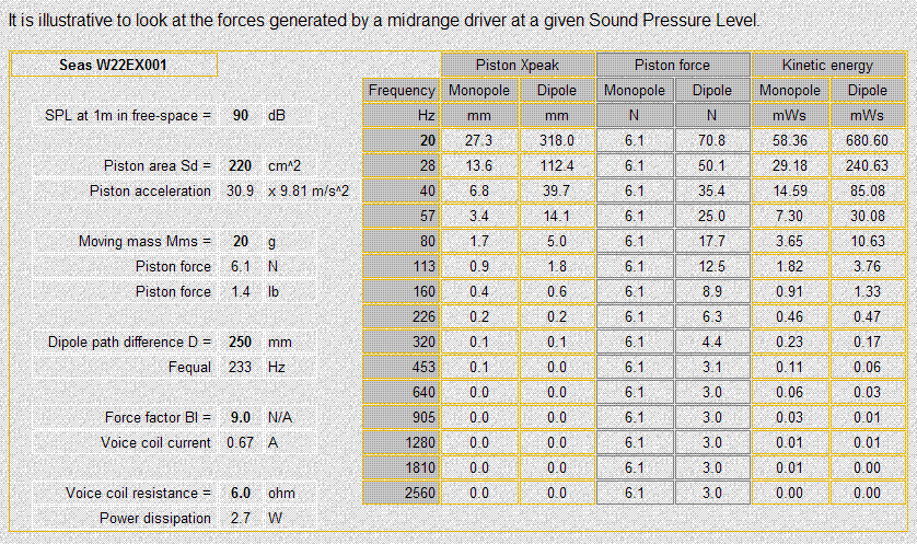

Here's the way I see it: With the drivers mechanical motion you have inertia. The lower frequencies need a longer excursion of the cone to produce the same spl as a higher frequency at a lower excursion. The further the cone travels, the more opposing force,
Unfortunately this statement is not true. F = ma , acceleration not displacement. The force between the voice coil and the frame is constant with frequency. The kinentic energy of the cone decreases with frequency above resonance.
I find it interesting that you would disagree.
Here's a screen shot from Linkwitz' site.
It clearly illustrates what I'm saying.
John,
I think it only illustrates that you didn't quite understand Linkwitz's table.
Note that piston force remains constant, regardless of frequency. Where it changes is in dipole column, but that is only a consequence of equalization (more power dumped into the speaker to make up for the 6dB/oct dipole cancellation). More power = more acceleration = more force.
F = ma, since Sir Isaac.

Bratislav said:
John,
I did take the effort of posting the link to his site where you could read the following:
"A cone type electro-dynamic driver is primarily a generator of mechanical vibration force and heat. It sets air into motion, but the reactive force of the air has insignificant influence on its behavior. For acoustic and mechanical reasons a driver is always mounted to a baffle of some form. Thus the forces generated in the driver try to set the baffle into motion. The resulting whole body movement is usually a small fraction of the cone movement and governed by the relative masses of cone and baffle. Mms vcone = Mbaffle vbaffle. Since the cone velocity vcone decreases with increasing frequency for constant SPL, the whole body motion is usually only noticeable at low frequencies and causes an insignificant reduction in SPL."
This help?
This help?
No it doesn't.
Please point out where does it say that force increases with decreasing frequency ? All I can see in that table is "Piston force == 6.1N" regardless of frequency.
Stop mixing velocity with acceleration, and force with energy.

Bratislav said:
No it doesn't.
Why not take up your argument with the man himself. I didn't write that, Linkwitz did. Without going out on a limb here, it's safe to assume that he knows what he's talking about.
Shift your eyes one inch to the right on the chart and you will see another pair of columns, labeled "kinetic energy". Here you will find values that change.
I don't have to argue with Linkwitz, we do agree.
It is what you wrote that I have issues with. But let's leave it at that. I think Earl's approach to this discussions is much smarter.
Gedlee is certainly correct and as Bratislav said, you've misinterpreted the chart, but thanks for the link, it provides the supporting data. The chart shows forces generated at a given sound pressure. For a monopole, that force is constant. For a dipole, it must be equalized.
Note the displacement column, the piston Xpeak. At higher frequencies, 226Hz and up, they are equal. Then look at 20Hz. For a closed box it's 27.3mm, for a dipole it's 318mm. For a given frequency, the dipole must have a huge displacement to provide equal SPL, therefore the force applied must be increased at all lower frequencies.
Energy has nothing to do with it, although the equalized dipole driver will undergo far more force variation throughout a cycle, must move faster to reach the higher Xpeak and therefore will have higher energy when producing the same SPL, so the demand on its mechanical integrity is much higher than for the monopole, aside from displacement limitations. The instantaneous value of energy (1/2 *mV^2), when velocity is at its peak (at the zero crossing) will be much higher for the dipole, since it has to reach an Xpeak far greater than that of a monopole. But note that the energy equation has nothing to do with force.
