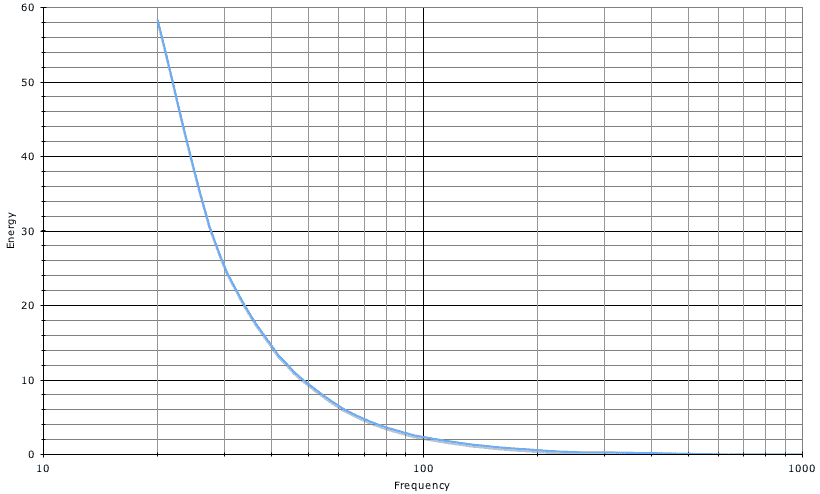

Re: Re: Re: Re: Re: No More Re's!!
Here is the table above turned into an energy/frequency chart
dave
MJL21193 said:It clearly illustrates what I'm saying.
dave
Re: Re: Re: Re: Re: Re: Re: Re: Re: Re: Re: No More Re's!!
No, that has nothing to do with the context of the discussion at that point, the energy column is meaningless with regard to the original context. The original context was that of the force applied as a function of frequency, there was nothing about resonance. An unequalized driver, regardless of its use in a monopole or a dipole, will be under constant force when unequalized. The energy column is useless in that regard.
If you want to diverge to some other aspect, fine, just address the topic in context.
Dave
You all seem to be misinterpreting what I'm talking about. I even gave a very graphic example (the bass driver that will make a box "walk"), in the original post. How can you suggest that there is the same amount of mechanical energy at all frequencies?
That is the point after all, the amount of mechanical energy from the driver, right?
Thanks Dave.
dlr said:
Gedlee is certainly correct and as Bratislav said, you've misinterpreted the chart,
Not that it matters, but Earl hasn't responded since then. His approach is to abandon the discussion when someone is not agreeing with him.
To reiterate, the point was "how much energy comes from the drivers mechanical as opposed to the acoustic." Simple, straightforward.
If I used "force" where I should have used "energy", I'm sorry for the confusion. I thought I was engaged in a discussion with fellows who understand the basic concept, and weren't here to nit-pick about terminology.
Bratislav said:
I think Earl's approach to this discussions is much smarter.
The same amount of force is supplied by the driver to the box for any given signal applied to the driver. The difference is related to the box. If it's solid and secure on the floor, there will be the maximum of acoustic output from the driver because the "mass" against which it pushes is essentially that of the box and whatever it is coupled to. If it's on a concrete slab floor solidly planted, then the mass is that of the slab and the earth underneath it. If the box is not secure and can slide or it flexes, then the driver output will be affected somewhat and the acoustic output will drop a bit depending on the movement of the box. In that case some energy is transferred into the box movement.
Give a box enough energy (from applied force) at any frequency and it can be moved. Have you ever seen something "dance" on a flat surface from vibrations beyond your hearing? I worked for Michelin in a tire production facility for many years. They converted a number of rubber cutting machines from hot press cutters to ultra-sonic cutters. They varied in frequency depending on the material to be cut. They moved imperceptibly, but they would cut through the bone if you stuck your finger in front of one.
Dave
