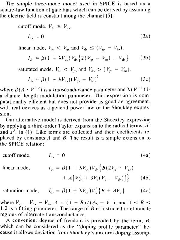

For people's information, I just tried the model of the BF862 that's being used in LTspice, and it does add a gentle curve, slope decreasing towards zero gate voltage, to the transconductance characteristic; a simple, minimal spec'd set of parameters for a JFET just traces a straight line, otherwise.
Frank
SPICE 3 includes a fitting parameter B from the Parker and Skellern model, but all the JFET's I see just use the same default value. I don't know if this is enough since I found several articles that needed to modify their model to fit distortion performance of real amplifiers. Time to get out the BF862 datasheet and experiment.
