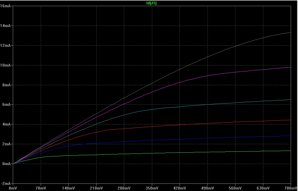

Curve looks pretty smooth to me, here's a zoom in of that area:This is looking better, but there also still seems to be a kink at the transition. The problem for me was simulating the null of seconds for a simple phase splitter. It always walks down to the kink, where a real device has a sweet spot with a very deep null.
The level 3 model has an ALPHASP parameter that fits the entire curve smoothly with a tanh function which has a continuous derivative.
What did you end up using for lambda and B, and did B start doing something?
You might ask why something as fundamental as lambda is so far off in the extracted model.
Currently I'm using a Lambda=6, B=0.37. B has always done something, but depending upon the other parameters it can be very subtle. These are easily massaged in various directions without major hiccups, alter the curvature in the transition area.
Biggest problem is that Ids vs. Vgs curve is now almost linear, which is probably the reason for the published model being such. As mentioned before, you can get around this by adding a Vgs dependent voltage source at the gate; may not be correct procedure, but if the model flies ...

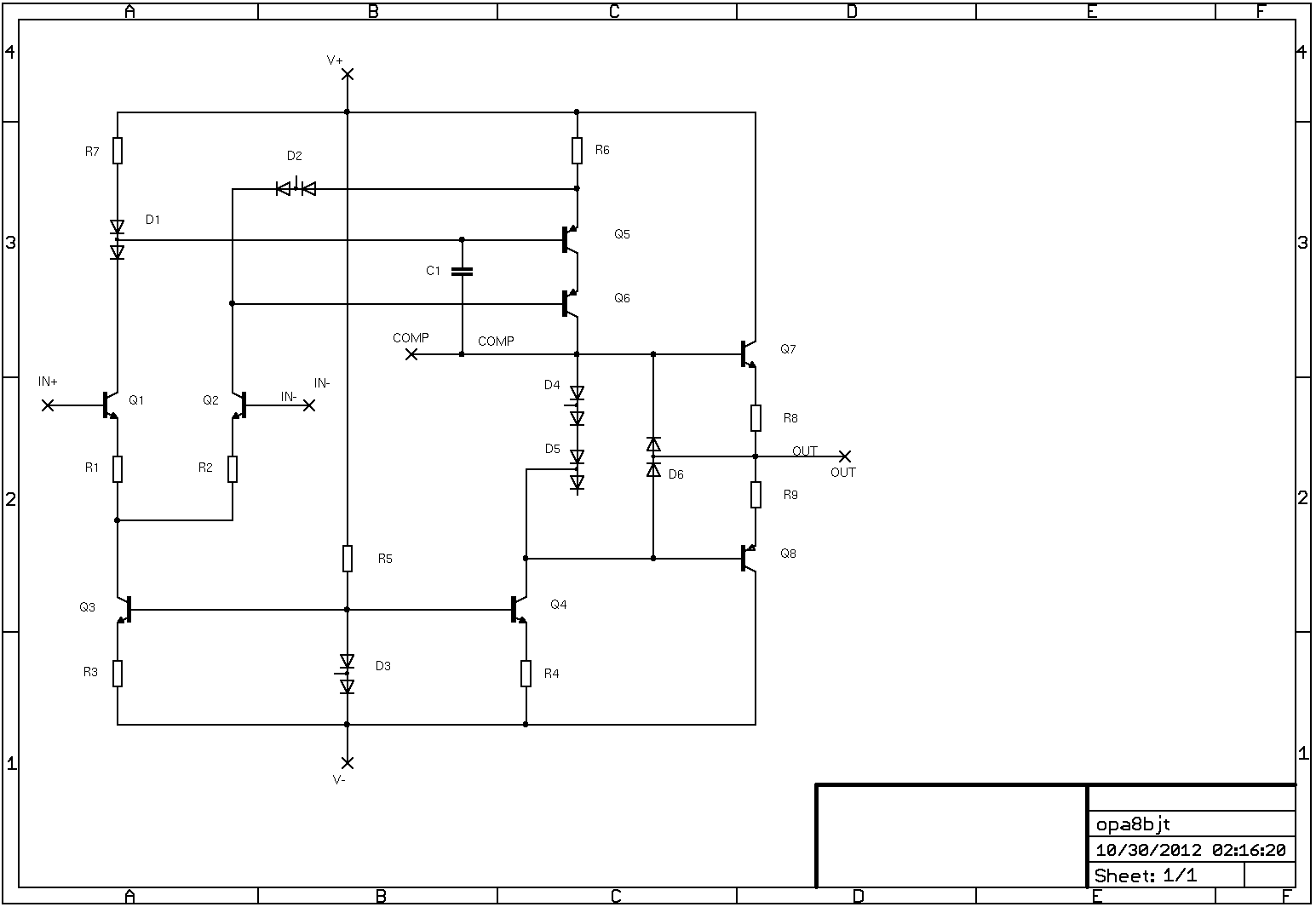

Nope, not yet. However, I'm doing a cut-down, 8-BJT single-ended version of SWOPA, for which I've completed the Eagle schematic as well as preliminary placement. I'm also planning an SMD version with 4x SOT363 duals later.

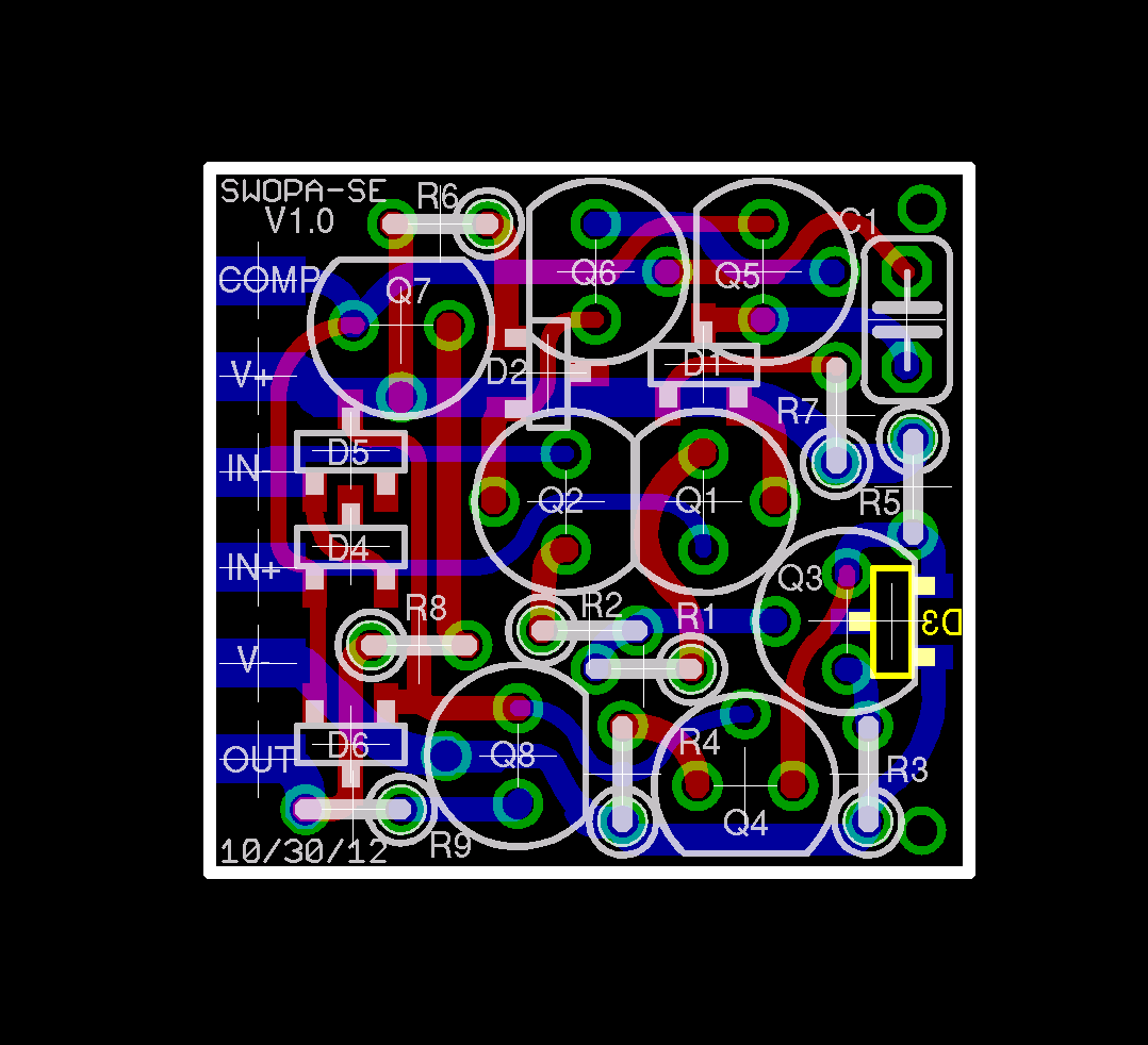

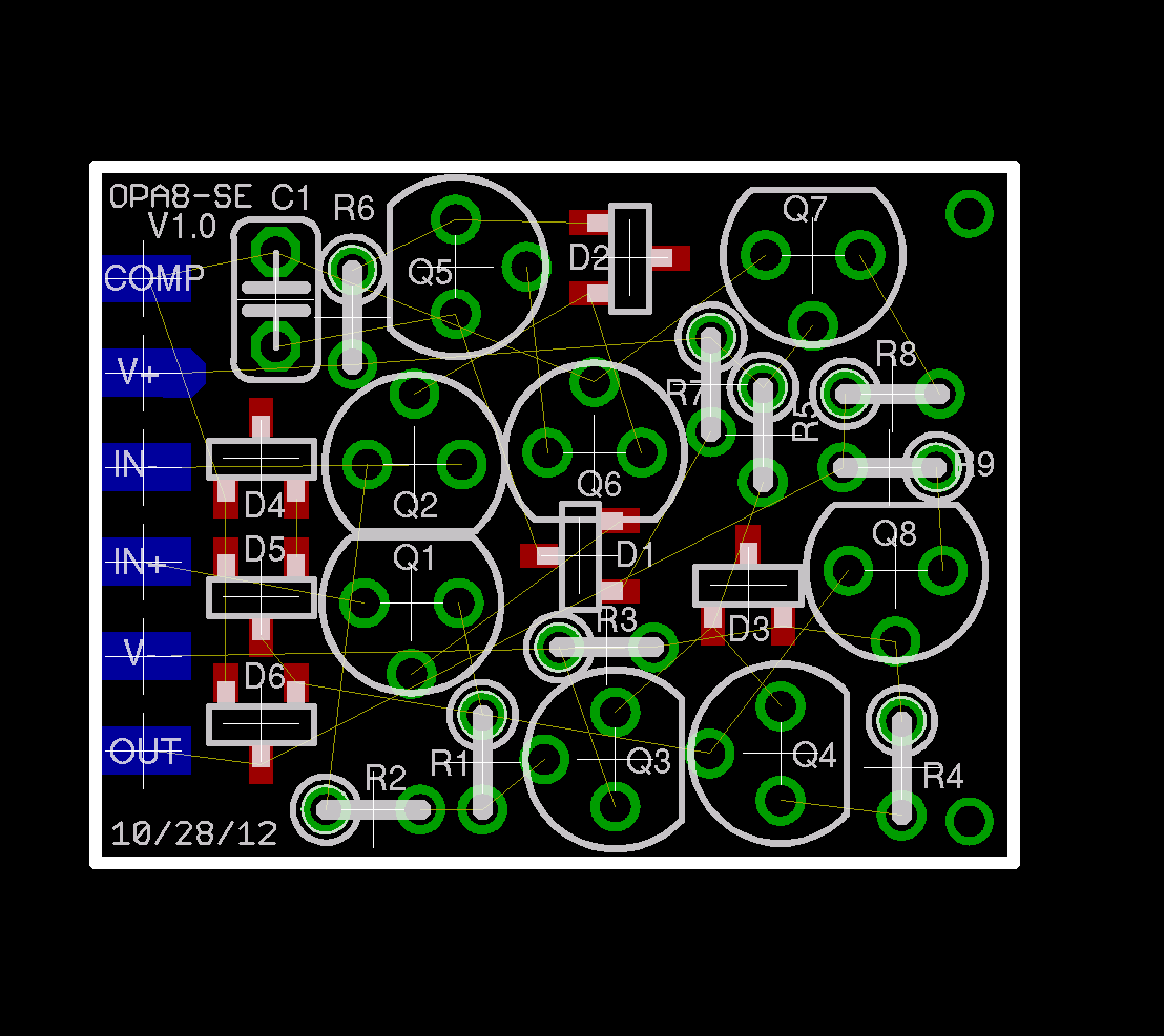

Here's the PCB layout of the 8-BJT single-ended SWOPA-SE, about 0.75"x0.85". It will use the same base PCB as my existing LF03 discrete opamp.
Edit: The BJTs can be any TO92 BCE-leadout pair like the 2sa1015/2sc1815 or similar. The dual diodes can be BAV99 or similar. Resistors are sane values, exact values TBD after prototyping in 4-8 weeks.

Right now that's what I have on hand 4401/4403's and will use that for a proof of concept i.e. the performance improvements of other devices is either higher-voltage related or some very subtle performance issues. If the pinouts are the same (or rotationally the same) there would be no problem proceeding. Matching also is not a work/not-work issue.
FYI, Diodes Inc. offers 4401/4403 in a SOT 363 dual configuration (NPN+NPN, PNP+PNP and NPN+PNP), the prefix for duals is MMDT and the complementary version is 4413. The same chip is also available in single SOT23 and, of course, TO92. All those parts seems to be globally available through standard channels.
