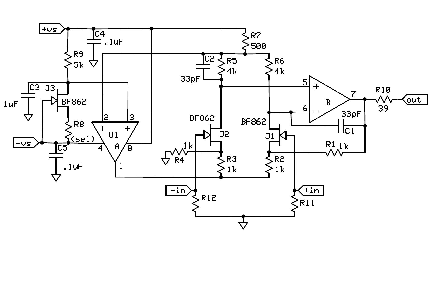

I maybe showing my amateurism here but has this application been looked into either the SWfetJE990 or the SWOPA when the positive input is grounded and the negative input is used as a summing amp applications with very little gain? I have a schematic of a PRINCETON APPLIED RESEARCH 113 preamp in which the input is jfet and there are two inputs and two outputs, balanced in and balanced out, obviously for test purposes, but the gain can be selected from a gain of 1, 10 or 100. Don't think I can post the EEG schematic. Thanks, Ray:D

This circuit captures the PAR113 functionality. Select R8 for 200uA in the bias FET, use any decent rail to rail input modern dual, and the gain is just changed by a resistor across R3 and R2.

Haven't tried that, there might be a common mode conflict. You could just invert the output to provide a minus half. The PAR 113 schematic on the web has the one side grounded on their differential input circuit. I have built this, it works quite well.
