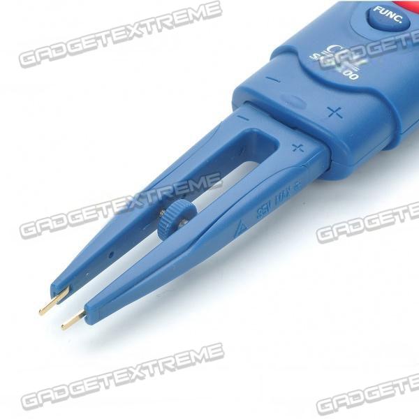

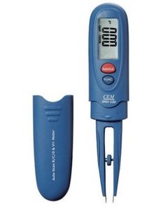

Not sure if this site is still current, but it is on the side of the box: LCR Meter Smart Tweezers - Digital RCL, Impedance and ESR Meter,SMD Component Tester/Multimetertweezer meters? you mean reverse tweezers that stay closed? if not, linky please?
It's an "L-C-R meter integrated with tweezers".

very cool indeed =) are the tweezers actually useable? I spent $170 on my current set of (passive) tweezers and though those look handy and the tips actually look pretty decent, I think I would struggle to justify 500 on a set of tweezers that arent very good at the primary purpose.

I only use them for testing components, and they work adequately. I have other tweezers for handling parts.
A somewhat less costly solution, RC only :
Wholesale New CEM SMD-100 Smart Electronic Components Tester, Free shipping, $38.29-47.01/Piece | DHgate
CEM SMD 100 Smart Electronic Components Tester | eBay

aha, as I thought, I think a decent scope and signal generator is first off the ranks, they do look good though and would certainly simplify testing and identification. I wonder if there are similar things that can be plugged in as scope probes? guess i'll have a google.
