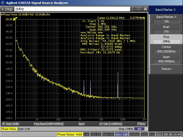

Probably not, my records show that Andrea didn't buy an AC kitset. Assuming that battery was a good DC supply (which it probably was), the AC kitset performance would probably be the same or very slightly worse. The differential oscillator and comparator rejects PSU noise well, and the two level regulation should cut out most PSU noise anyway.
All the components for the kitsets have now arrived.
when jitter was tested clock was powered with battery
can we see jitter level of AC pcb
This is the phase noise plot and jitter of the same oscillator AC powered.
Keep in mind that I use an LC filter after battery (10mH/15000 uF) because typically battery is noisier than AC regulated supply.
