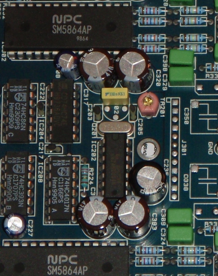

A quick question, is it ok if I use old crystal with the clock? It's 16.934Mhz, so should be fine I suppose?
tried to connect my old valab clock, but was unlucky yesterday... perhaps I did something wrong or maybe because of the 16.9344Mhz clock frequency. Does it correspond to T+A's 16.934Mhz or these are completely different frequences? Just to mention that I was trying to connect clock to 74hcu04 inverter.
