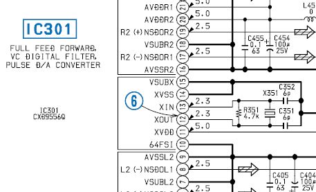

hi anton
thank you for the reply and thank you s3tup for the possibly very important point.😱
now i understand what the clock signal does but am just getting into dac and i/v operation - so please bear with me.
I have a sony xb 740 which seems close to xb 940 in the schematics/service manuals - i can provide these to you if you want. (940 has much more complicated audio path after dac out but otherwise are very much the same). the player has two chips one on the transport/drive and one on the processing board they both seem to use the crystal pictured in 1 & 2. I have just found a second crystal but this on the display driver board and does not have individual part number - i don't think this is important to audio.(pic 3)
i have attached snapshots of the dac and crystal listing in the manual - pic 1 &2 also pic 4 is camera shot of crystal in player.

I've had a look a the CDP-XB740, and it seems to use a fundamental mode 45.1584MHz crystal. It should be possible to take that crystal out of the player and install it into this clock, but I can't make any guarantees that it would work, I've not tested the clock at anything over 33.8688MHz. What test gear do you have? I wouldn't try this without an oscilloscope.

i have not got an oscilloscope at the moment and have not got the funds for a proper one but... i have found small handheld ones on ebay - link below - will these do the job or is it just hong kong/chinese nastiness. i can solder/desolder quite well but have never needed to test at a level more than a multimeter.
Is the problem it may not work at all or is there harmonics/unstable signal problems that i do not know about/jet understand ?

@glowing vinyl: If I were pushing the limits of the clock, I'd want to have an oscilloscope. If you plug in the used 45.1584MHz crystal and it works, then great, but if it doesn't you'll be completely lost without a 'scope.
The portable version you linked to won't be useful for this application, it's far too slow. You're going to be looking at a 45MHz signal, so you're going to need something with quite a bit more bandwidth than that. Ideally 200MHz, 100MHz minimum. For cheap, you'd probably be better off with a used analog 'scope, something like this one (though I only had a quick look, you'll need to do your due diligence before you buy).
