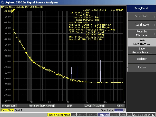

Phase noise measurement
The phase noise plot using a 11.2896 Citizen CSA.309 Crystal.
Thanks for the measurements Andrea, they're really interesting to see, and I have no hope of making them myself. I'm pretty happy, -108dBc/Hz @ 10Hz is a solid number, though the noise floor of -147dBc/Hz could be better. What do you think the three spurs are, reflections?

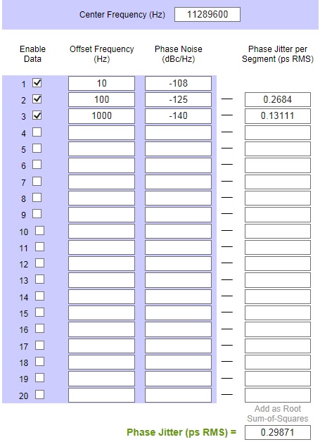

The measurement has been done in a university lab. It did take 5 minutes only to do the measurement, I believe in an hour or so the phase noise performance should be better, also the noise floor.
BTW, it's not a bad phase noise plot, it's at least 6dB better than the Crystek or Tentlabs XO.
About the spurs, I don't know. I measured the DC version powered by a LiFePo battery followed by an LC filter.

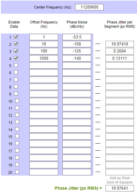

About the jitter, it depends on how many segments have been integrated. The measurement have been done very close to the carrier (1Hz), so the first segment is dominant. Tipically the manufacturers start the measurement at 10Hz from the carrier, so the RMS phase jitter seems much better.
Attached a simple phase noise to jitter conversion of this oscillator starting from 1 and 10Hz. As you can see the results are a bit different: around 20 ps starting from 1Hz, but less than 0.3 ps starting from 10Hz.
Andrea
@andrea_mori: Yeah, that makes sense. The 20ps number threw me off at first, 0.2ps seems a much more compatible number to other oscillators, I think 10Hz is the normal starting point. That's why I always prefer to look at a phase noise plot, jitter numbers can be easily distorted.
