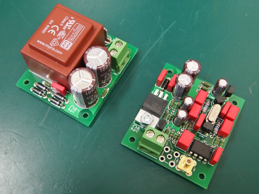

I've assembled the new revision of the LJC, and I've run a few tests. Everything looks good, though the core circuit and layout is the same, so that's hardly a surprise. I've got a few more test to run, and then it should be ready.
The main difference between this version and the last is that is is now two separate boards; the clock itself and an optional AC to DC power supply. The main reason I did this is that I found the previous AC powered version impractical. I needed the clock to be very close to where it was needed, but often that would've meant stringing a 240VAC cable right through the middle of the player. Now you can put the clock where it's needed, the power supply board over near the player's standard transformer and an innocuous DC cable across the player.
Another advantage is that it has made the clock smaller, 45x50mm (2250mm2) versus 32x75mm (2400mm2) for the old version. Not a big difference, but when you're adding new stuff every bit helps.
The other big change is that a 120VAC version of the power supply will now be available. There's still not enough room on the PCB to add a voltage selector, so the 120VAC and 240VAC versions will use different transformers.
Unfortunately I'm about to head off on holiday for a month, so there won't be any kits or PCBs until I'm back. I'll order some PCBs to arrive while I'm away though, so I should be able to hit the ground running when I return. Utah powder, here I come!
Here's a photo:

I've bought some parts, so more kits will soon be available. Pricing for the new design will be as follows:
- Bare LJC clock PCB: USD3.00
- Unassembled LJC clock kitset: USD25.00
- Unassembled LJP AC power supply kitset: USD15.00
A schematic and bill of materials for each PCB is included below. The part numbers are for element14, though parts should be available at any comprehensive electronics distributor. The LJC is the clock, and can be powered by 7 to 14VDC. The LJP is the optional AC to DC power supply. I can supply both 110 to 120VAC and 220 to 240VAC input versions. I'm not selling the PCBs for the LJP separately, as I only have a limited supply.
Postage will depend on the weight of your order, but will start at around USD11 for PCBs only.
