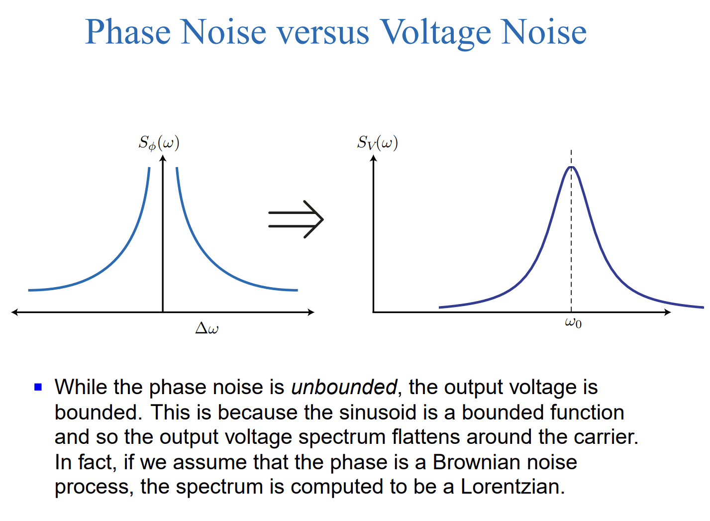

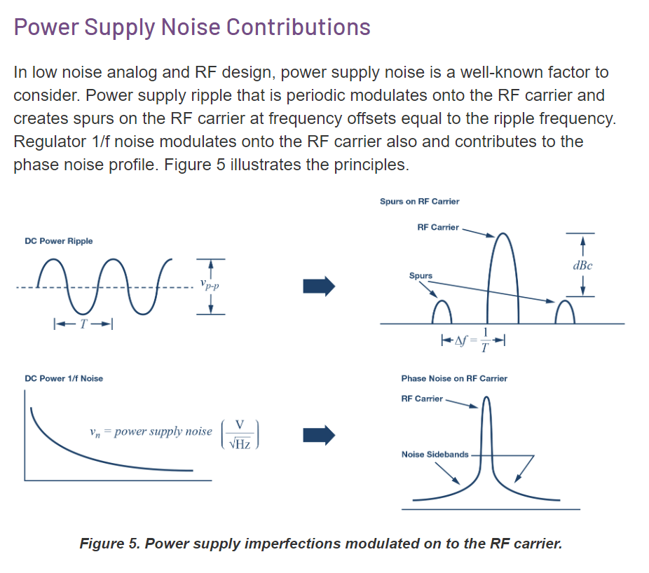

You left out a couple causal factors: Clock close-in phase noise, and Vref noise. For a discrete resistor RTZ FIRDAC, you can see how MarcelvdG designed his power supply for the final output logic devices. In his design, that power supply is Vref. Links to schematics at: https://www.diyaudio.com/community/threads/return-to-zero-shift-register-firdac.379406/
Maybe take a look at the references at the end of this:
https://www.analog.com/media/en/ana...le-ultra-low-phase-noise-dds-applications.pdf
My comment: you seem to be focused on the DSP aspect of FIRDAC design. The problems you may be overlooking are analog engineering design problems. A dac converts digital analog, right? The analog part of the dac needs to be good too. The clock is an analog time reference. Vref is an analog voltage regulator. IOW the analog part of the dac design is not only about output stage filtering.

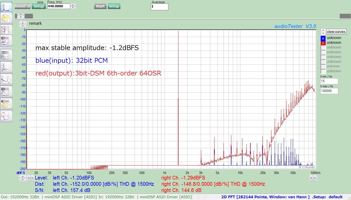

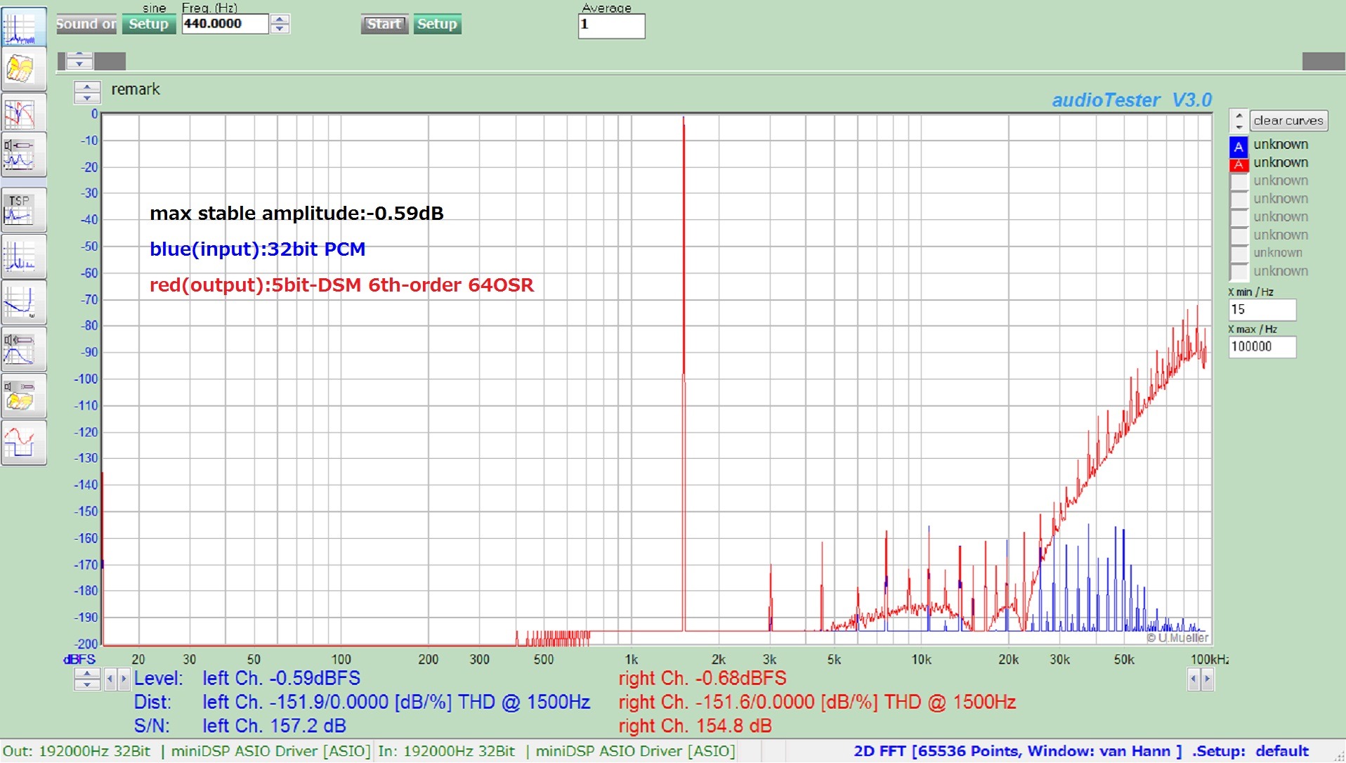

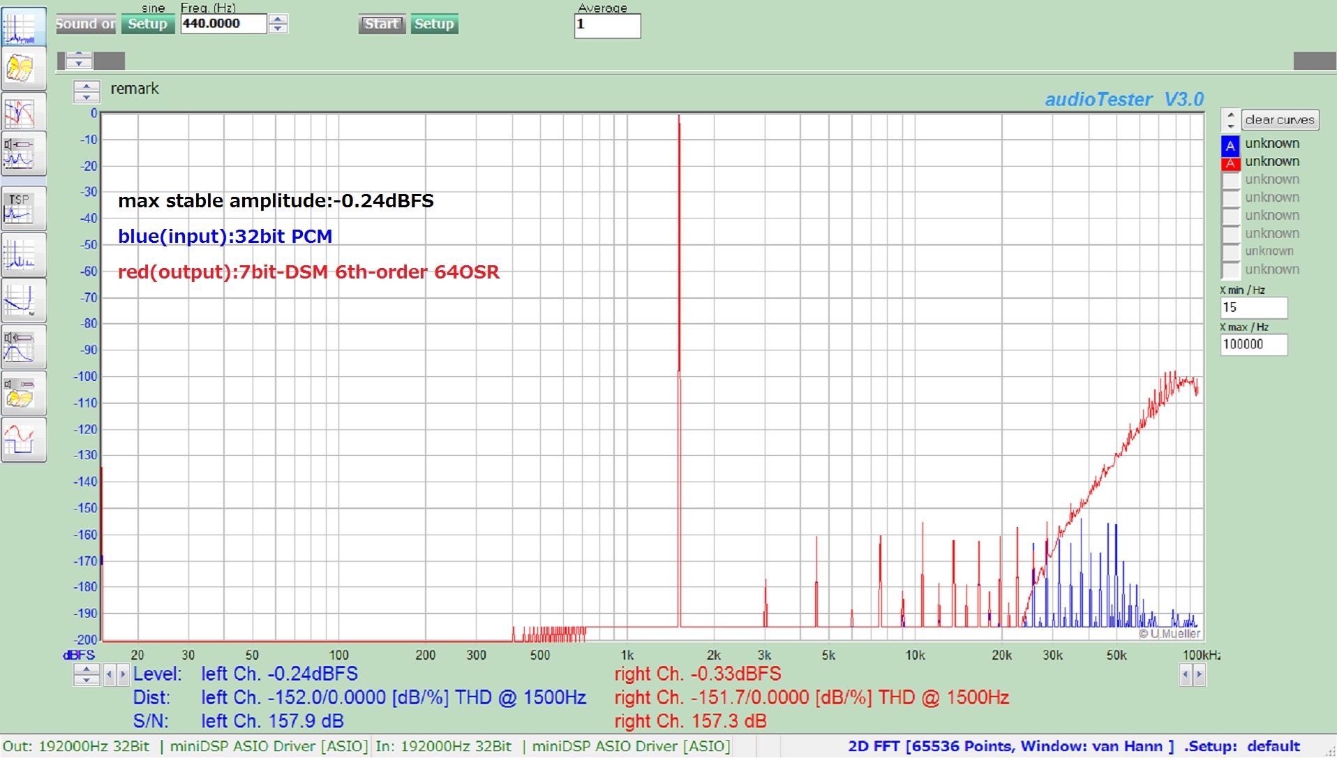

This is the performance of the entire digital path of the DAC. I mean 48K input up-sampled and filtered to 768x.
The output was taken from Verilog simulator. Additional moving average of 16 consequent data samples applied(FIRDAC model).
Input level was 0dB, that means about 0.54 modulation depth. FFT length - 2**20.
Thank you for the data; very interesting🙂. Does this mean that for a 0dBFS input, the output level becomes 0.54 (-5.35dBFS)?
I don't understand the source of the 2-nd harmonics on you attached pictures, because of digital output of the modulator
is always free from even harmonics. Simply by principal of operation.
In the case of DSM (Delta-Sigma Modulation), whether it's 1 bit or multi-bit, the behavior is not the same for the positive and negative sides. Therefore, even in the digital domain, the elimination of even-order noise does not occur. In PWM (Pulse Width Modulation), the positive and negative sides operate symmetrically, and theoretically, there is no even-order noise, correct?
For modulators designed for multi-bit types like the AK4499EX, even-order components still remain, as shown in the attached file. However, when it goes below -140dBFS, the accuracy on the FFT side may become a factor. Additionally, as a fundamental issue with DSM, especially with 1-bit, there is some inconsistency, so the repeatability of THD at such levels is low. In practical terms, if it's below -140dBFS in the digital domain, it should not have any impact on the analog signal.
Yes, you are correct. More modulation leads to abrupt increase in distortions due to longer non-minimal phase delay in the feedback loop.
I always thought that correctly designed digital DSM is absolutely simmetrical. Negative numbers are not much different from positive, until saturation. Of course, 0x7ffff /= -0x80000.
You are absolutely correct. Yesterday it was -142dB, today -140dB and no idea what will be tomorrow.
I don’t have so stable and precision tools at home to measure better. Another issue is that the harmonics from different origin cancel each other. This effect may change with time and temperature.

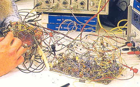

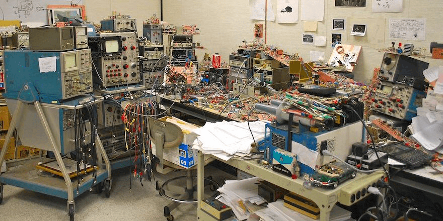

Here's a pic of Bob Pease working (if you know who he is):
Here's Jim Williams' lab:
IOW, sometimes its good to roll up your sleeves and do some R&D instead of sit in a chair and think of reasons why you shouldn't have to get dirty hands.
Jim was a master of subtle analog craftiness - especially noise measurements. I once wrote him a letter congratulating him on a WSJ article recognizing his achievements and he called me on the phone. We chatted for nearly an hour. He was truly an engineering hero of mine. RIP, Jim.
