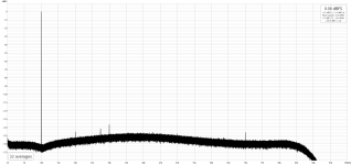

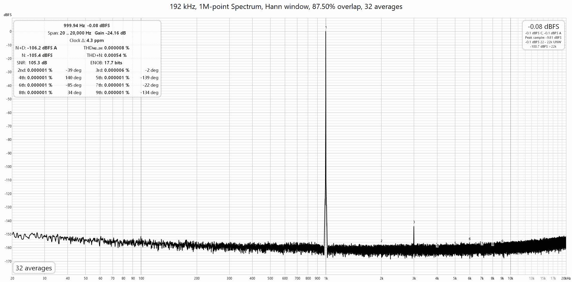

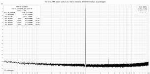

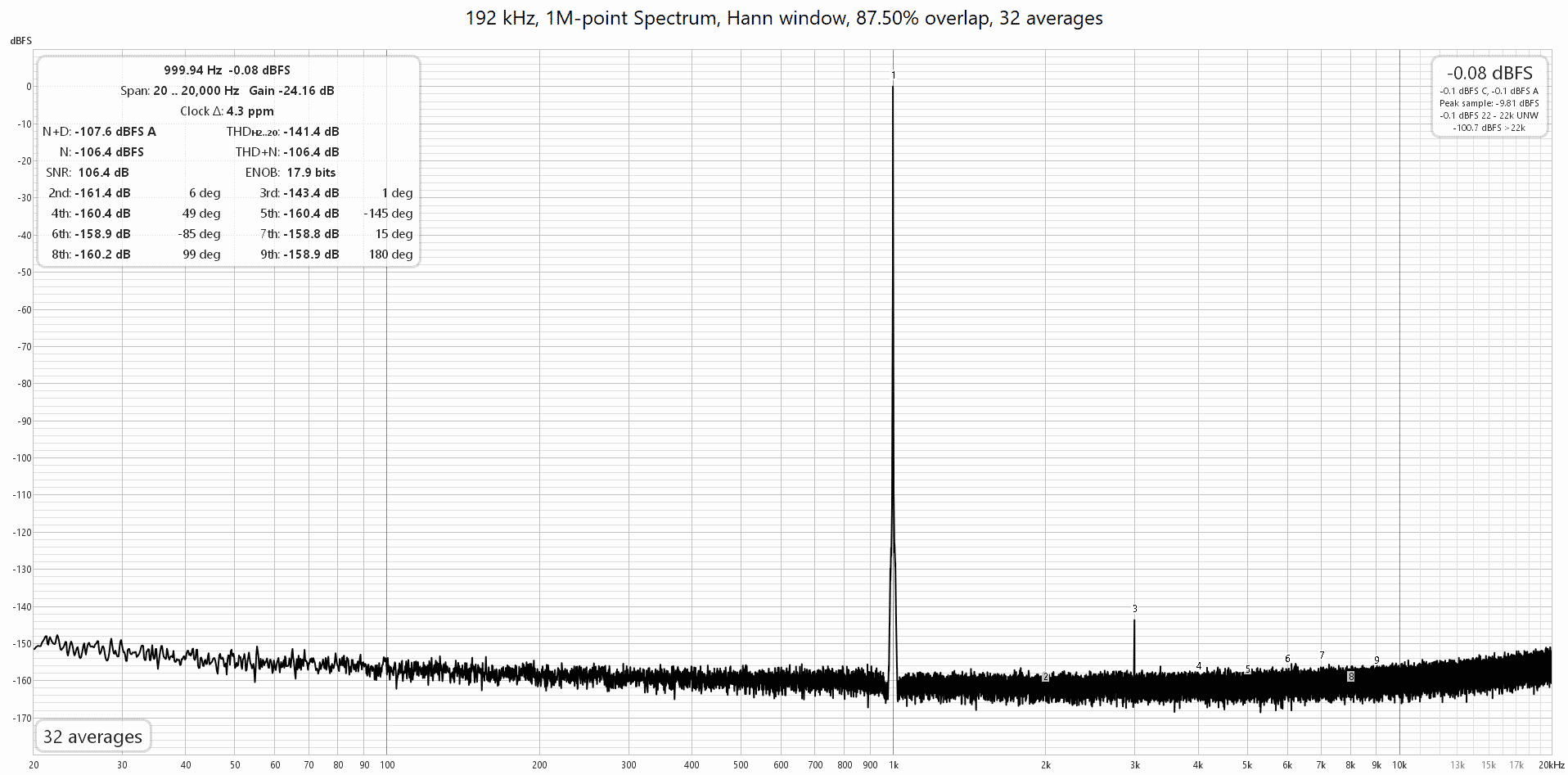

I wrote a new experimental version of FPGA code for 24.576/22.5792M oscillators with 14tap FIRDAC.
I also studied and tweaked REW for correct compensation of the notch filter.

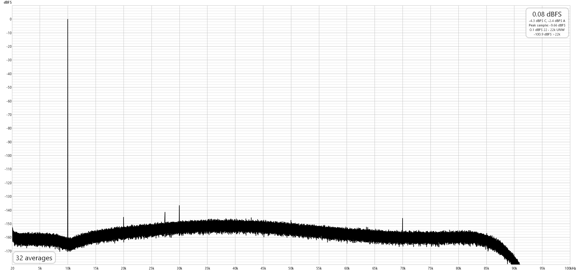

Here you can see the results for 1K & 10K 0dbFS.

The results are impressive.🙂 Standard 1-bit DSMs don't exhibit such characteristics. I believe Chord may offer the best numbers, but THD and SNR would probably be around 115 dB. Only Molamola, which uses PWM, achieves such figures. PWM seems to be the differentiating factor.
One curious aspect is that the SNR is around 105 dB. I use a 2-bit DSM, where THD and SNR are essentially the same thing. One doesn't typically improve without the other. This was also the case with 1-bit DSM. This might be the advantage of PWM. When using a 2-bit DSM, both THD and SNR approach 120dB. While THD is slightly better in terms of numbers, the reproducibility is significantly higher compared to 1-bit DSM. When multiple boards are made using PWM, will they all have the same numbers?
PWM DAC has absolute differential linearity. That means, that just increasing noise filtering (or number of FFT points) you can see harmonics below noise level.
So THD can be a lot better than THD+N.
The 3-rd harmonic was caused by nonlinearity of the CMOS outputs. It could be reduced further by loading FIRDAC with very low impedance LPF.

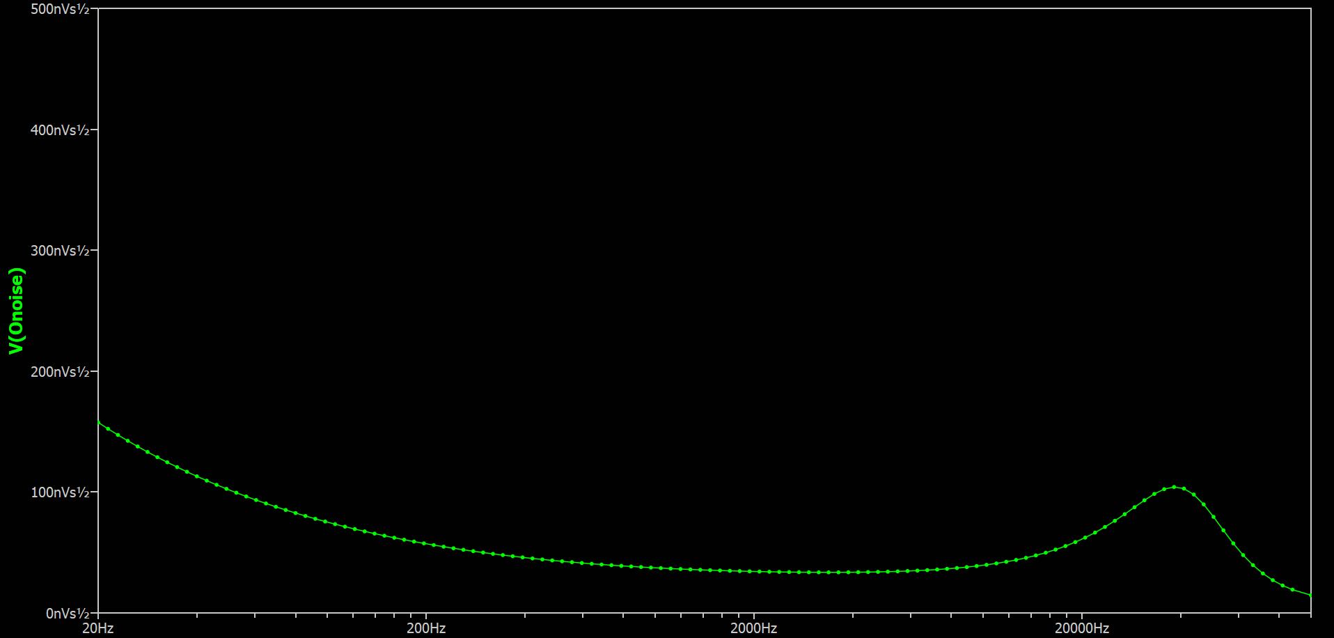

The SNR 105dB is defined by dominant noise of analog LPF, because the noise floor precisely follows PSPICE noise simulation.
You can see it on 10k plot, it has a bump ~40k as predicted by SPICE.
The benefit of PWM modulation is very low switching frequency of 1-bit output. And PWM spurs can be easily eliminated by simple moving average (FIRDAC).
By now I assembled 2 slightly different versions of the boards, they both have the same performance. The design is reproducible.

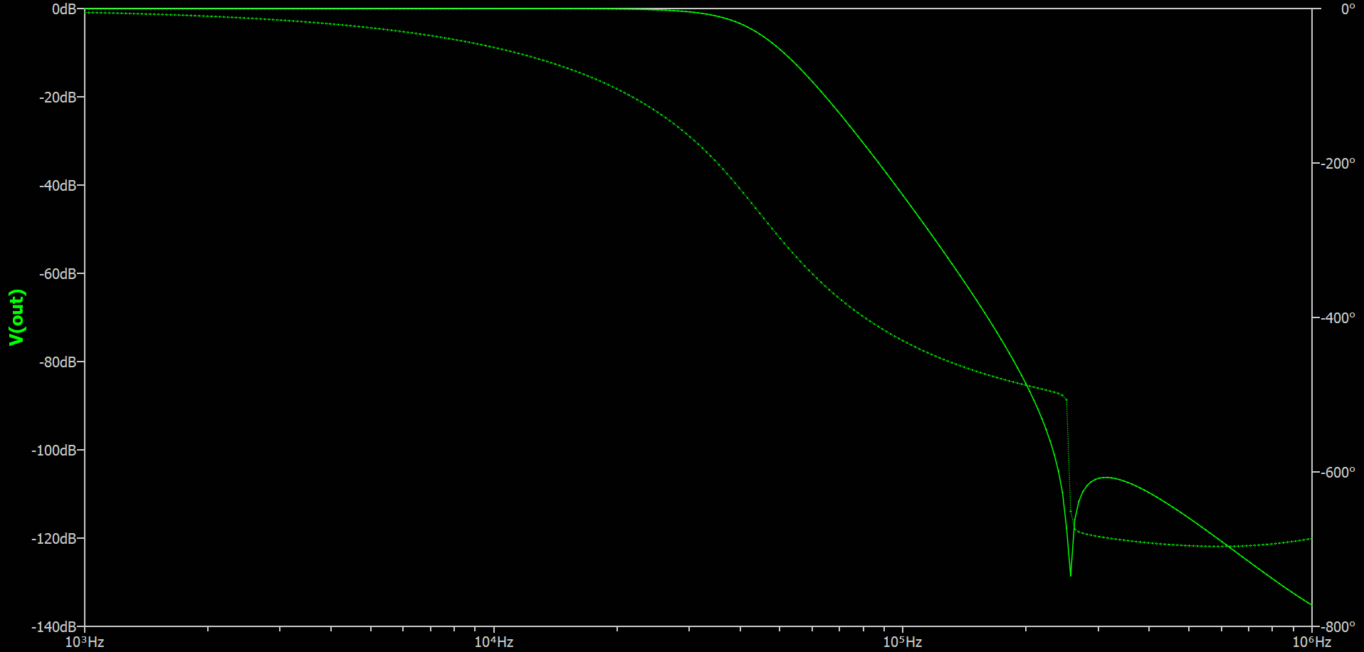

TNT: I used very simple REW calibration file to compensate notch filter and to scale output to 0dBFS.
This DAC has 0dBFS 0.816V, it is not standard, but there is no easy way to change it in existing hardware.
20 26.25 0
800 26.25 0
980 26.25 0
990 -9.75 0
1000 -9.75 0
1010 -9.75 0
1020 26.25 0
1200 26.25 0
10000 26.25 0
20000 26.25 0

In the case of 1-bit DSM, the positive and negative sides are not symmetric, even in the digital domain. Therefore, even with perfect analog conversion, even-order harmonics occur. If PWM does not have this issue, then PWM is superior as a methodology. Perhaps many discrete DACs use 1-bit DSM, which might have been a misstep in the initial approach.
In DSM, increasing the OSR (Oversampling Ratio) to suppress quantization noise also increases the switching frequency, leading to increased noise during analog conversion. A 256 OSR is nearly the upper limit. Are there any materials explaining why the frequency doesn't increase in PWM?
You are not correct. If 1-bit DSM is properly designed, it must have RZ at every output interval. Hence, the resulting error should be a tiny DC offset.
I, personally, prefer differential output, where effects on negative and positive edges are coincident and almost instantly cancel each other.
What is critical - tails after each transition leave exponentially decaying residue. It might be even thermal effects in semiconductors or whatever you can imagine.
If you use high frequency output, this residue will boost THD, because of it is signal correlated.
In case of PWM modulation, the output transitions happen at the frequency about 10 times or more lower than OSR, so exponential decay leaves less memory of the previous sample, thus reducing correlation (or ISI).
Another aspect is that OSR should be as high as possible. With "infinite OSR", you end up with a SPICE model of the analog amplifier.
But the output quantization frequency is not related to OSR at all. You can choose it according to the design needs and tradeoffs.
In my case OSR is x1024, PWM clock= x512, and output PWM frequency x512/14= 48k*512/14=1775k.
High OSR rates help to reduce non-minimal-phase lag in the feedback loop.
I have not read many papers about DSM design, my opinion - this stuff mostly written for academic purpose, rather than for practical design needs.
All you need - to study and understand original Eric Bode's monography (1949) about feedback theory. Laplace and Z-transforms are the must as well.
DSM DAC - is a simple digital model of the analog amplifier with very high loop gain and with non-linear output stage.
BTW, my PWM DSM is ridiculously simple, I even don't use multipliers at all.
It is even simpler than B.Putzeys ripple-compensated approach.
