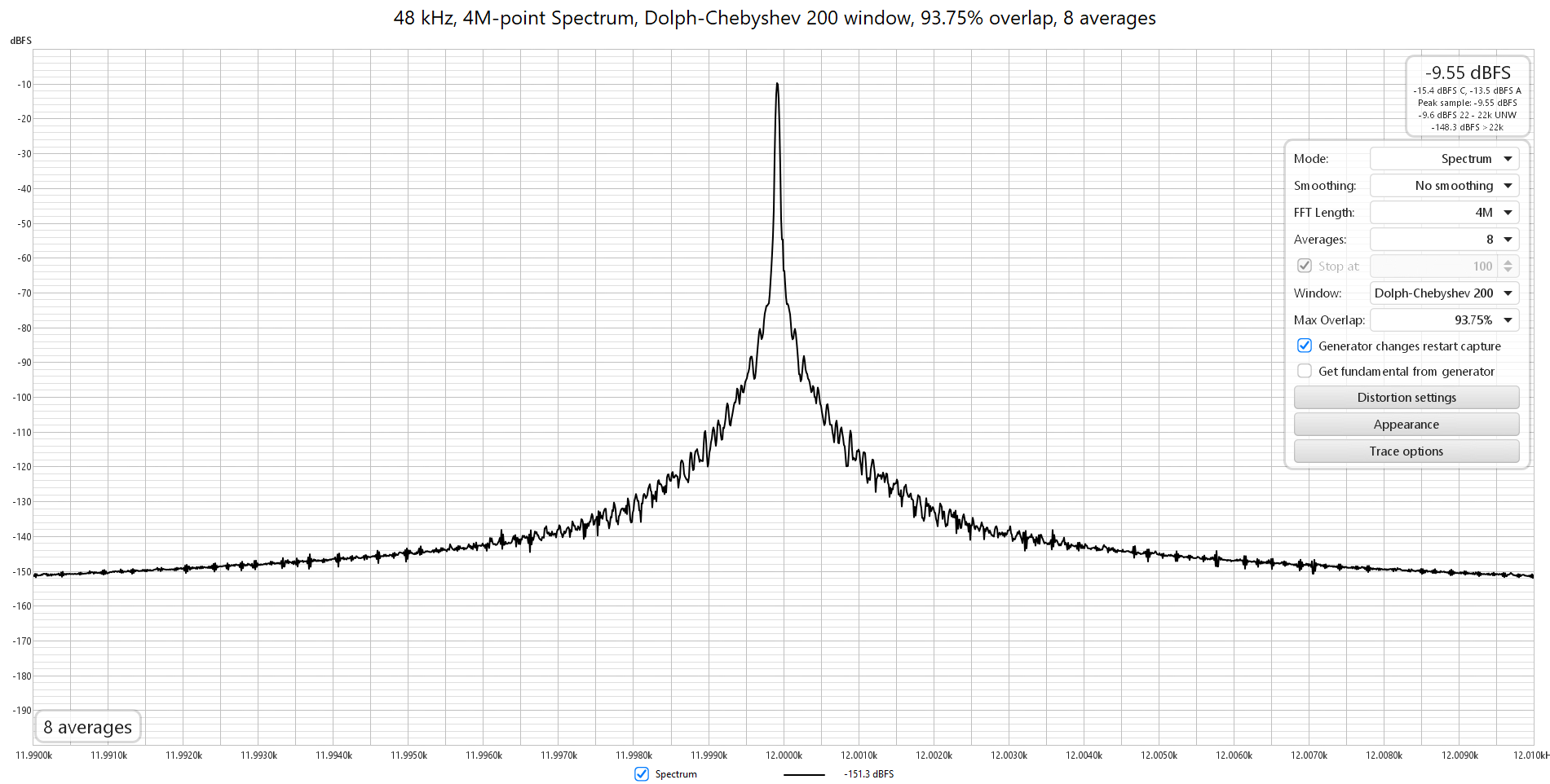

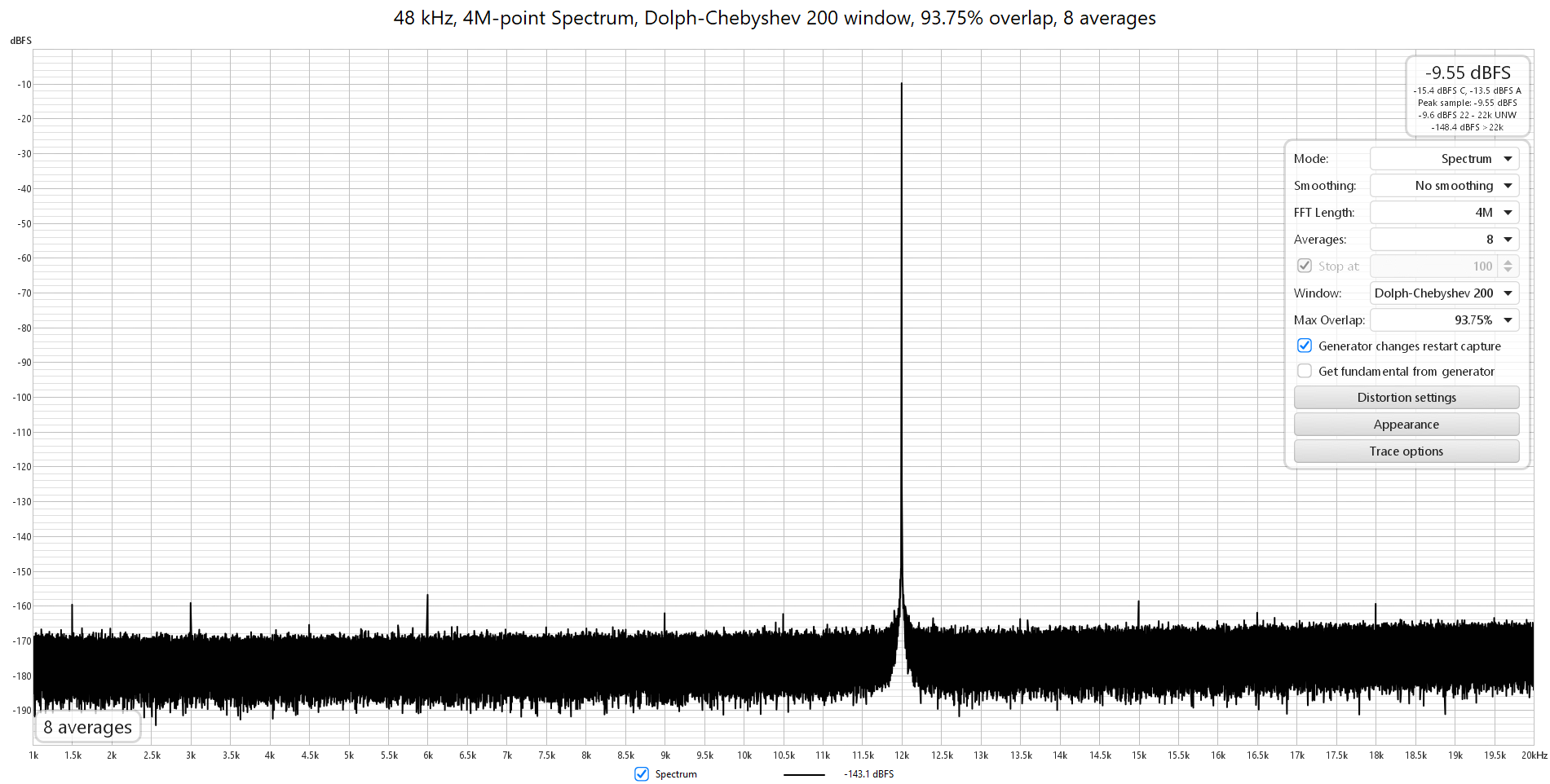

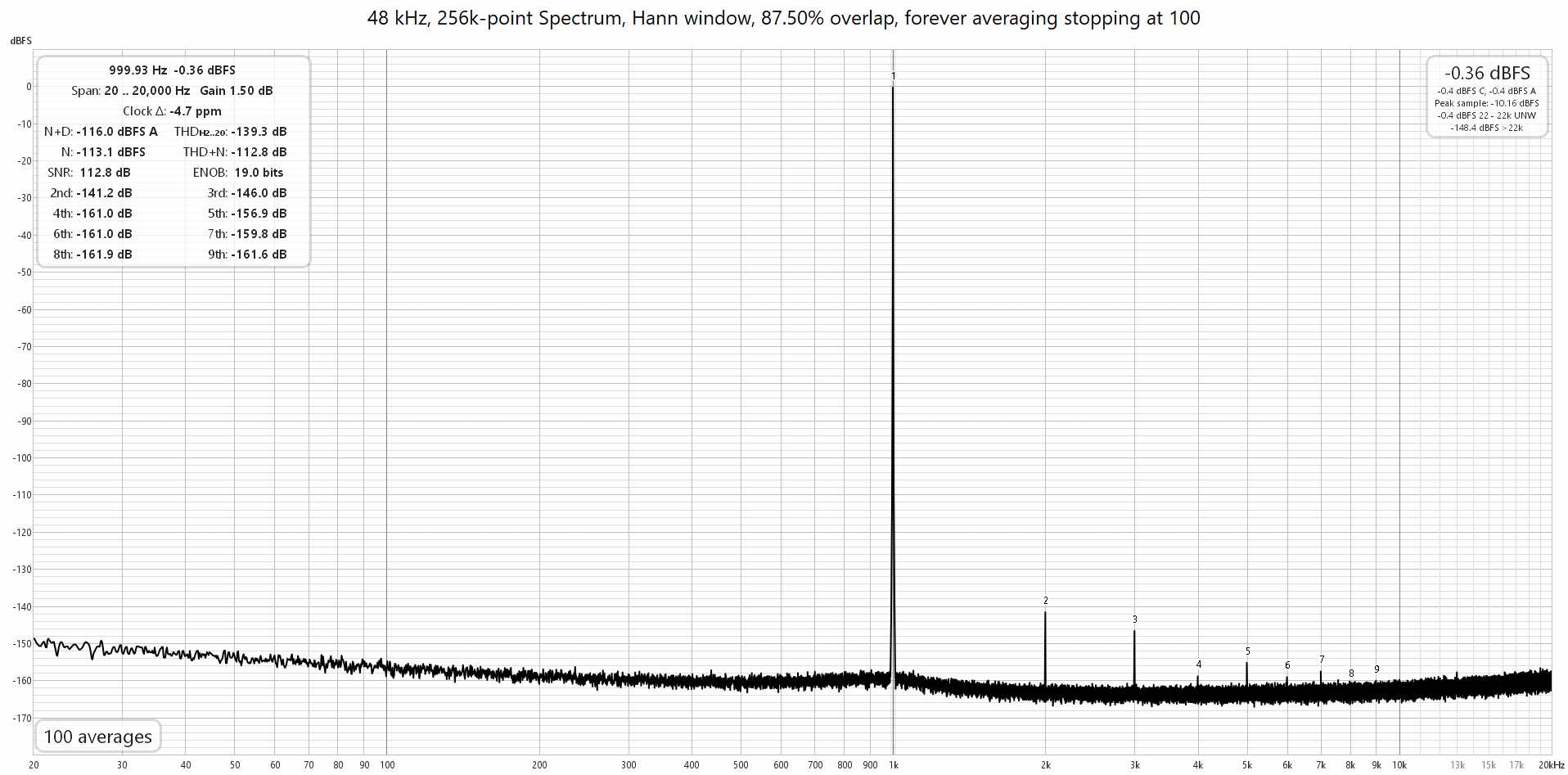

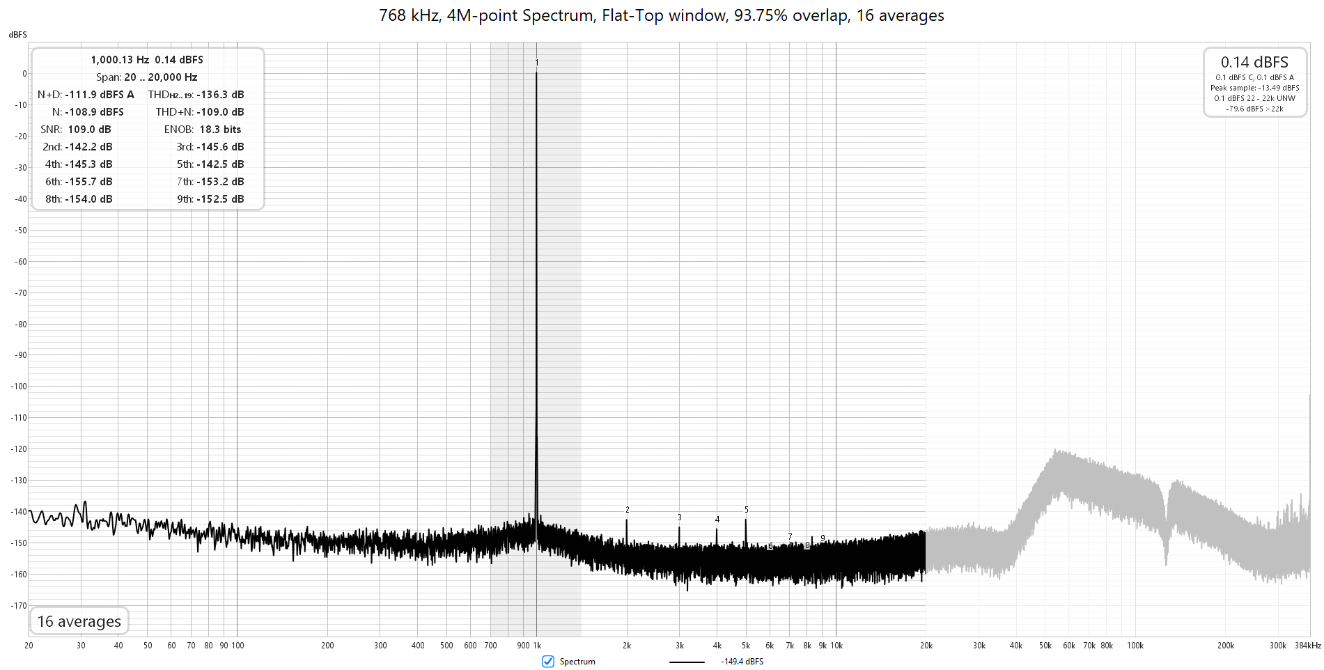

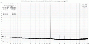

Couple of weeks ago I found a few hours for experimenting with the DAC.
1. Just tuned values of passive components of reconstruction filter to improve SNR.
Now unweighted SNR is close to 112dB @ 48KSPS. That gives about 18+ ENOB.
2. Added couple of J-tests, narrow 12k+-10Hz and wide - 1 to 20k range.
The legend of the images is: J-narrow, J-wide, Typical THD, measured at 768SMPS (noisier than at 48KSPS).
Estimated phase noise at 10Hz offset from 12KHz approximately = -((152-10)-db(10/(48e3/2^22))) = -83.17dBC/Hz
Note: input from optical TOSLINK interface.

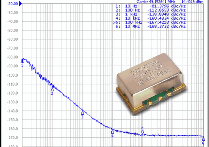

It is interesting that my estimate of the phase noise of the DAC exactly matches the datasheet of Crystek CVHD-957.
So, if you see some measurement looking much better than in the post above be a bit suspicious.

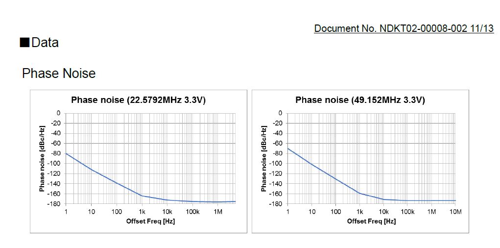

This is an image from CVHD datasheet, it has the same -80dBC/Hz at 10Hz.
Noise skirts around the fundamental contain both AM noise and PM noise. AM noise comes mainly from Vref (DAC & ADC). So getting same noise level at 10Hz between noise skirts and clock datasheet phase noise plot is quite likely incidental.
There are clocks with lower phase noise than CVHD-957. E.g. NZ2520SDA which I mostly use has about 20-30dB lower phase noise at 10Hz according to datasheet. So measurements looking much better may just be using better clock (and Vref).

Understood, looks like the skirts on FFT are not relevant to the clock jitter at all.
To measure oscillator jitter/p-noise correctly,
you need to transfer the clock frequency to DC using the same oscillator as reference for RF mixer.
Today I measured -130dBc/Hz at 12k+10Hz with a little improved setup🙂.

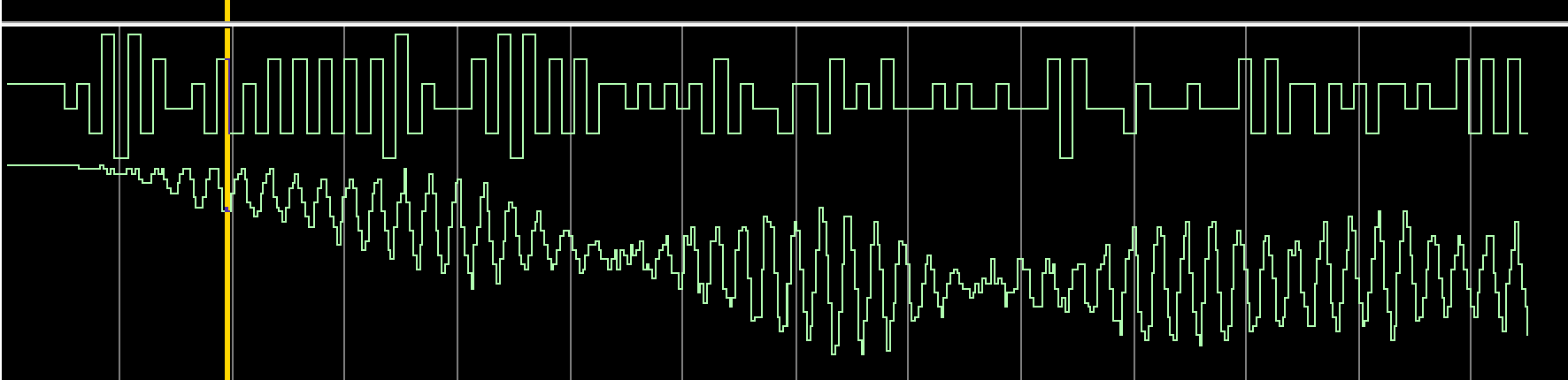

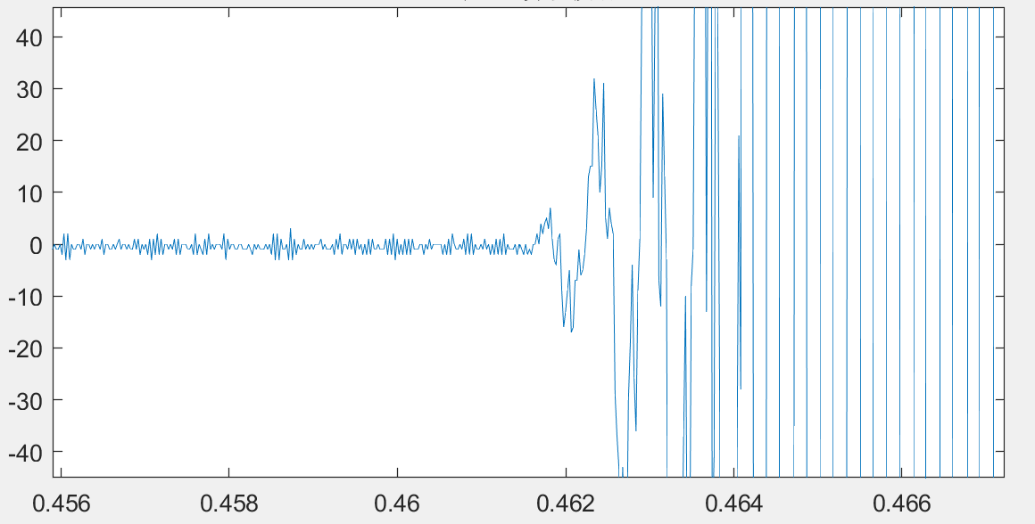

The above image is the begining of the wave of a song,I use halfband fir to interplote the wav,but the interploted wav is not good,how to interplote the wav to good status? the begining of the wave is just noise,I want to filter it out .
