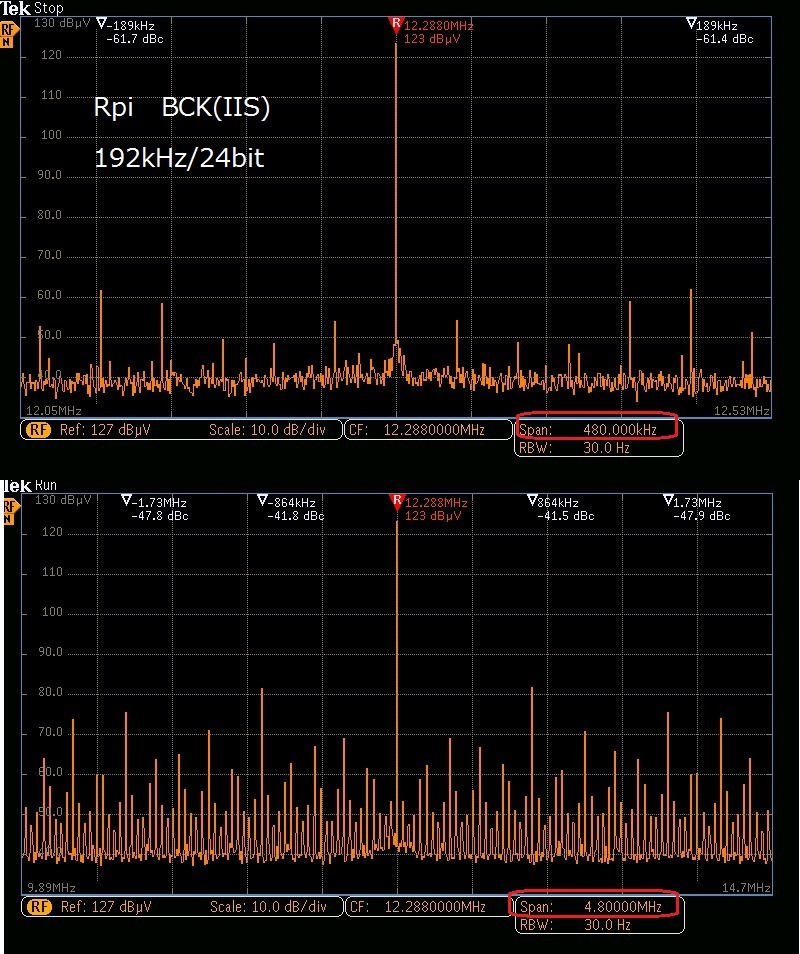

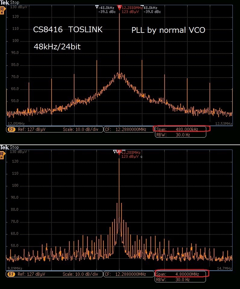

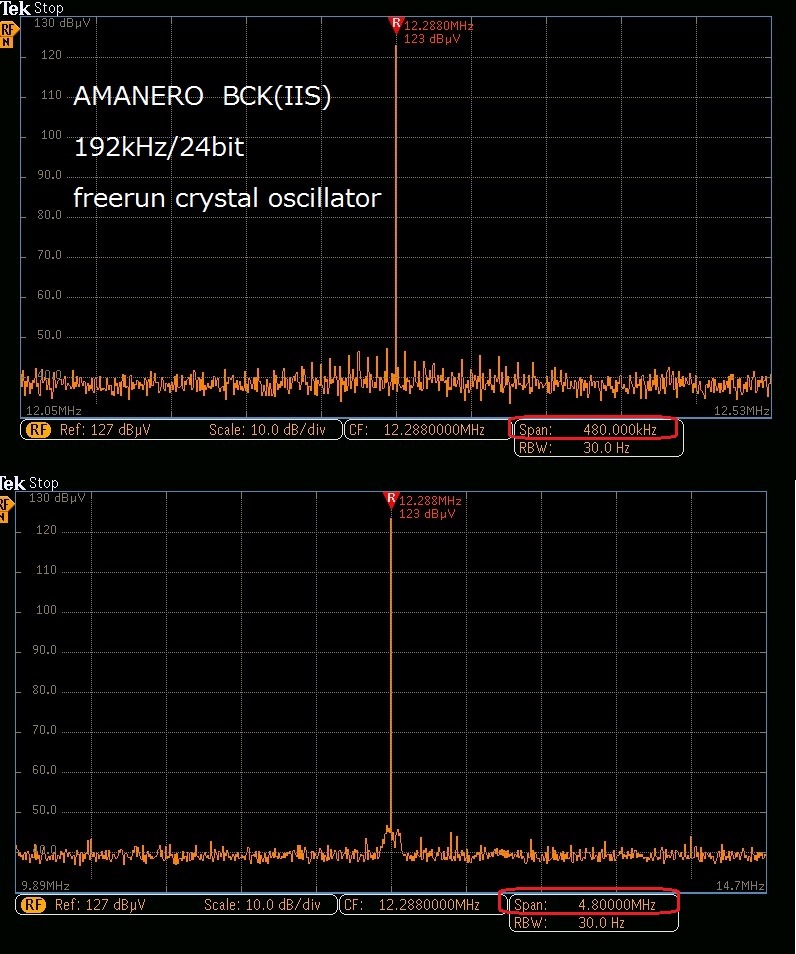

I've also attempted to use an external oscillator with an FPGA to separate the clock from TOSLINK. However, the results were unsuccessful, and I eventually gave up the TOSLINK approach. Even commercial chips claiming top performance yielded a similar performance (pic#1) as cs8416. The recovered clock (24.576MHz) exhibits certain spectral elements and Gaussian-like phase noise. Due to TOSLINK specifications, which allow the clock to only be bursty, and inconsistencies in the optical cable delay, a successful result was impractical. If you have succeeded in recovering the clock without issues, that's fantastic 🙂.
Nevertheless, since optical transmission is crucial, I've employed a simple phase modulation to send data. This also involves an external oscillator combined with an FPGA, achieving performance comparable to the AMANERO (pic#2). For reference, the clock from the Raspberry Pi (pic#3), often considered the worst, does not exhibit Gaussian-like noise. I guess it has no delay inconsistency.

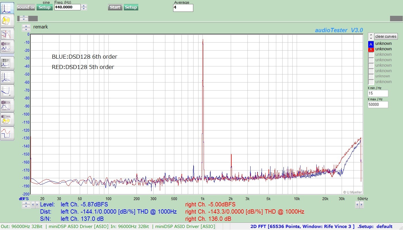

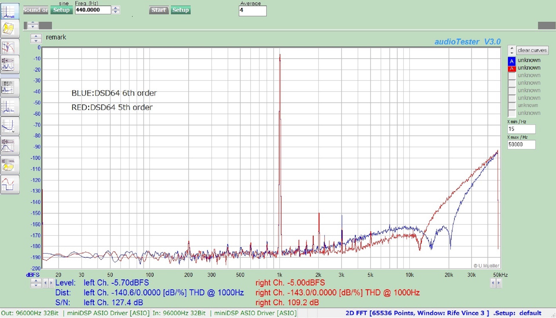

It's quite intriguing. I've come across differential PWM implementations where XQ is created with its unique reference voltage, not simply an inversion of Q. Is your circuit designed in a similar manner? If not, there might be no need to implement separate ICs for Q and XQ.
The most basic PWM, much like a first-order DSM, tends to have long durations for both high (H) and low (L) states, lacking effective noise shaping and resulting in poor total harmonic distortion (THD). When applying deep feedback, how does the output waveform change for PWM? I would expect shorter durations for H and L, causing quantization noise to shift towards higher frequencies.
The attached images are the digital domain characteristics of the fifth and sixth-order 1-bit DSM with 64OSR (pic#1) and 128OSR (pic#2). For an eighth-order PWM, I'm curious about the frequency at which quantization noise starts to rise. If you have FFT data, that would be appreciated 🙂.

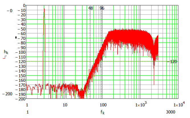

Hi xx3stksm,
This is the performance of the entire digital path of the DAC. I mean 48K input up-sampled and filtered to 768x.
The output was taken from Verilog simulator. Additional moving average of 16 consequent data samples applied(FIRDAC model).
Input level was 0dB, that means about 0.54 modulation depth. FFT length - 2**20.
On the physically measured spectrum, the noise "break wall" is visible from about 100K only, due to very high loop gain of the modulator.
The modulator pushes almost to near 0 all kind of distortions and noise floor modulation.
You can notice even a small fall down above 20kHz, where Digital Filter cuts out a chunk of 24-bit quantization noise.
All you need - to fight only analog domain artefacts.
I don't understand the source of the 2-nd harmonics on you attached pictures, because of digital output of the modulator
is always free from even harmonics. Simply by principal of operation.
