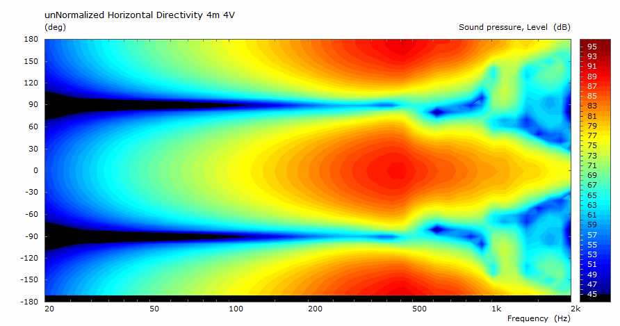

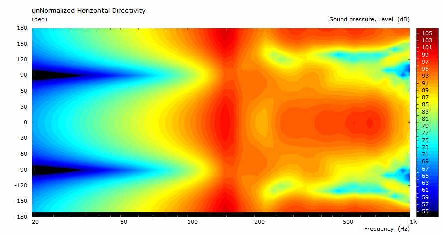

The ABEC simulations here show that if you want constant directivity, you shouldn't use the modelled U-frame much beyond 100 Hz.

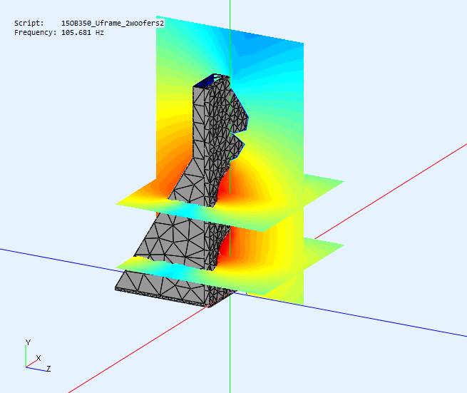

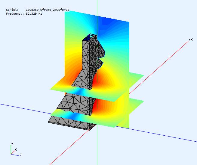

It’s not absolutely clear to me what we are looking at. Red is both drivers, blue is driver 1 and Green is driver 2?Interesting, if I run my dual woofer model with a single woofer enabled, it predicts 2 db more output at 100 Hz. Here are lower woofer, upper woofer, both woofers, in that order. This is hard to explain. Perhaps lower woofer rear output cancels upper woofer front and vice-versa, but the idea that a single woofer is better than two borders on preposterous. I thought my "LE" script (effectively the XO schematic) would put the two drivers in parallel by virtue of them being in the same drive group but that might not be the case. I need to rewrite the LE script and elements file so each driver is in its own drive group. That should clarify this.

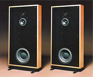

This is why on the live edge dipoles the coax is 38” off the floor and the sub is against the floor. The floor coupling cannot be avoided so we use it for reinforcement in a band where the reflected wave can’t be confused as a 2nd signal. @daynegerThe goal is to have NO REFLECTIONS reaching the listener until at least 4msec after the direct sound. The floor bounce is such a reflection, and it will arrive "too soon". Regarding reflections:

The first time I saw this done was the Boston Acoustics A200 and many designers do this.

In the SPL charts, green is the radiation from the rear of the woofer(s). Dark blue is the radiation from the front of the woofer(s) diaphragm. Red is the sum of the two. In the SPL chart for the two woofer sim, green includes the radiation from the rears of both woofers; similarly for red and blue.
In the abec model, each side of each diaphragm is assigned to a DrvGroup. This is done in the elements.txt file. In the LE.txt file, where LE stands for lumped element, a netlist of drivers and filter and potentially cross over components is created with DrvGroups being the links between BEM modelling in the elements file, LE modelling, and fields and spectrum "observations". One can observe the SPL, fields and the spectrum of any Drv_Group.
In VACS, the graphical display utility, one can extract curves from the polar maps and export the polar data. Then, with a name_change utility such as AdvandedRenamer, one can convert the names of the exported files to suit their use as Vituix directivity files.
As I implied before, in the two woofer sim, I should have assigned the diaphragm sides of the two woofers to different drive groups to ensure that they were effectively connected in parallel rather than series.
The one-woofer sims include only a single woofer model; the 2nd woofer is commented out of the model. I don't believe there is any way to simulate the effect of one cone pushing the other cone back and forth in ABEC. I think this is more of an issue for measurement than simulation. If measuring a single driver with other drivers in the vicinity, one would want those other drivers to remain connected to amplifiers so that any voltage induced in an idle driver's VC would be dissipated in the amp's near zero output impedance.

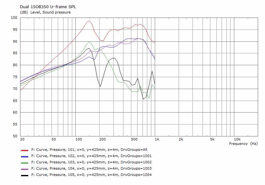

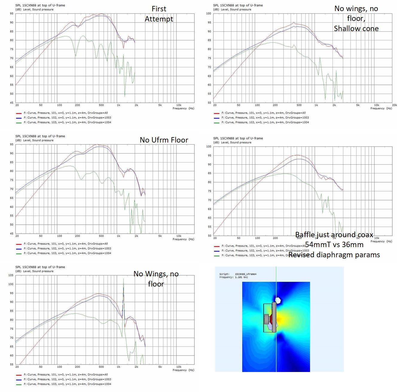

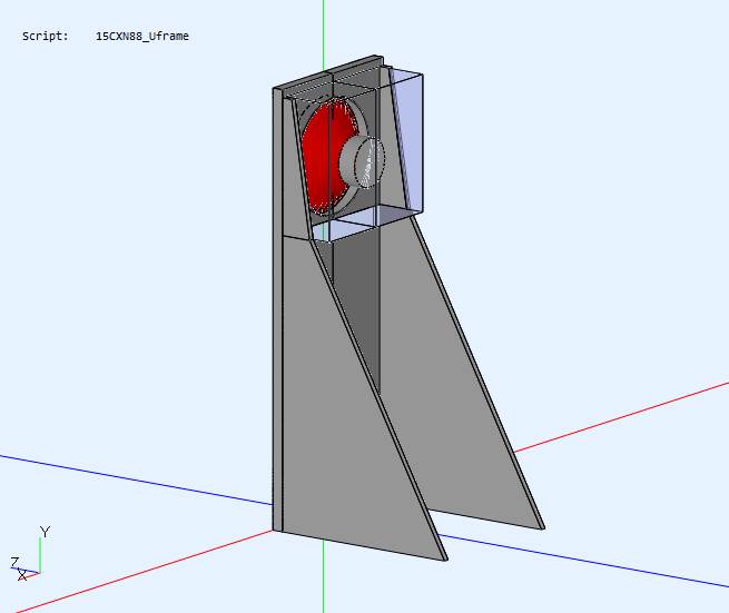

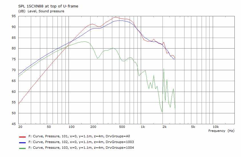

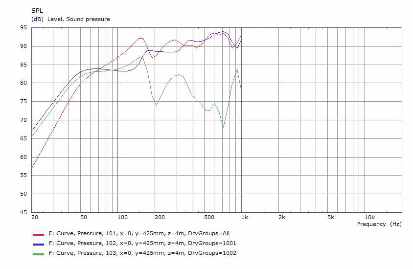

I needed to redo the U-frame sims with each diaphragm side assigned to a different drive group. The ABEC documentation seems to have an implicit assumption that there is only one driver in a drive group, which is counter-intuitive given that its called a group. With this recoding that places the two drivers in parallel, they sum to 6 db more than a single driver as expected
In the course of doing this I found that in my prior orgy of spinning off multiple simulation models to get a handle on what was going on, I had the wrong driver parameters in my LE script, those for the 5208C_LF instead of the 15OB350. Correcting that yields more SPL but doesn't affect the directivity. This escaped notice for so long because I have been focused on directivity, confident the SPL could be sorted out later because ABEC doesn't require that the directivity be re-computed after changes to the LE script.

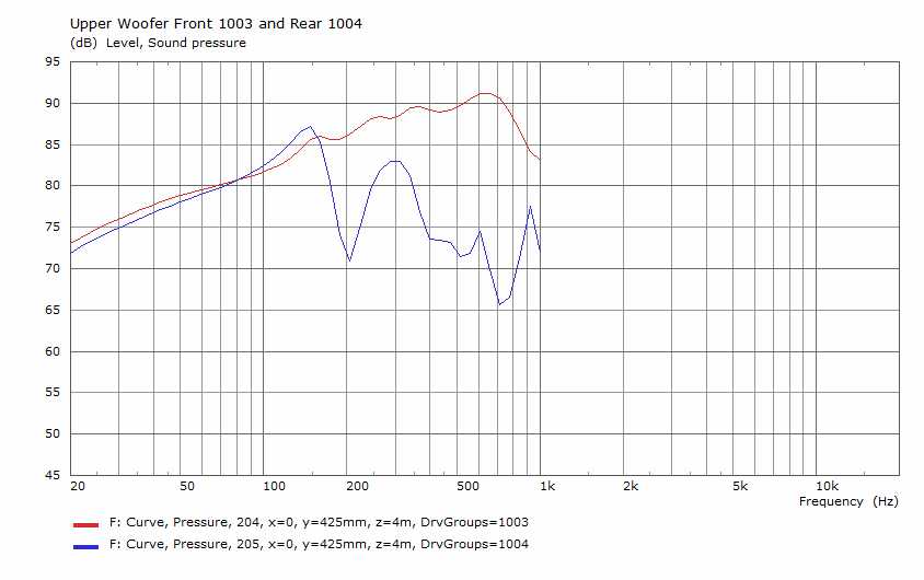

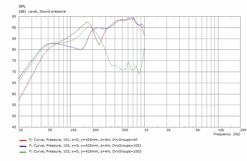

Here are the new SPL curves
The red is once again the sum of all four diaphragm sides. 1001 and 1002 are front and rear,
respectively for the lower woofer; 1003 and 1004 for the upper woofer. The next two charts chose these separately for each woofer.
Interesting that there a pronounced dipole peak and null for the upper woofer, where the wings are shallow, but not for the lower woofer. The output below 100 Hz is about the same for both woofers. Were I not planning sealed sub plus dipole instead of a dual woofer U-frame, I would look into this further.
The slanted wing profile may not yield more low end SPL but it does reduce the (out of passband) dip in the composite response due to the dipole null.

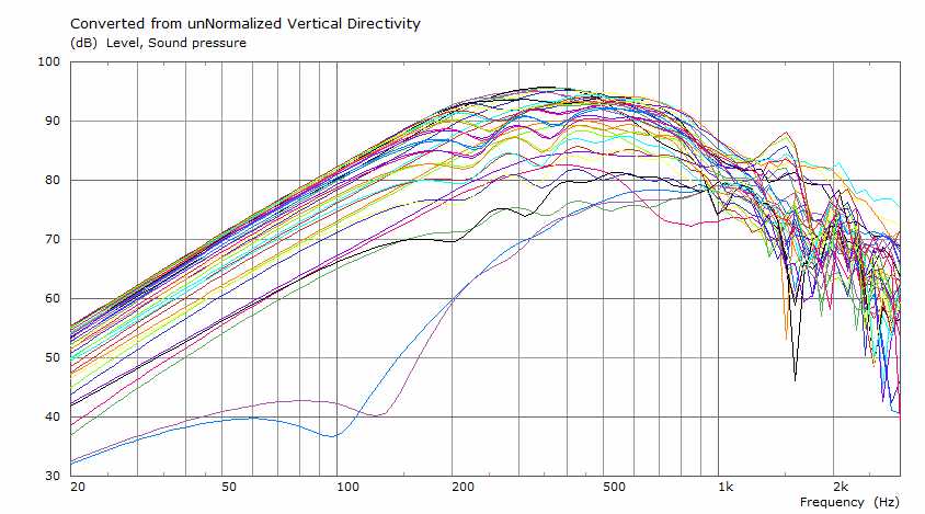

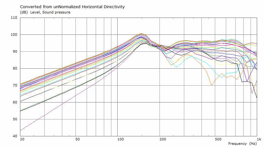

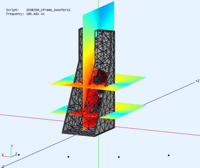

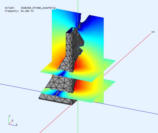

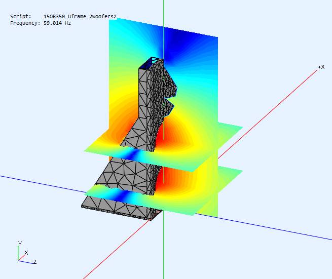

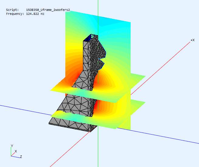

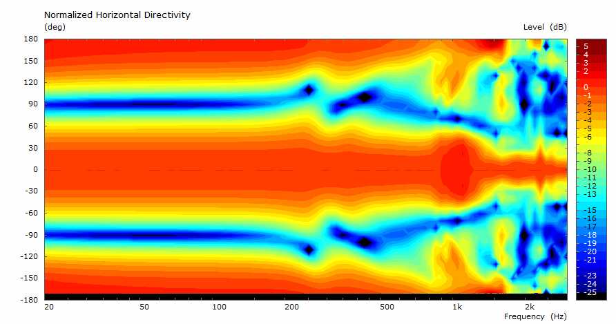

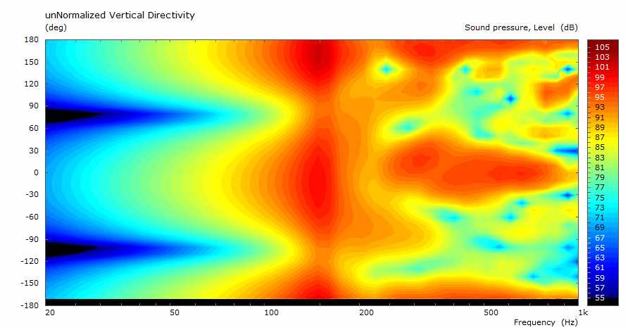

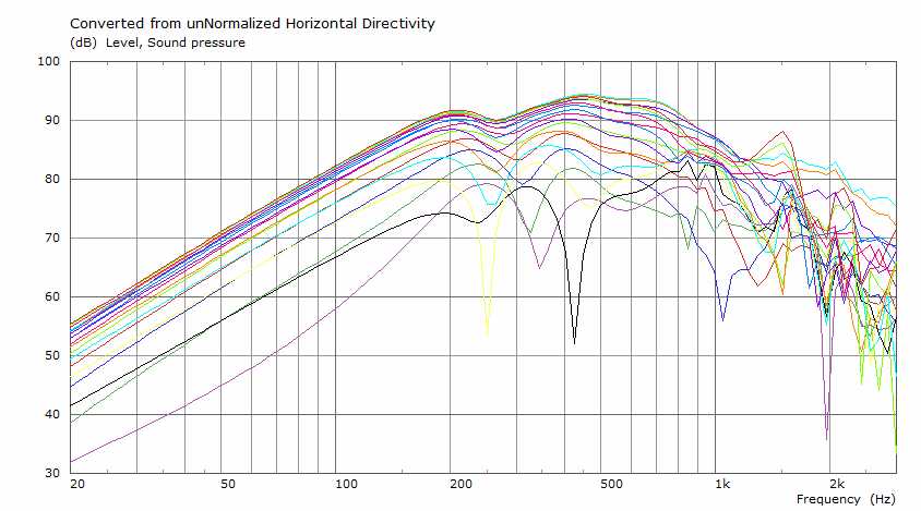

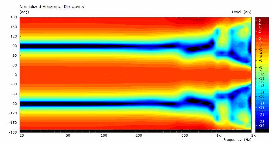

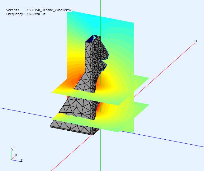

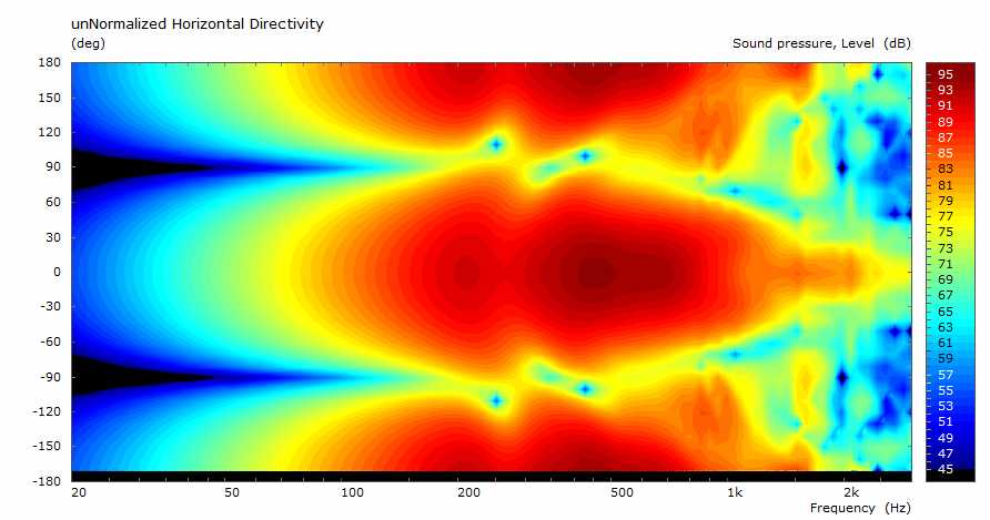

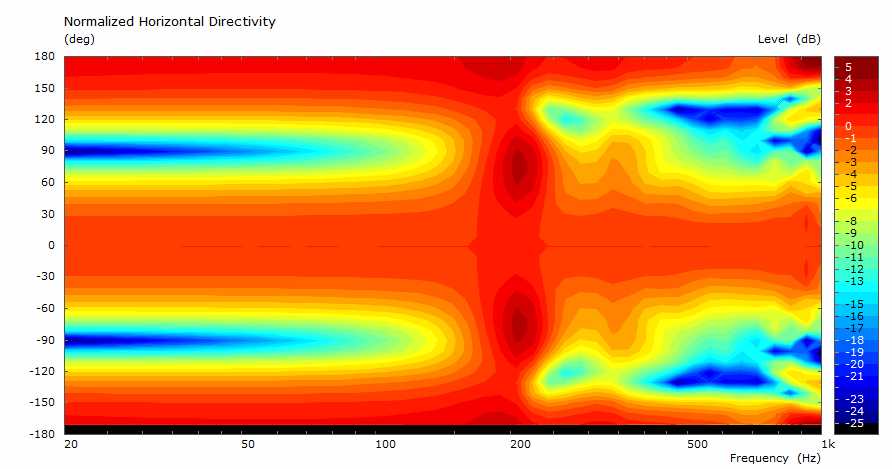

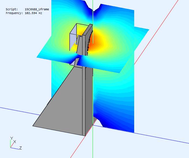

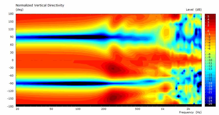

Here are the directivity files for this version. Theoretically, they should be no different than earlier, certainly not the normalized polar maps.
and the fields views

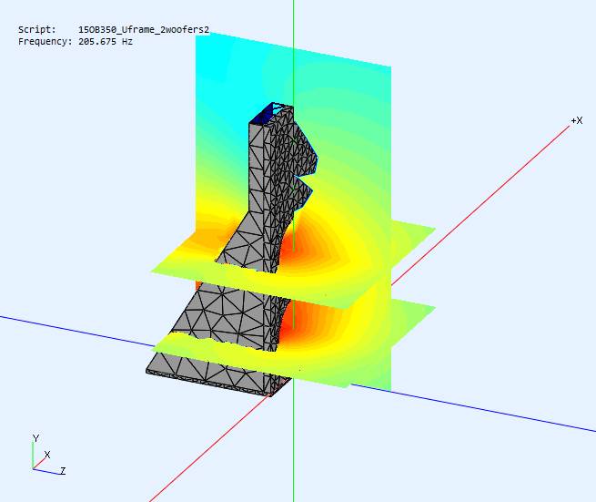

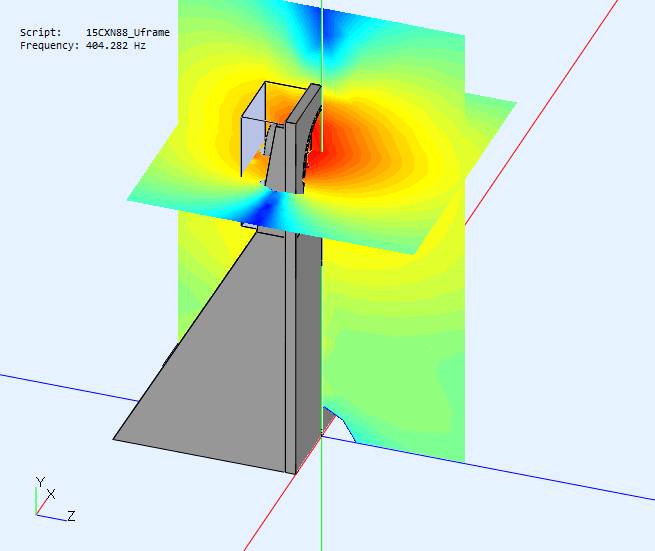

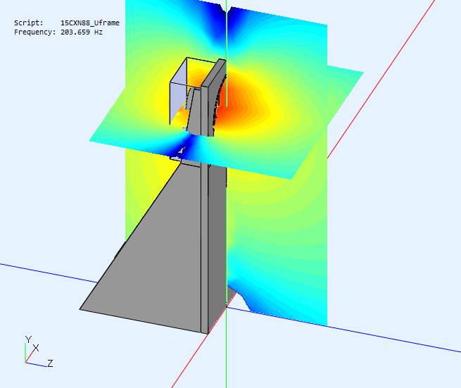

40 Hz
The last two images are 160 Hz, close to the dipole peak, and 210 Hz, close to the dipole null.

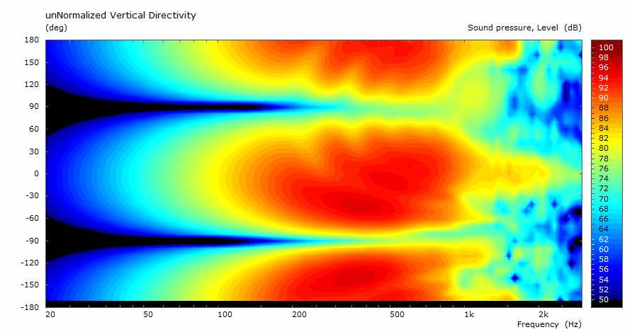

How high can this U-frame be used? It depends how constant you want the directivity to be and how far down the driver you are crossing it over to can reach without strain. The side nulls are still distinct at 80 Hz but already widening by 106 Hz. By 160 Hz, they are almost gone.
40 Hz

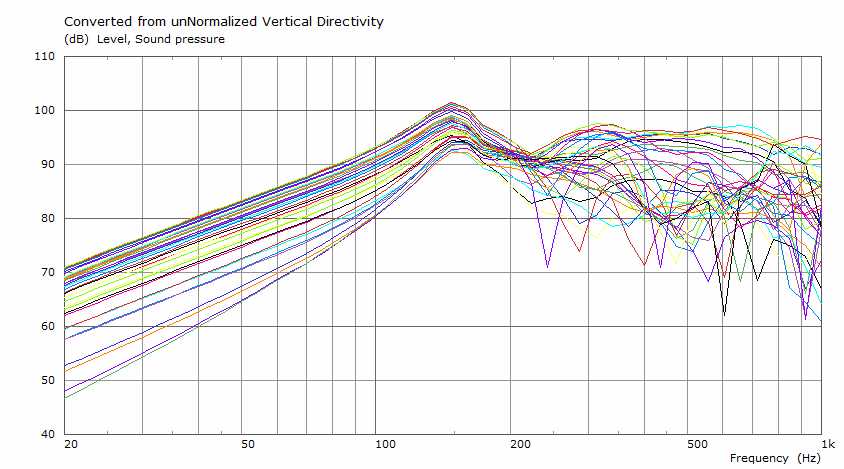

From 2 posts above, this image:
...shows the classic signs of "pinching" above the dipole peak. This occurs when the front to back pathlength exceeds some threshold (that isn't all that high). If this driver must reproduce low frequencies you are stuck with this behavior because making the pathlength smaller to reduce or eliminate the response pinching causes the LF losses to increase. Thus, you must cross this configuration over between 100Hz and 150Hz if you want to avoid the pinched region where the pattern has broadened. IMO all large-baffle OB systems will have these sort of response problems for one or more drivers in the system, and mitigating those with the crossover is tricky.
There are two related strategies that will reduce the pinching:
1. keep the source(s) - the drivers - the same and make the front to back pathlength smaller
2. keep the front to back pathlength the same and make the source(s) larger
Both of these try to make the ratio of source size to front to back pathlength closer to but not quite 1, e.g. 1.25 to 1.5 is a good range to shoot for. The smaller the pathlength the higher will be the frequency of the dipole peak.
If the band in question is the lowest one in the system, it also has to have enough output down to 30-40Hz and this requires that the source(s) are large because the pathlength can only be up to 1.25 to 1.5 times that. You can use a single large driver like an 18" or you can use multiple smaller drivers. I have built a couple of systems using four 8" drivers in a 20x20 to 24x24 inch panel, for example, and have just recently started using a system with stereo short u- or h-frames housing a high Xmax 18" driver. The 20x20" panel can operate up to about 300Hz, and the 'frame up to a little over 200Hz, limited by where the dipole peak is located and the response starts to fall into the null above it.
Once you have figured out what you want for the lowest frequency band, you then have to design the next higher band(s) in a way that delivers a good pattern for them as well. The same sort of ratio rule will apply, and this has some implications for the baffle size and shape around these drivers.

I tried just dropping a coax driver into the model by itself and what I saw at first wasn't pretty. I ran multiple simulations dropping one element at a time from the model to root cause the peaks and valleys in the rear response. Finally, I shrank the simulation down to just enough of the baffle to fit the driver, and worked on that until the response at least looked reasonable. I'm only showing some of the variations I tried in the drawing, just to give a flavor.@nc535 This is fantastic work. At some point I would love to see an integration of a 15" bass midrange in the top position of this model.
There seemed to be some combing with the floor I had in U-frame model. This is needed for woofer sim to prevent an acoustic short circuit at the bottom. It apparently is only part of the story for the midwoofer simulation. The rear wave valleys are reduced with the floor omitted; they don't disappear completely until the wings also are removed from the model. That version of the sim had what I hope is simulation anomaly showing a spike at about 1500 Hz.
Ultimately, I left this floor panel out of the midwoofer simulations because it clouds the issue. In the real world, the rear wave reflecting off this panel will be matched by the front wave reflecting off the full floor.
And of course, I had some of the usual coding errors or bad judgment calls that I found and corrected along the way.
The response is sensitive to baffle thickness and to details of the cone and magnet heights. I went back over the data sheet drawing to interpolate these dimensions with greater accuracy. Likely, the model could be improved with parameters measured directly on the driver. I settled on a 54mm thick baffle; it was incrementally better than earlier 36mm thickness results.
Next I went back to the full model and shrank down the top part of the wings to more closely resemble the BB sketch.
I partitioned the baffle into a top section just big enough for the driver and a lower section that could be modelled with a coarser grid as simulation time had grown quite a bit.
Here is what I simulated:

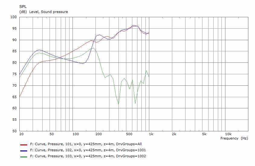

Here is its SPL response. Its still not pretty but it looks useable and might even be reasonably accurate below 1100 Hz. In any case, its what the model predicts.

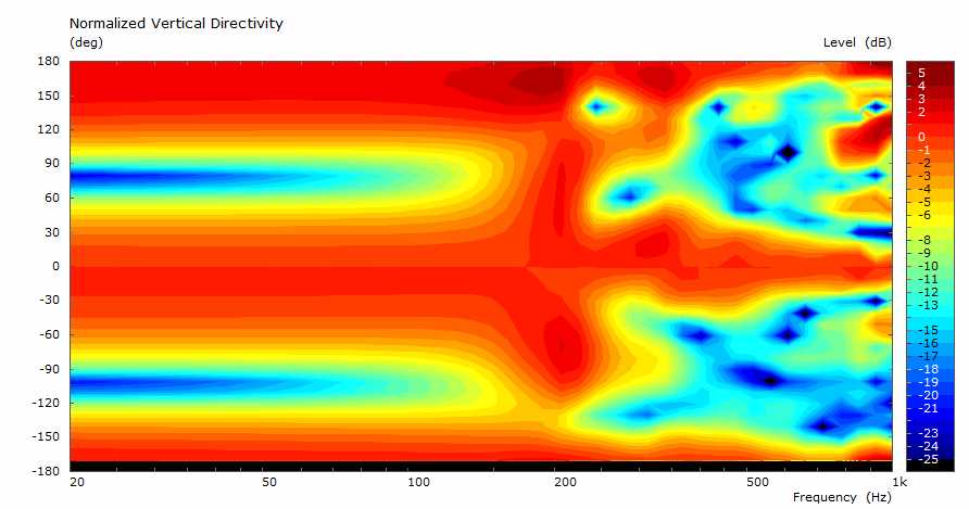

Here are the polar maps and curves derived from them:

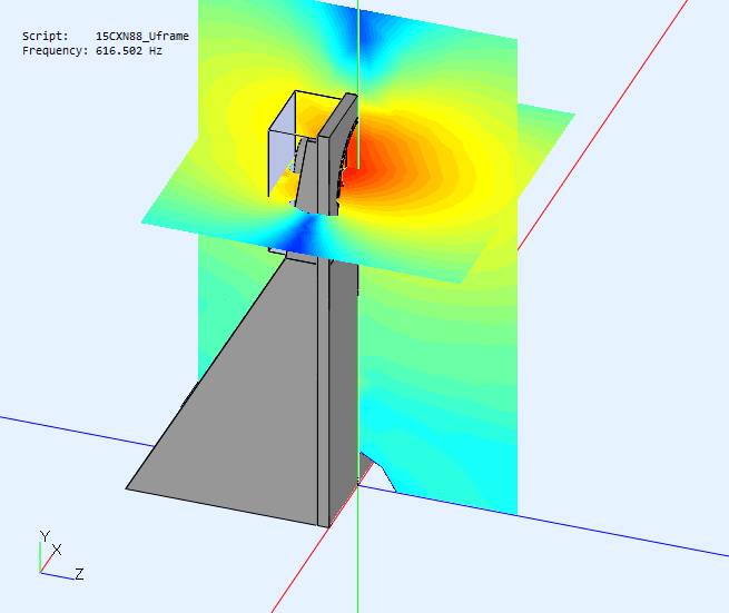

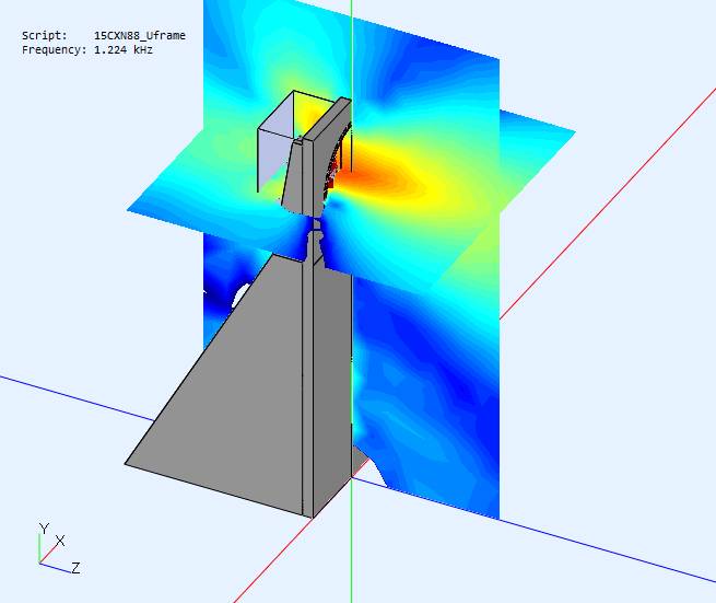

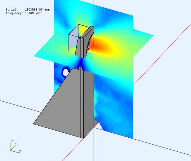

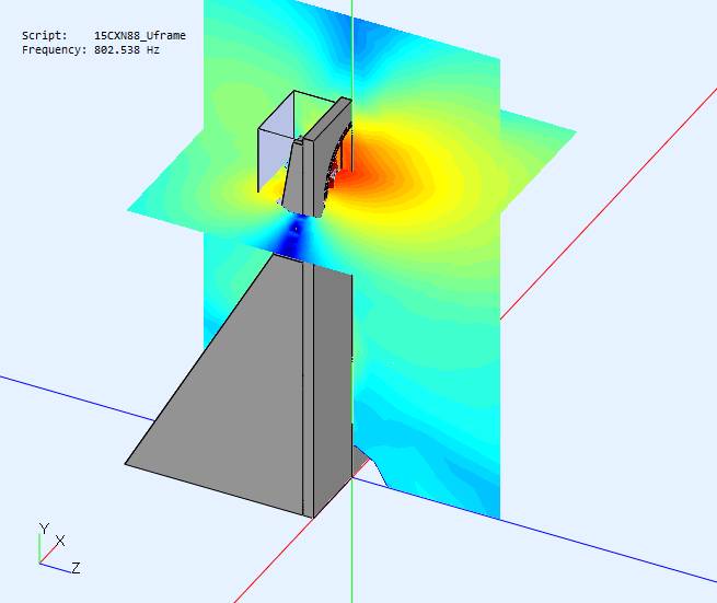

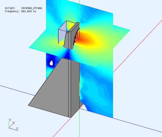

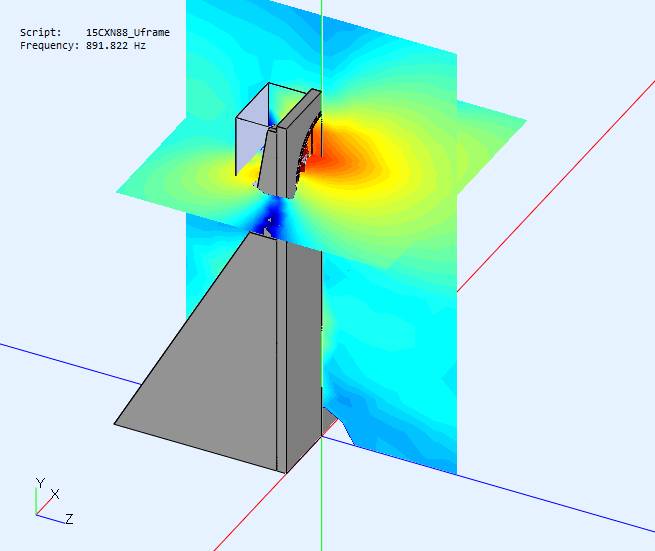

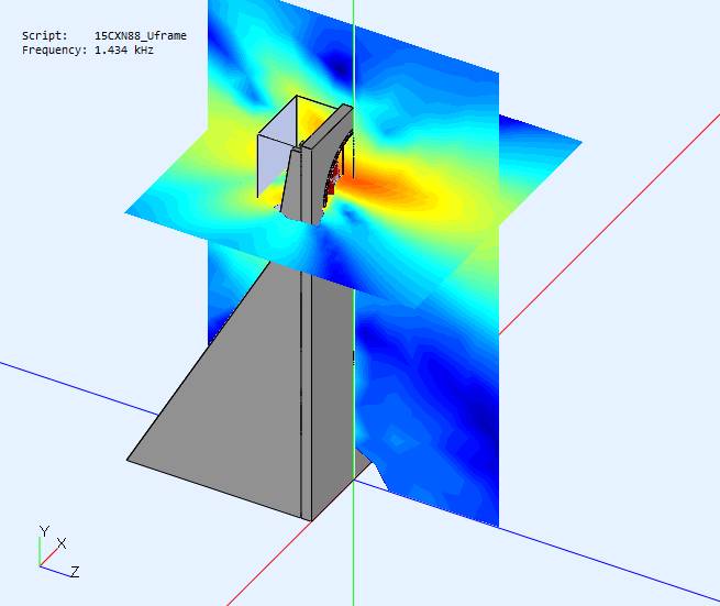

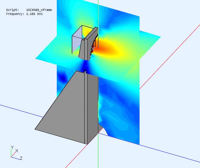

This sequence of field views shows the midwoofer response changing over its operating range.
Deep side nulls are present until about 800 Hz and then start to bend forward. At the same time, the 15" cone is starting to beam, which likely is the cause of the bending forward of the side nulls.
Looking at the 1100 Hz fields, we see nulls being bent forward towards the ceiling and floor, which may be a good thing. This narrowing of response doesn't preclude a transparent crossover to the CD/tweeter because it is has the same directivity.

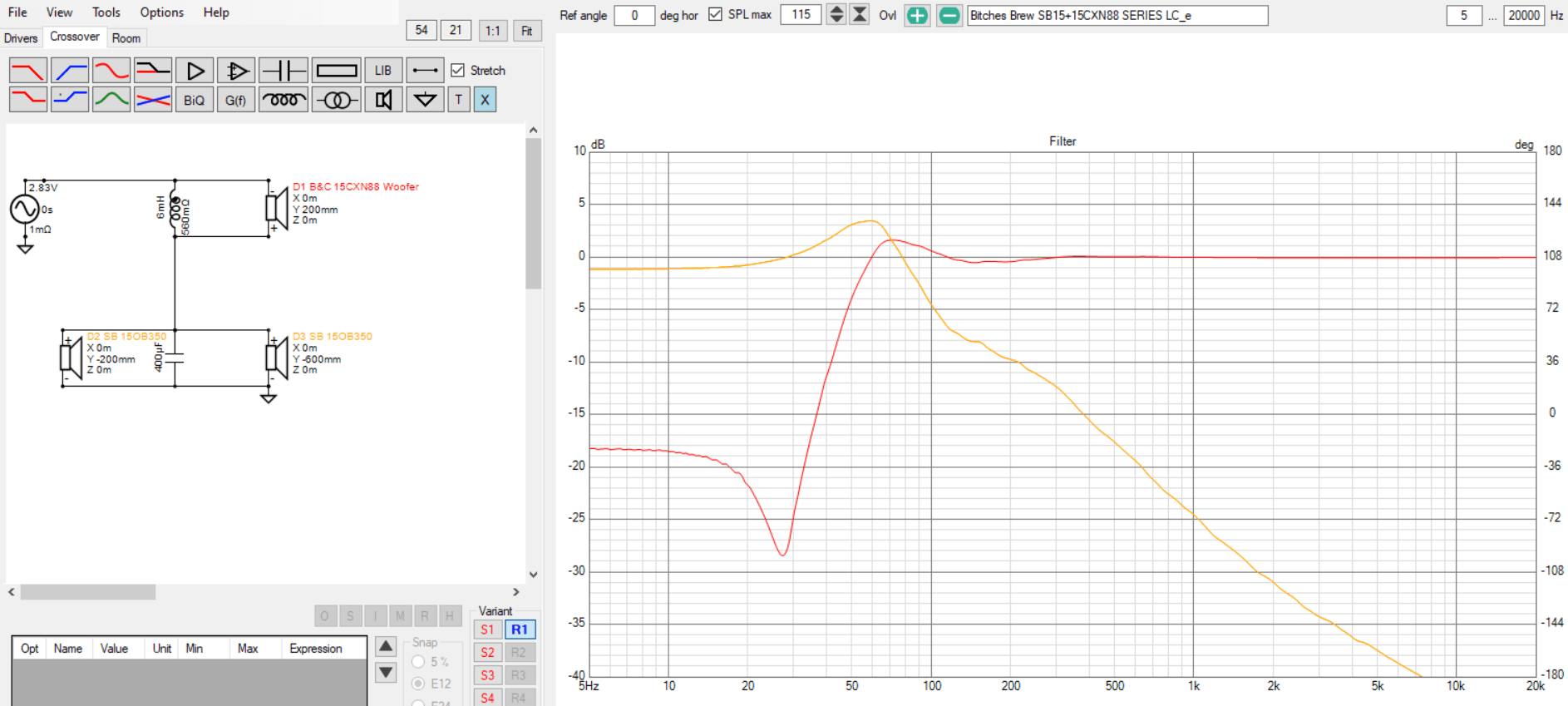

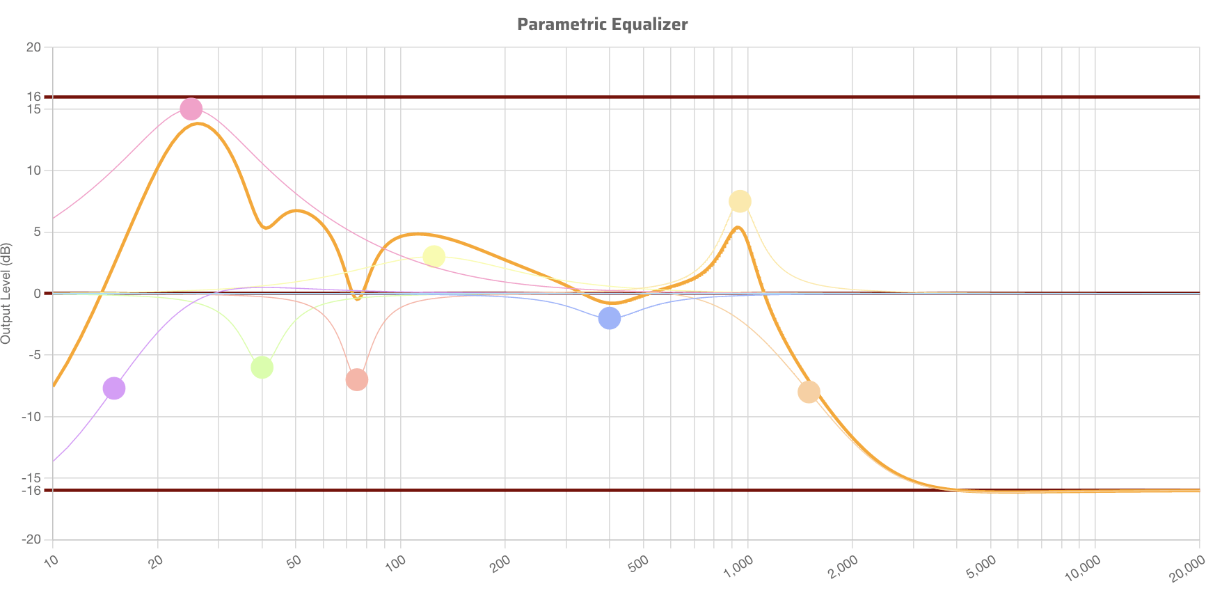

There's a reason the crossover is at 1100Hz, in fact the woofer drive signal has a peak built in at 900. Here is the Flex Eight EQ curve for the bass-mid section:
The notches at 40Hz and 75Hz fix modes in my room. Notice the filtering above 1100 is a high shelf filter, not a traditional crossover slope.
And below are VituixCad sims of the series crossover:
