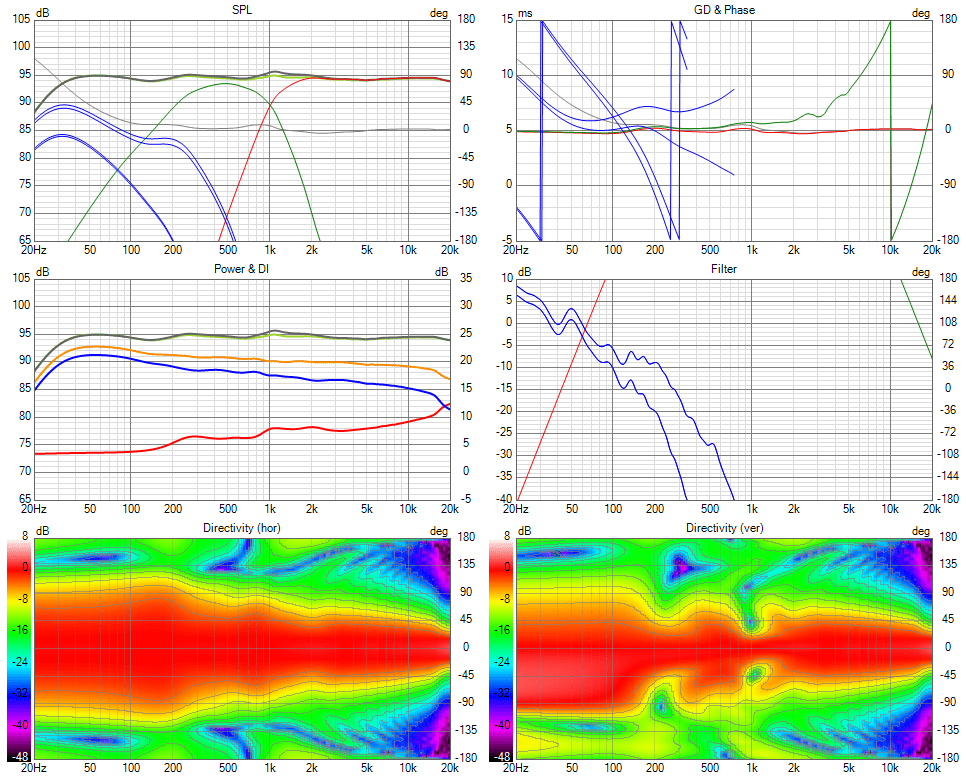

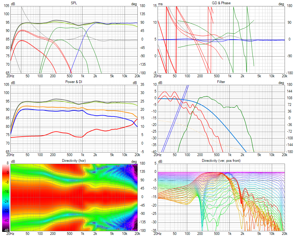

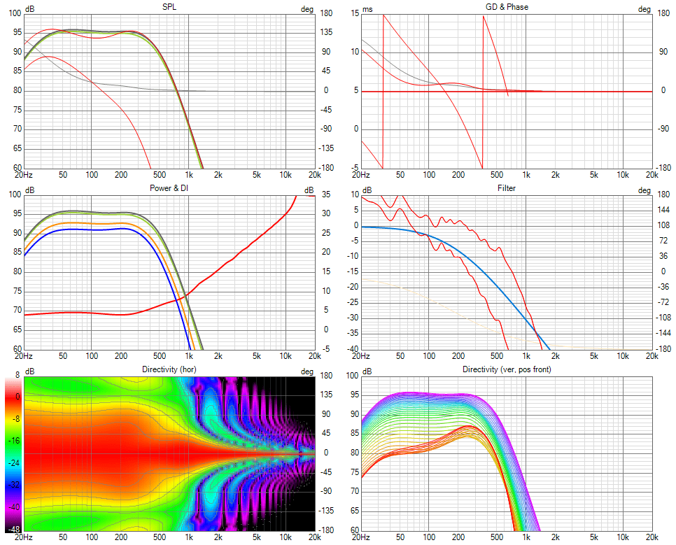

On the graph below, bottom panel is raw 4ndf34's on syn10, next up is raw impulse.
Top two panels are the processed 250-750Hz bandwidth currently being used.

I've been finding that steep (lin-phase) xovers do a great job making out-of-band box reflections, like the 4kHz spike on the raw response above , a non-issue.
Processed response is down by -60dB before 1150Hz....4kHz is bound to be off the radar.

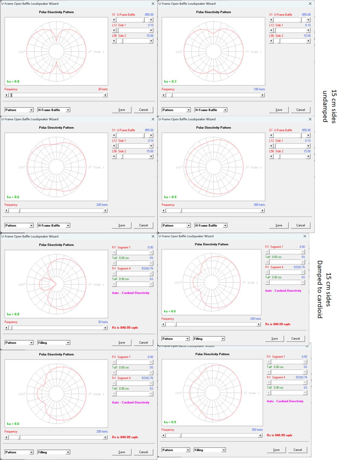

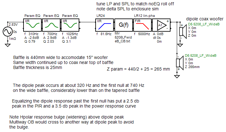

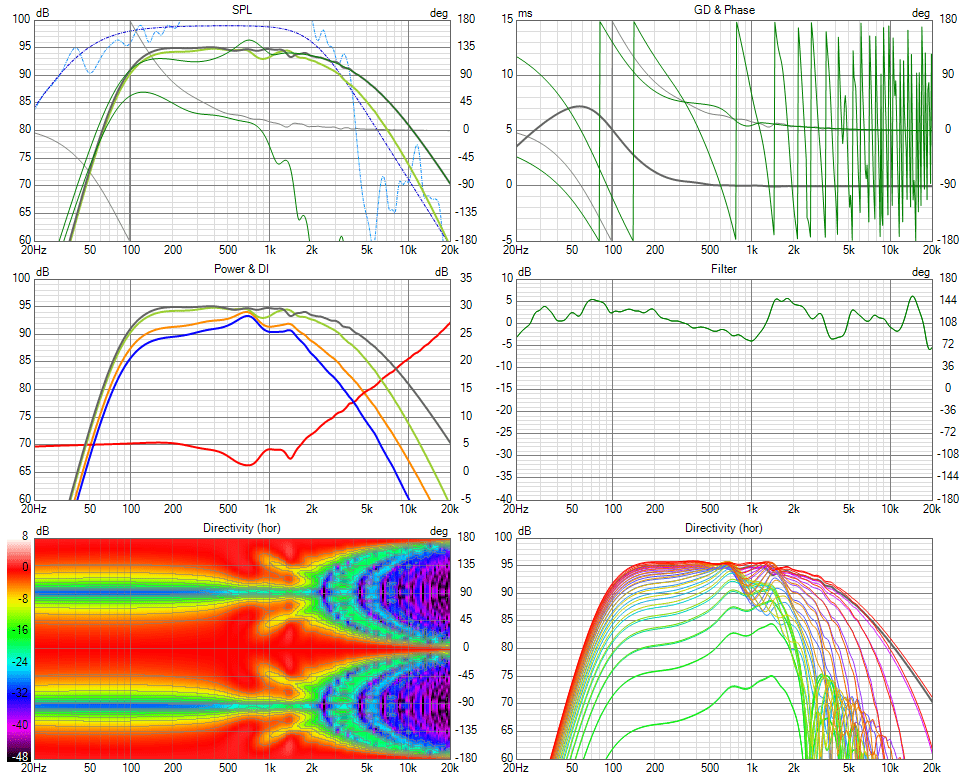

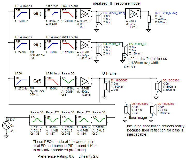

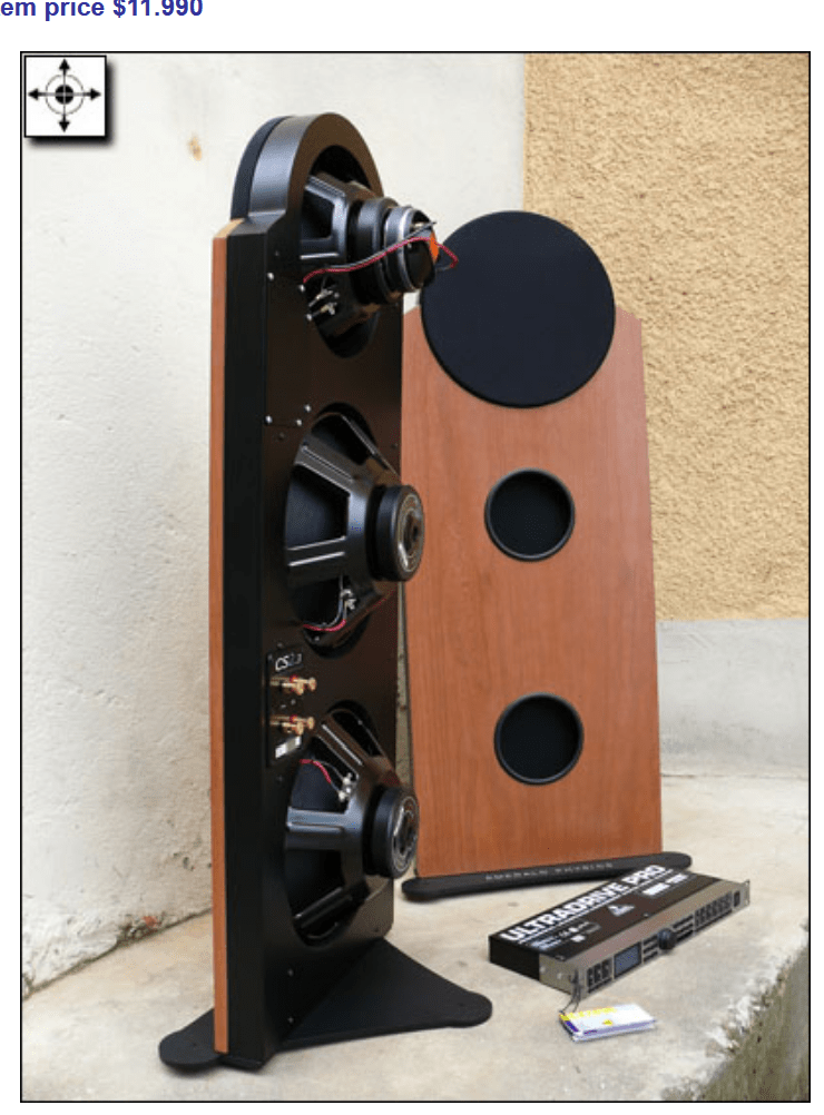

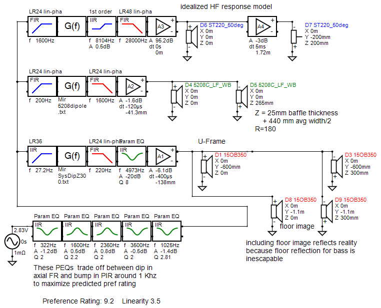

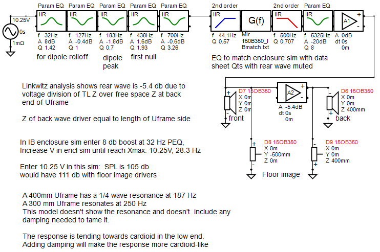

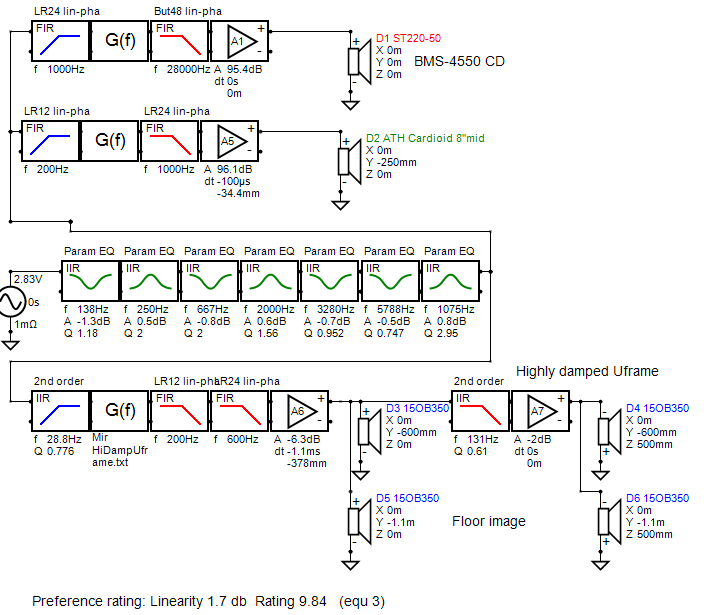

The 15OB350 has been scaled down to 12OB150 high in a shallow Uframe, high passed at 100 Hz to a 12" slot loaded down firing sub at floor level.

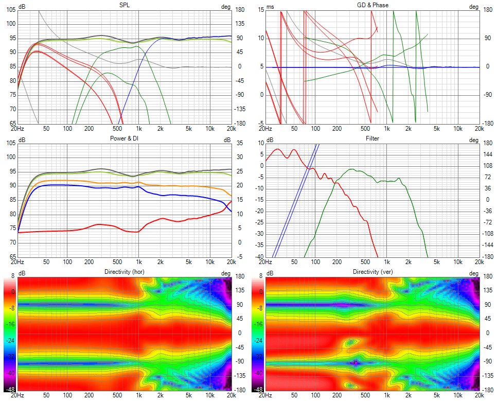

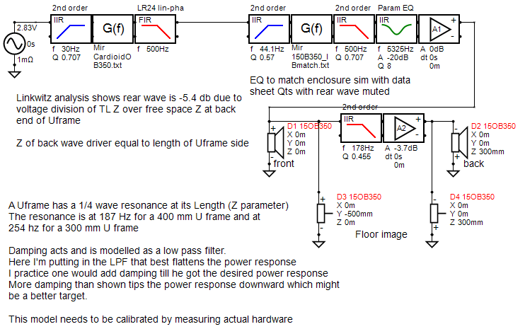

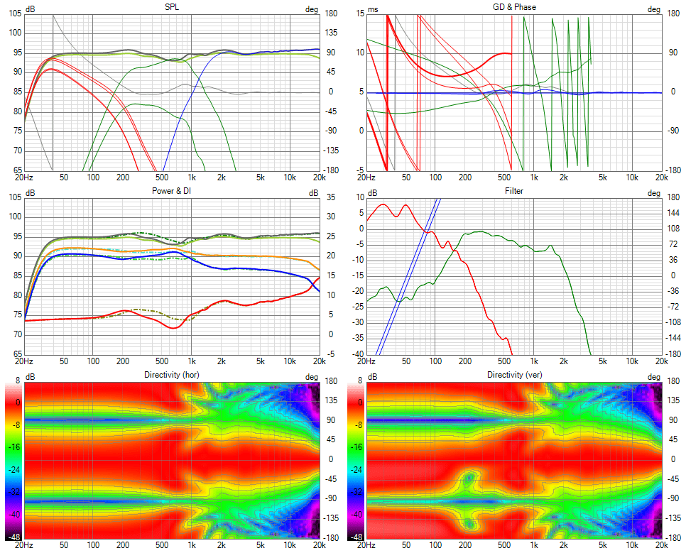

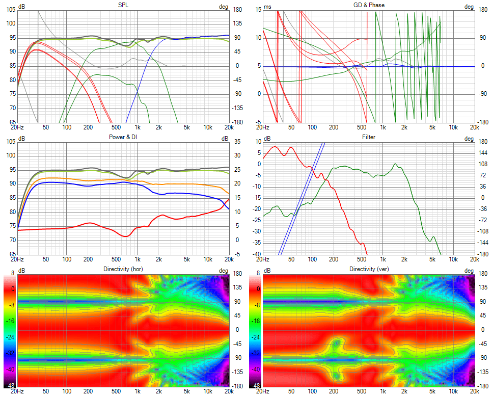

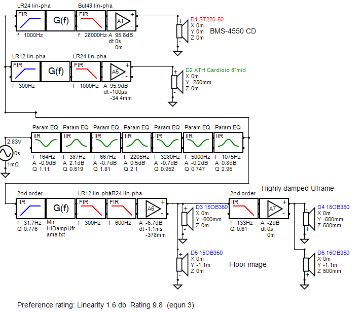

That also doesn't fit my rooms, so I'm back working on a cardioid. My current favorite is this, which can be placed right up against the front wall with its center as close as 500 mm to a side wall.
It uses the same 5208C Radian 8" coax passive cardioid above an active cardioid consisting of an 8" front woofer and 2 8" side subwoofers. It will be less than 6 db down at 25 Hz in room and cardioid-like from 80 Hz up. A quad class D amp is in the stand and EQ and XO using Camilla DSP in a Rpi4 with Motu UltraLite Mk5 for a DAC.
