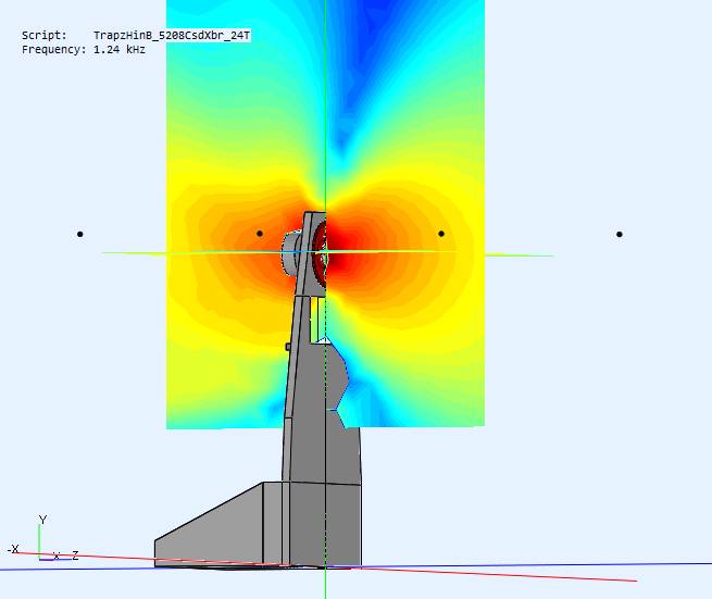

I think the frequency range where these details matter is about 800 Hz ++. In my 5208C modelling, I'm seeing peaks and valleys in the rear wave, not matched by any in the front wave, that I have to ascribe to interactions between the magnet structure and the rear of the baffle. I really hope someone will do a similar post for the 5208C.

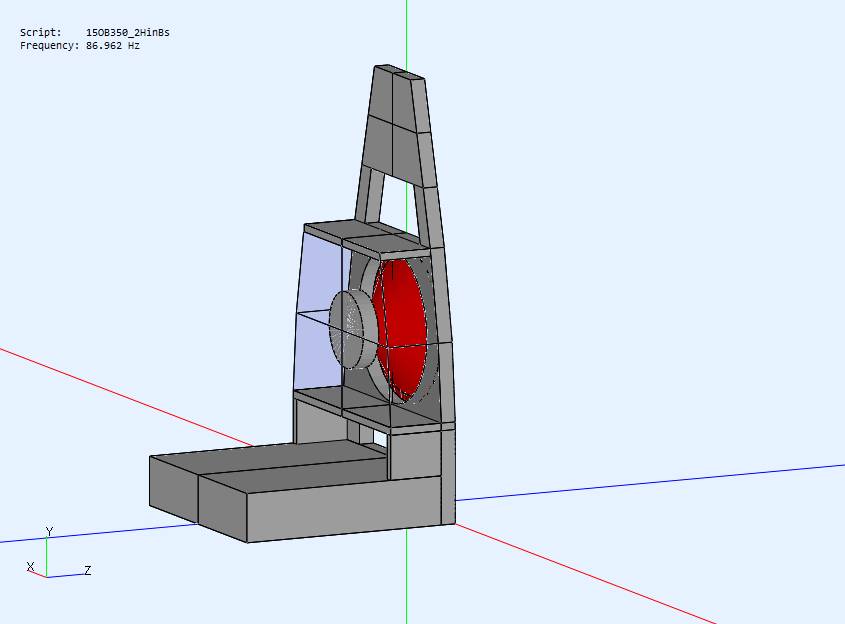

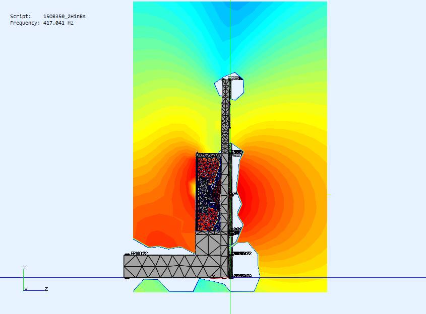

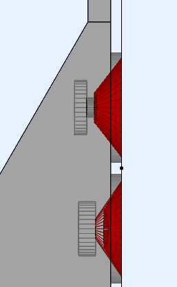

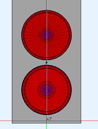

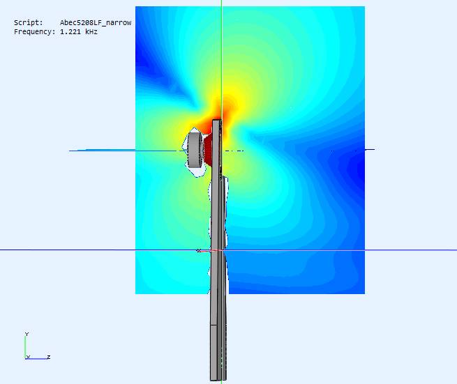

When I first modelled a tall tapered baffle with a Coax mid on top, I got a vertical response that was tilted downwards. This is 1221 Hz:
this is obviously unacceptable. I saw two alternatives. One was to mount the coax on a small baffle separated from the woofer baffle sufficiently to allow cancellation to occur below it. The other was to cut a hole in the baffle between the woofer and coax driver. I tried both choices and the hole in baffle worked best. Here are the 1239 Hz fields:
Unfortunately, the hole in the baffle above the woofer unbalanced the woofer's vertical response:
the tilt isn't so extreme but it added to the vertical dip at XO between the woofer and the coax mid circa 400 Hz so I felt I had to do something about it. My goal is a speaker that can be listened to both seated and standing, albeit at a greater distance for standing.
Thus I ended up with two holes in the baffle, a nearly level V pattern,
and a horizontal pattern with side nulls remaining past XO to the coax mid, although not as deep as at lower frequencies

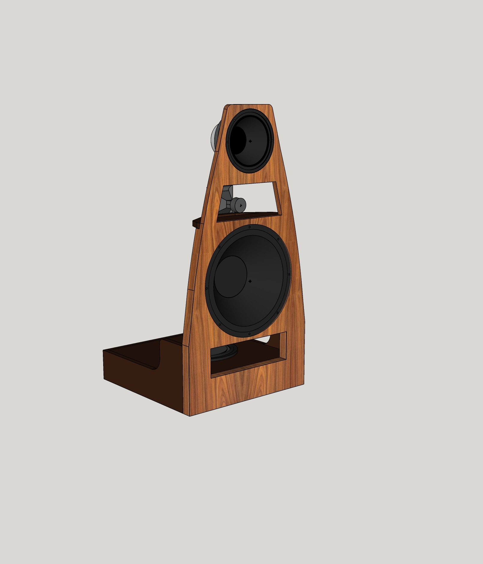

This is what the baffle model looked like at that stage:
I had added cross braces above and below the woofer because I didn't want the HinBs to be acoustic short circuits for the woofer. I ended up in a tug of war between the coax mid and woofer for the upper cross brace. The woofer response was best with a deep brace; the coax response was best with a shallow brace.
I got a really nice system response in Vituix exporting directivities for a 100mm deep brace. The olive dashed trace below is the in-room response with wall and floor reflections enabled, 30 deg toe in, 1m from each of front and side walls.

The holes in the baffle presented me with an aesthetic problem
the best I could do is hide them behind grills:
to my eye, this works fairly well for rosewood veneer and dark rose grill cloth, assuming I could find some, but falls short when the grill needs to be brown to coordinate with the wood:
I believe that form should follow function, but perhaps not quite that far.

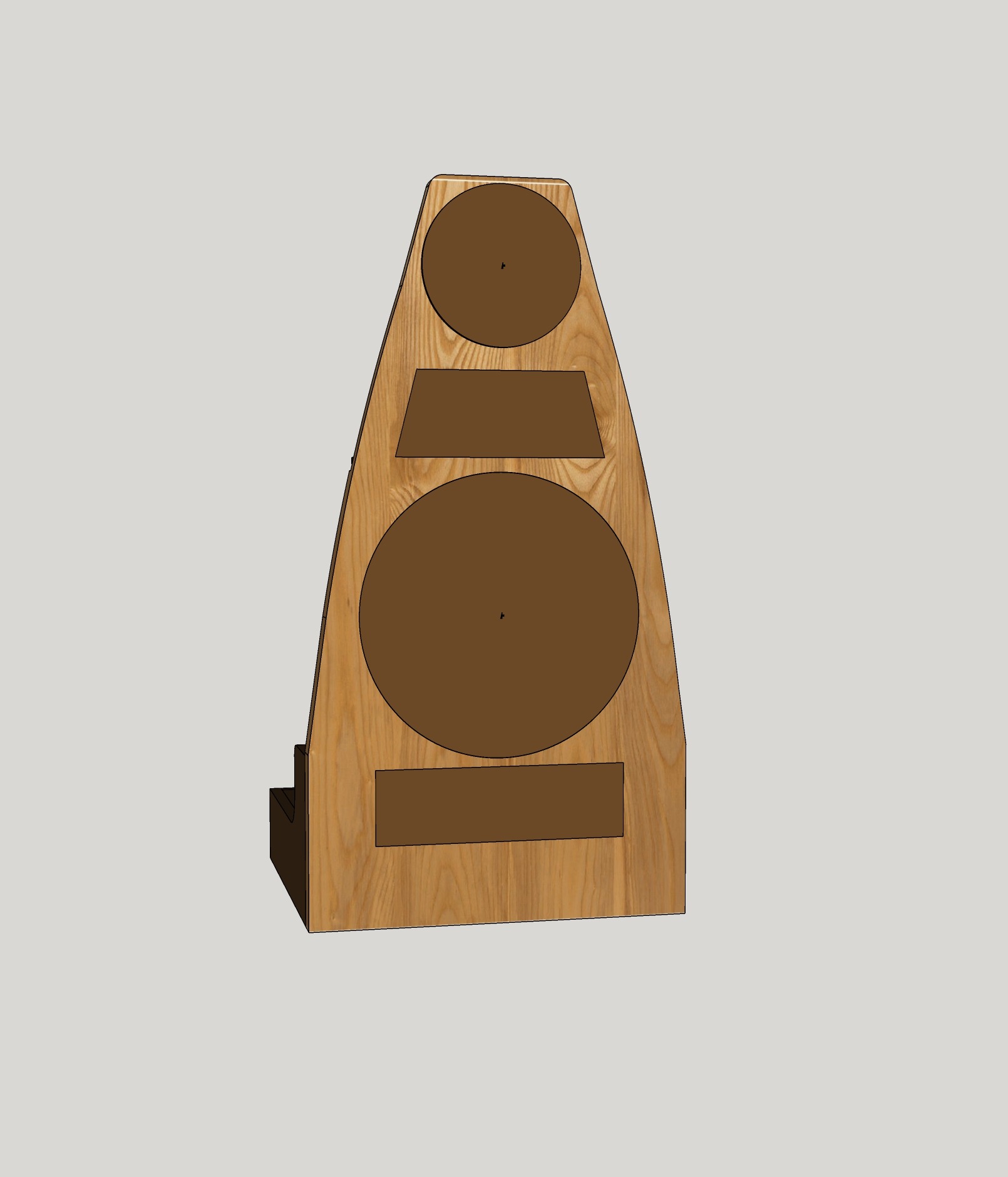

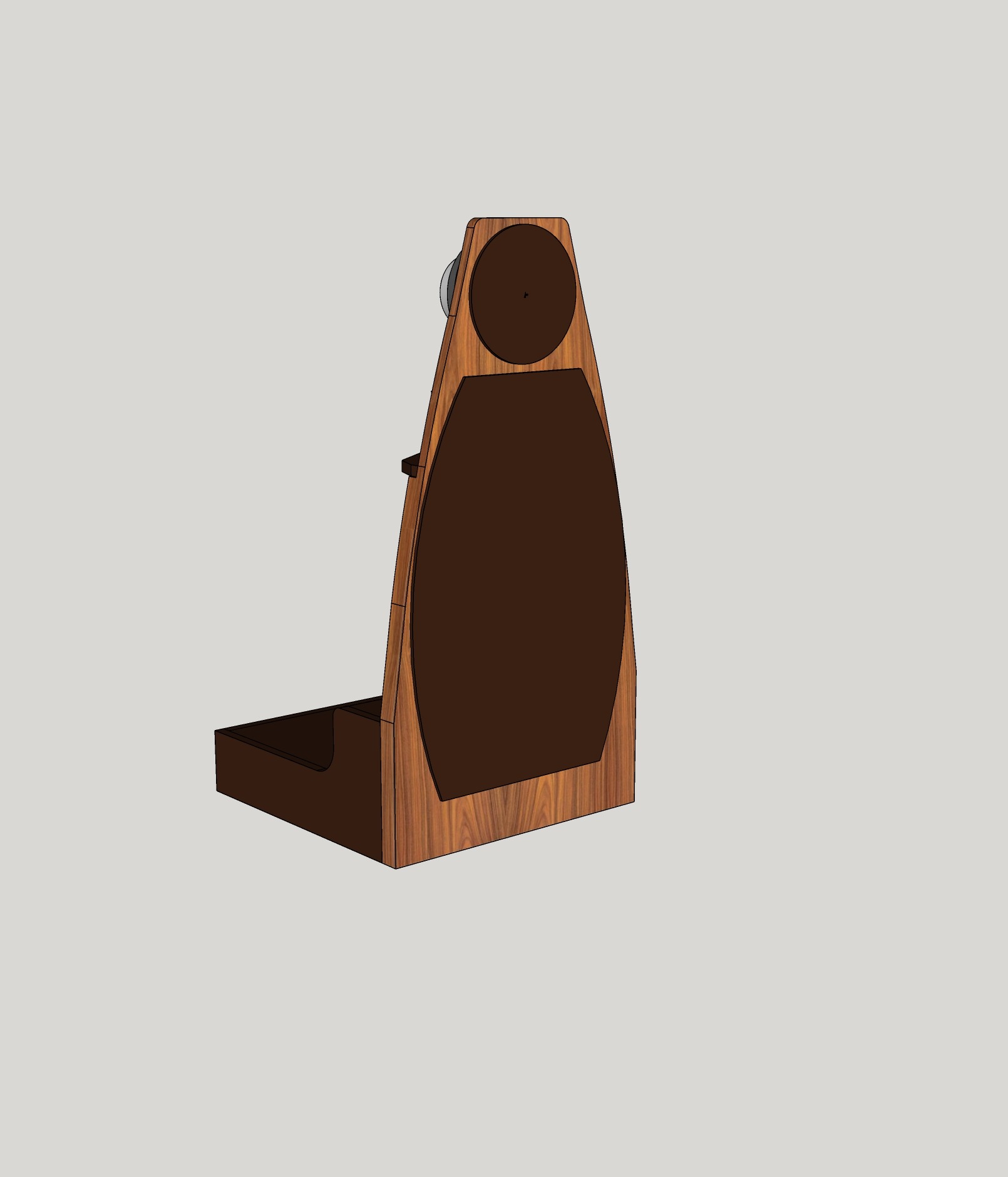

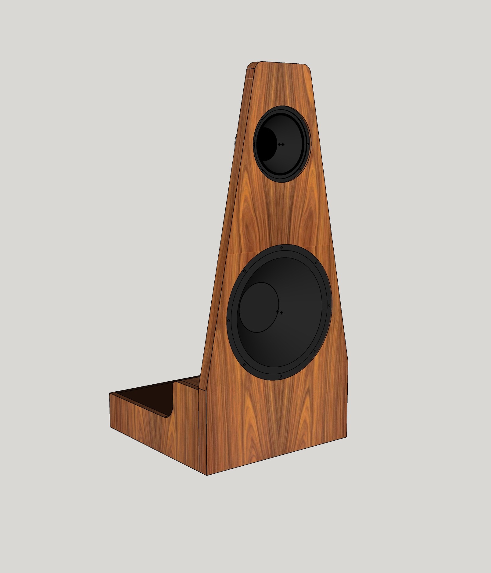

Pondering this dilemma, I belatedly had the idea to extend the baffle above the coax driver to straighten its vertical response, instead of cutting a hole in the baffle below it.
That brings me to this morning's work, still a lot to do but this is the concept

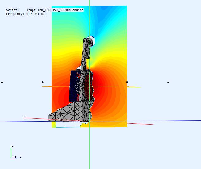

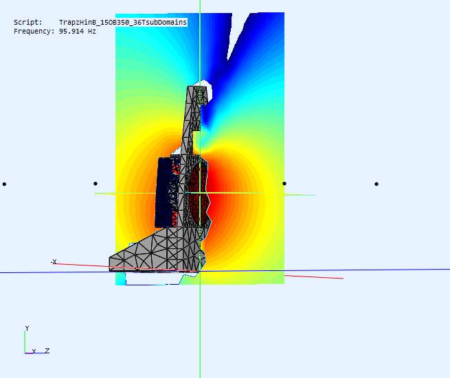

The fields images for the woofer with single hole in baffle fell out of the long post prior to the one above. Here ithey are
for 417 Hz and 96 Hz

I'm going back to the version with the sloping rear baffle , as shown in the abec fields drawing in the post just before yours as opposed to the flat, up facing sub shown in the renderings. Believe it not, I was getting reflections from the coax midwoofer off the flat sub. I believe they will be dispersed by the sloping rear.
The sealed 12" 14mm Xmax rear sub crosses to the dipoles at 80 Hz, making this a full range speaker without subs, not to say that additional subs wouldn't help in room. Since the 15OB350 only needs to go down to 80 Hz instead of 30 or 40 Hz, it needs 1/6 less displacement and is in fact power limited rather than excursion limited. Since the sub is there, the 15OB350 doesn't really need any help from the floor.

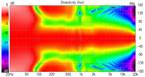

The predicted H polars look like what others have shown for the combination of a sealed and dipole woofer: There is/will be a rear facing tweeter that isn't modelled here. There is an off axis null circa 1 khz that I'm investigating.

I'm being conservative in setting the XO points. My estimate says the 15OB350 dipole can go down at least to 80 Hz. It depends on how loud I want to play and how it sounds and how linear the driver is near its Xmax. I'm also being conservative in setting the high pass on the 5208C at around 360 Hz, but I'm also choosing it so that there is overlap with the woofer around the floor reflection null.
My double 15OB350 U-frame simulation predicts 100 db SPL at the dipole peak, 2.83V 1m. That is 10 db higher than my single 15OB350 dipole. How much does your 30 Hz crossover have to be raised to compensate for having half the volume displacement, and starting its rolloff at 400 Hz? Raising the XO just to 60 Hz means that 1/8 the volume displacement is needed. A single woofer then uses 1/4 the excursion at the same drive level but produces 6 db less output?
Perhaps 60 Hz XO is feasible. I will have to try it and see.
There is another aspect to this. Depending on how the sub is phased relative to the dipole and on whether or not there is any overlap between the two drivers, you can get either a pure dipole response down to an XO to the sub or a cardioid-like response around the crossover or through an overlap region. There is an opportunity there to tune the directivity there reduce boundary interference. The Vituix simulation does show a boundary null near 100 Hz that has been reduced to a 3 db dip this way.
My driver lineup is 5208C, 150B350 dipole (not U-frame), BM-11 shallow mount sealed sub. When the design settles down, I expect it to be almost a foot shorter than the Bitches Brew, half the width at top, and to have depth only at the lowest 10". I hope that is not as big as small refrigerator. Its more like a speedskater compared to a football lineman. Both have a solid base, but their upper bodies are completely different.

I relate the data of Figure 14 to OB/dipole systems in the following way:
A true dipole system has constant directivity, and therefore also has a constant power response.
The in-room steady-state response reported by Olive and Toole will be very similar to the power response of the loudspeaker and is not flat!
This is the same result you see time and time again from Klippel testing of loudspeaker e.g. see Erins Audio Corner, reported as the estimated in-room response.
Therefore some equalization/correction of the dipole should be made to better mimic this response. Above 100Hz I do this via EQ of the input signal to "tilt" it down.
Below 100Hz we can obtain the "bass bump" for free just by crossing over to a monopole. This is because a monopole radiates 4.75dB more power into the room than a dipole for the same on-axis SPL.
So I just cross over around 80Hz to a sealed sub. The power response will naturally rise through the crossover point by almost 5dB, exactly like the preferred listening curves from Olive. The monopole sub can also deliver a better low bass response and room pressurization at very low frequency.
This also greatly reduces the demand on the dipole woofer, which now only needs to work well down to 80Hz. By reducing the LF requirements the dipole loudspeaker can be made physically smaller, or use a smaller woofer(s), etc.
