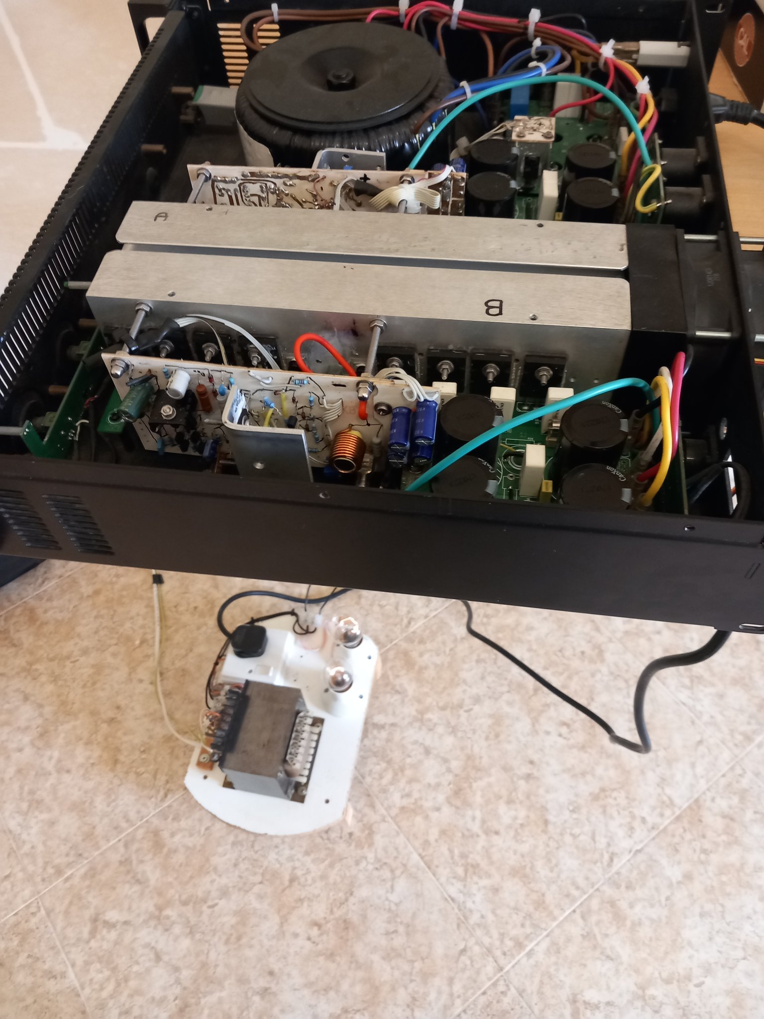

The first amplifier module is ready from the VBE Multiplier modifications. Testing it with a feeble split power supply, has shown it is underbiased. The bias current per pair is too low. Notwithstanding of all this, when a signal was applied it amplified a music signal without any noticeable distortion. I expected to hear the harhness of crossover distortion, but I didn't. Irrespective of playing these particular music tracks corrected, I am still intent on biasing it correctly at around 12mA per pair. There are four pairs, {2SC5200, 2SA1943}, which contribute to a collective bias current of 48mA. Across a 0.1Ohm resistor this has to result in a potential difference of 48x10^-3*0.1 = 4.8mV.
As the amplifier module is combersome to work on, I will apply an extra resistor in parallel with the 590R base-emitter resistance. This will increase the multiplier voltage.
You don’t need very much bias current at all to get rid of immediately-obvious crossover distortion. A couple of mA and it goes from sounding like a mistuned FM radio to “clean”, but going to 20 or 30 mA will improve the overall spectrum. Also EF3’s can get away with significantly less bias than EF2‘s for a given amount of crossover distortion.
The output stage of this amplifier is of CFP type. The driver stage is a push-pull stage feeding resistors at the rails. These resistors provide the driving voltage for the output pairs. All transistors in the output stage have 0.22R emitter resistors.
Using two additional signal diodes and a resistor, the bias current should be more readily controllable. In fact, I can say, this has been achieved as I can control the bias current to the nearest milliampere. However, I do not know how the bias current will vary with temperature rise. The simulations show it should not be very high compared to lower temperatures.
I think that wg_ski's post #34 hit the nail on the head. The CFP output transistors just add current gain to the driver transistors. You want to stabilize the driver transistor current. The Vbe multiplier should be near the drivers. Remove D10-12. R21 and R24 are too small for good thermal stability. These should be in the range of 0.22-0.33 ohms.
Since you have run simulations, you know the range of bias currents. You only need to ensure that the lower end is at or above the optimal for lowest distortion, and the upper end is far away from the maximum allowable dissipation.
Ed
The solution to get a better bias current through the output transistors was to decrease the 590R resistance to ~540R. Now, the cumulative bias current for four output transistors is 48mA. This means every transistor in the ouput is consuming 12mA. Since, this channel passed the test, I installed it back inside its amplifier box and did the bulb test at 120V AC mains voltage. In am in the EU with a mains voltage of 230V AC. As I will most probably never need the amplifier full power output, I will use a much reduced 'mains' voltage. In fact, I have a step down transformer fitted in an insulated box with an output of 48V AC. This is more than enough for my needs. I have discovered like some people on these fora, that even 1W RMS is loud in a home environment.
Please be aware, this amplifier is a substantial modification of the Wharfedale S1500 amplifier and I do not have a lot of space to do whatever I decide. Modified and working with a rail voltage of around 12V DC: this amplifier already gave me more than a year of good service. I re-opened it because it was showing signs something was wrong and I knew the VBE multiplier pots were low quality and could be failing. This change also improved the total hormonic figure by a factor of around 10. The original circuitry had a THD of 0.5%. Now it has around 0.003%.

Finally, all the changes have been implemented. One channel has a DC offset just below 1mV and the other around 10mV. Maybe the differential pair were not from the same batch. I did the filament bulb test for both channels installed in their amplifier box and using the amplifier power supply. The stability of the filament yellow-orange glow shows the bias must be stable.
