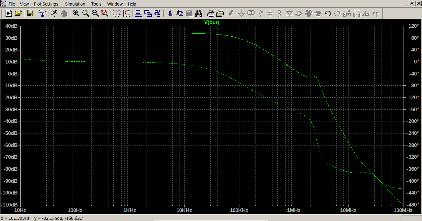

Using more simulations the Miller Compensating Capacitor was increased to 180pF. This produces a gain of 0dB at 2MHz. The distortion figure does not seem to be affected by this increase. The input voltage was set to 1 V (peak value) for convenience.
The attached LTSpice screenshot shows the AC analysis. Comments are most welcome as changing the value of the Miller capacitance profoundly affects stability.
Note:
I am going through all this, because, I need to know what parts to order, so that I include them in one order preferably from the same supplier.

Ed, if extending the bandwidth does not increase the available gain at up to 20kHz, there is no change in distortion.Using more simulations the Miller Compensating Capacitor was increased to 180pF. This produces a gain of 0dB at 2MHz. The distortion figure does not seem to be affected by this increase. The input voltage was set to 1 V (peak value) for convenience.

In such a case, extending the bandwidth may not be a good thing. Think opening a window further - more junk flies in.
Jan
Thanks for the advice. Extending the bandwidth into ultrasound and radio frequencies is riskky as it asks for more instances of instability through difficult to detect parasitic paths. I increased the Miller Capacitance erroneously as I was too tired with repeated simulations. There is no need of increasing this crucial capacitance.jan.didden said:Ed, if extending the bandwidth does not increase the available gain at up to 20kHz, there is no change in distortion.
