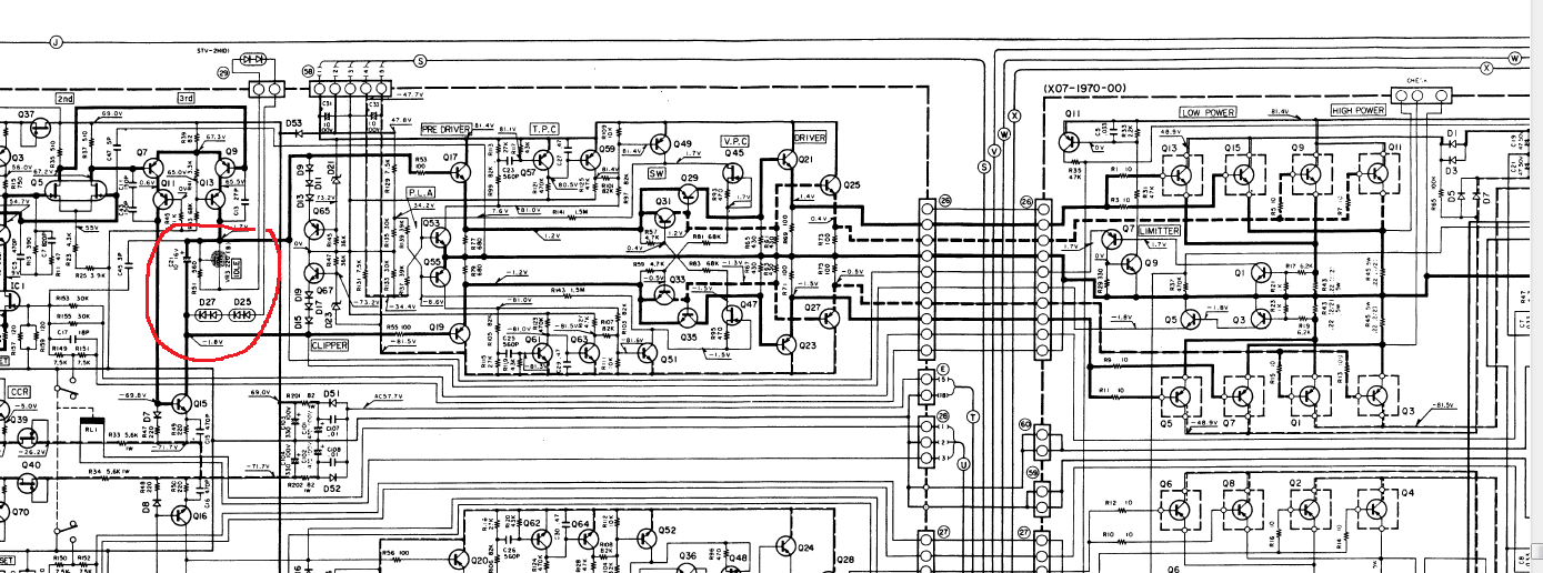

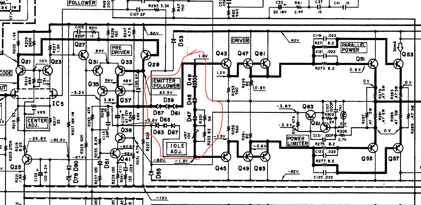

A classic diodes+pot configuration is the original Dan Meyer Tiger amp. There's a schematic if you scroll down a bit here- https://www.diyaudio.com/community/threads/swtpc-universal-tiger-rebuild-for-analysis.344966/ My experience is, over time, pots are way more prone to failure than diodes or transistors. IMO, the pot should always be shunted so amp current is limited if the pot goes open. Sound-wise, I think either multiplier or diodes can work well, especially if you can find some old 1N3754 metal case diodes or similar to get good coupling.
That means diodes can do the job satisfactorily. What diodes can I use apart from metal cased rectifier bridges? An underbiasing chain of two diodes in series plus a low resistance pot should do the job.my replies don't support vbe multipliers for high power amplifiers at all..
