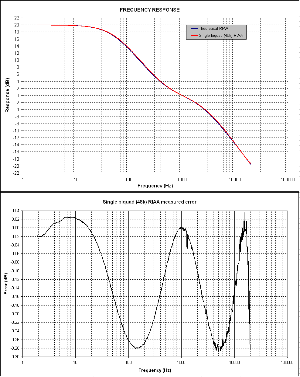

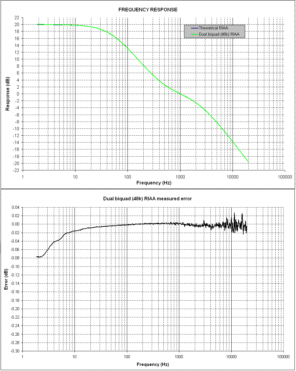

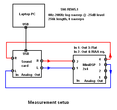

Also did you try the dual bi-quad at 48K which should be almost perfect?
Yes finally.

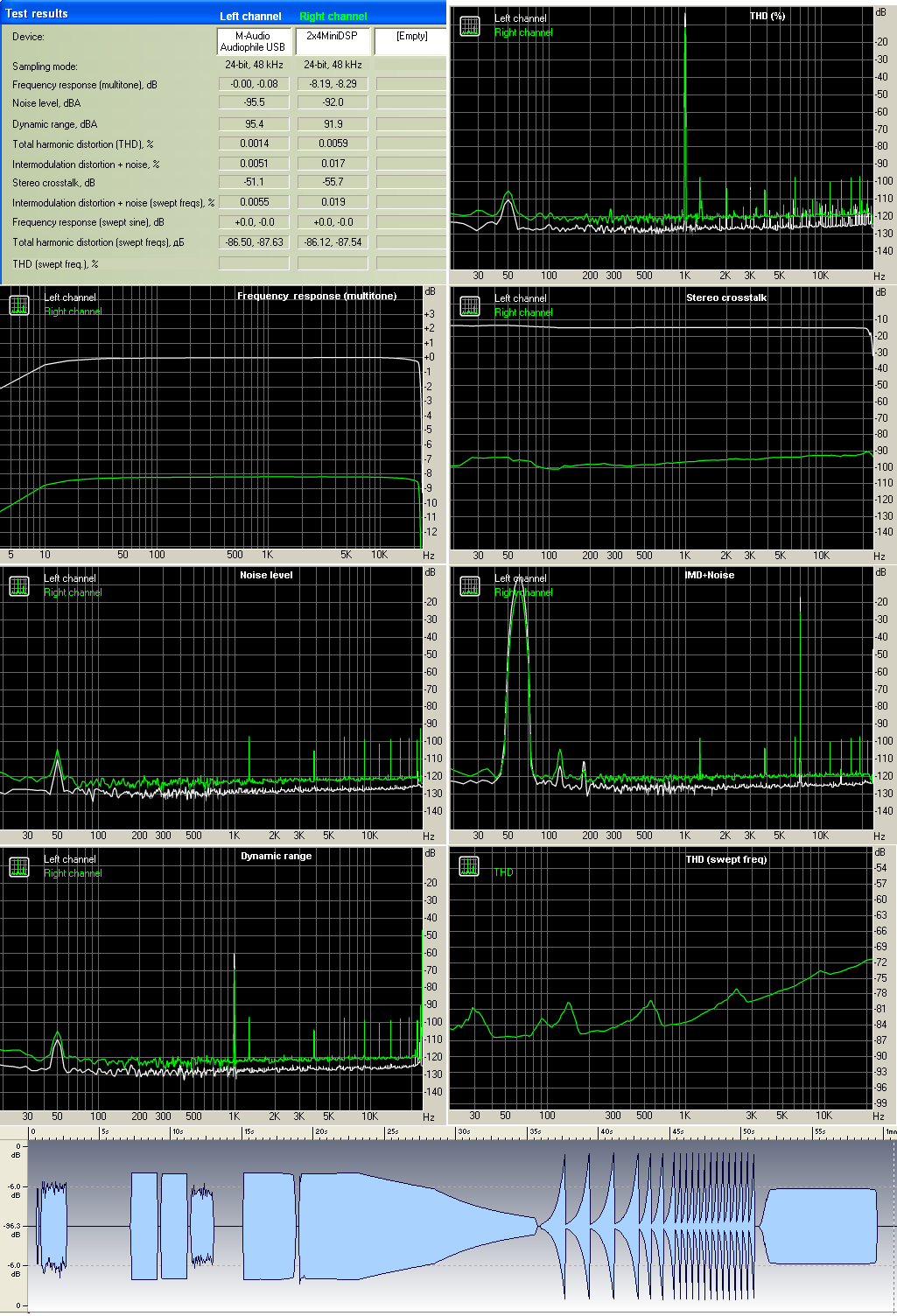

Here are my measurements at the output of my 2x4MiniDSP.
First attachment: The freq response rel 1KHz from the two biquads in isolation (in blue the theoretical RIAA curve)

Second attachment: The freq response rel. 1KHz of the resulting dual biquad (48k) RIAA (the two above biquads cascaded) and the error.
Third attachment (for comparison): The freq response rel. 1KHz of the single biquad (48k) RIAA and the error.
Single biquad RIAA (48KHz) coefficients:
poles = [52.5257285337, 2287.22026941]
zeros=[21833.6972506, 536.805364274]
a coefficients = [ a0=1 a1=1.73273489 a2=-0.73451925]
b coefficients = [ b0=1 b1=-0.75549731 b2=-0.16463057]
Gain at 1kHz = 13.16179286 dB

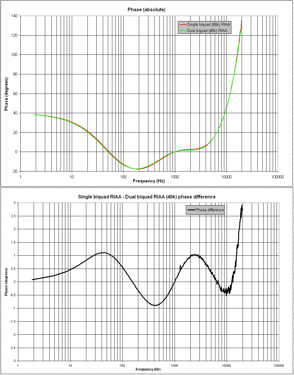

Forth attachment: The phase response of the two (single and dual biquad) RIAA implementations.
Fifth attachment: Measurement setup (*)
Errors of both -all digital- RIAA implementations are within the limits that Scott has mentioned in his LA vol. 10 article.
The dual biquad RIAA having ridiculously small error wins the competition.
All the coefficients shown above, have been copied from Jan’s site download section with no other change except from the sign reversal of the ‘a’ coefficients.

(*) The description of how I performed these measurements is to be found in post # 294. The procedure is exactly the same, I only have lowered the resolution (652 data points per measurement)

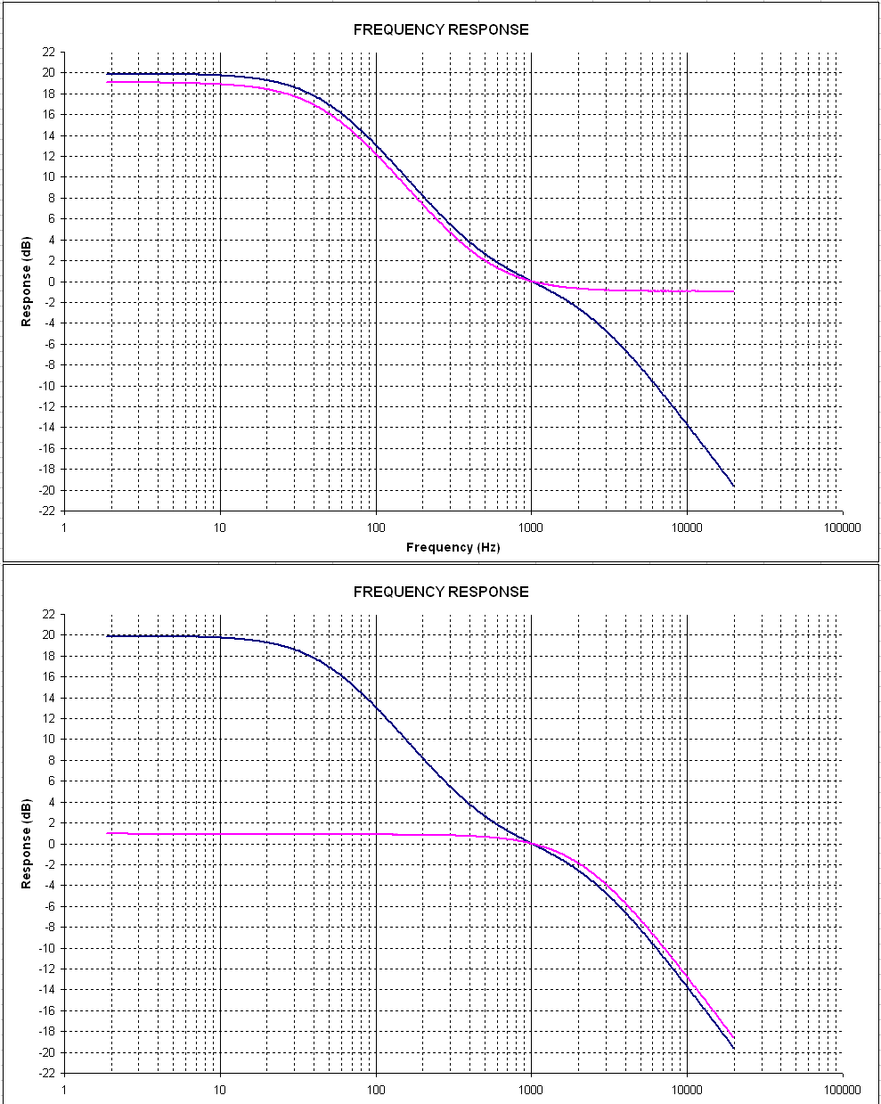

The residual low rolloff is probably the AC coupling on the miniDSP.
Yes, the insignificant drop (-0.09dB at 20Hz, -0.016dB at 10Hz, -0.037dB at 5Hz) most probably is due to the imbalance btn the hardware of the two channels of the measurement setup chain (soundcard+2x4MiniDSP).
The results shown are R channel (RIAA eq) minus L channel (flat) because the intent of the exercise was to test the performance of the algorithms and the DSP part of the 2x4MiniDSP only.
This means that the hardware constrains common to both channels like low freq and high freq roll off don’t show up except when there is some small difference btn the hardware of the two channels.
In actual use, the operation will not be R channel minus L channel, therefore the frequency roll-off due to hardware will be as expected more pronounced:
2x4MiniDSP:-0.27dB at 20Hz, -0.56dB at 10Hz, -2.38dB at 5Hz)
Soundcard: -0.21dB at 20Hz, -0.48dB at 10Hz, -2.11dB at 5Hz)
Attachment: Testing 2x4 MiniDSP.

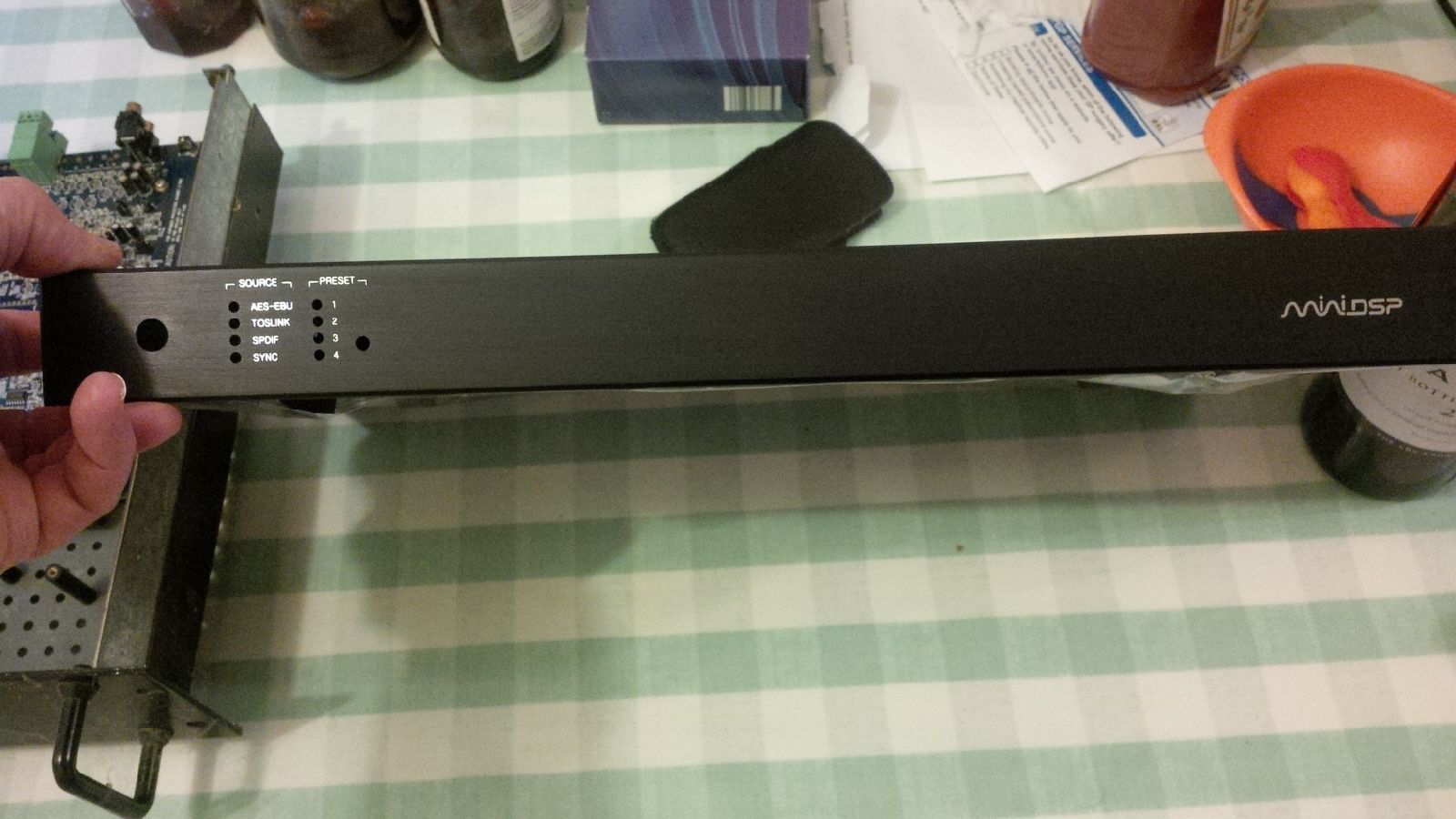

George, you really have done all the homework to make it easier for the rest of us.Thank you I am embarassed to admit my miniDSP has been gathering dust for 2 years now. Mainly because i made the false economy of not spending $130 on the official case for it and thinking I could mod something I already had, whilst dealing with a full time job and 5 kids. That was dumb of me.
Bill
Beauty is in the eyes of the beholder of course but if you manage to surpass me in housing ugliness and shamelessly turn a temporary test set into the main element of a more or less continuously evolving audio 'system' (my excuse: life is short), I’ll eat my hat 😀
http://www.diyaudio.com/forums/minidsp/238892-my-stack.html#post3554127
George
