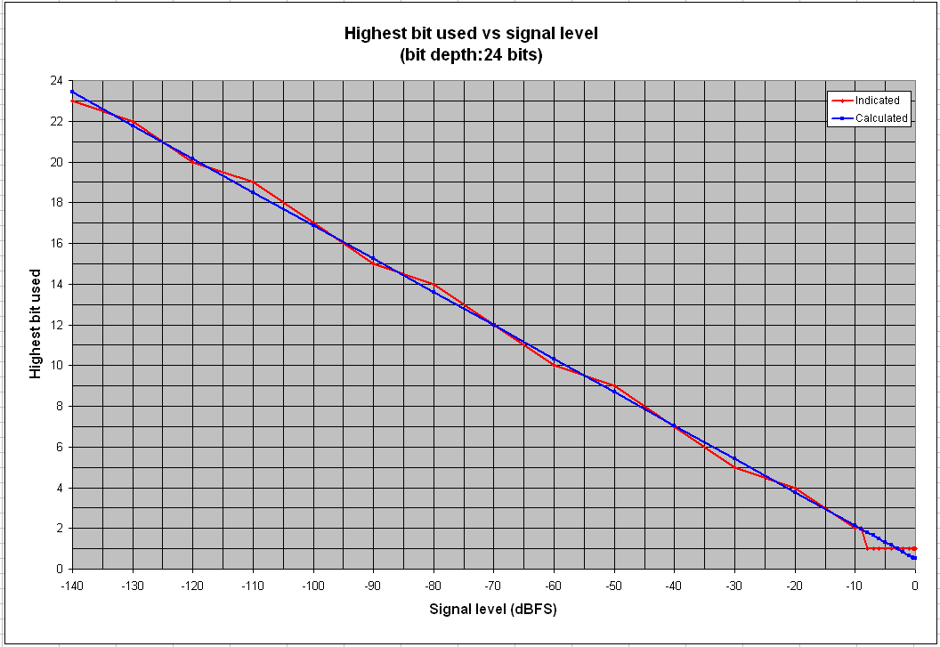

I am about to start digitising the output of my phono stage, so I can feed it into the digital input of my miniDSP 10x10Hd.
The ADC I'll be using is 24/192 and has an input maximum of 2v.
I can adjust the gain of my phono stage to vary the output level between 200mV and 600mV - so my question is ... what is the optimum signal level (average) to feed into the ADC?
If I set the phono stage gain so that a 4mV MM delivers 200mV into the ADC ... then I am allowing 20dB (10x) headroom for peaks. However, because most of the time I am feeding only 200mV into the ADC ... I am not as far above the noise floor as I would be if I were feeding an average of, say, 500mV into the ADC.
Yet if I (on average) feed a 500mV signal into the ADC ... I only have headroom of 4x.
So we have to balance available headroom vs. distance above the noise floor - has anyone recommended the optimum?
Thanks,
Andy
George: You beat me to it I was re-reading Scott's LA paper to see what his advice was. I came up with 24dB so we are close enough. I blame the fact that I have quite a few recordings that are a tad hot. But as my cartridge selections cover 2.5mV to 5mV output I need some gain adjustment anyway so a bit more range on that makes sense.
FWIW and in case I have the sums wrong I have assumed that real music has a roughly pink noise distribution so the boost above 2kHz doesn't have to be accounted for in ADC headroom. Hottest records you can find are +18dB and (from Scott) allow 6dB for the worst clicks n pops assuming as he found that ADCs clip cleanly.
I must have checked tubecad the day before he put the new article up. He really does have an amazing workrate 🙂
Thanks, George - so with 20dB headroom, you don't get a noisy result, when listening to the digital rip?
I don’t think it makes much difference on a 24 bit recording.

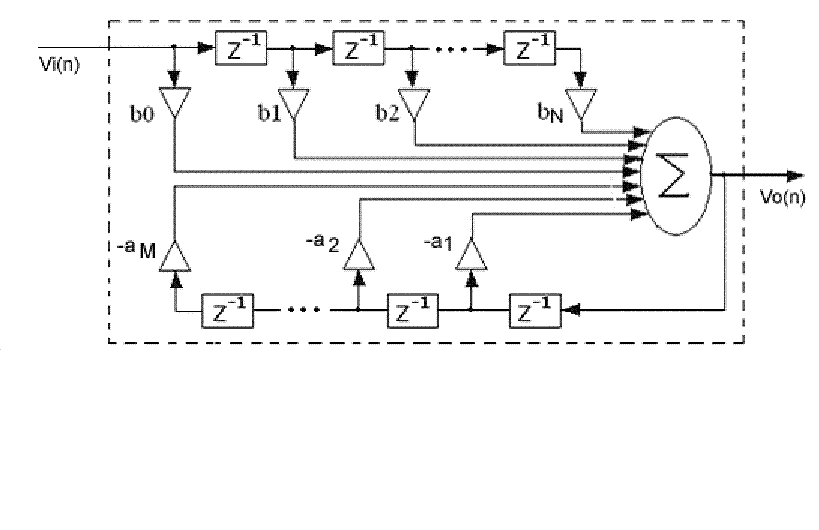

The pic below is Fig 4.1 from SAI.
All da platforms which allow you to define an EVIL FIR already has the top half and the accumulator. I assume, they allow you to enter a list of the b0 - bN feedforward coeffs and to define N, the length of the FIR and Fs, the sample rate. The most convenient way to do this is to have the FIR as a WAV file.
To define an Arbitrary IIR, all you need is the bottom half which is another chunk of memory (which almost certainly exists as an output buffer), a similar bit of code to add the feedback to the accumulator and some way to enter A1 - AM.
There are stability issues with IIRs both in design and the resulting filters ... which many of the references in SAI report. I believe SAI avoids most of the problems and is proven to design bigger IIRs than competing methods without problem.
I'm not that keen for loadsa people to understand & use SAI as it is a big edge in the commercial products that currently use it. But I'm certainly amenable to dreaming up the odd filter for Bill or George ... assuming they have a platform that will accept an arbitrary number of Feedforward & Feedback coeffs.
