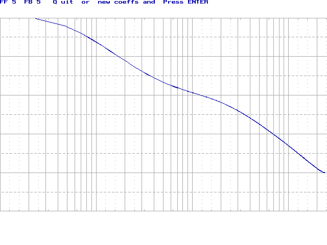

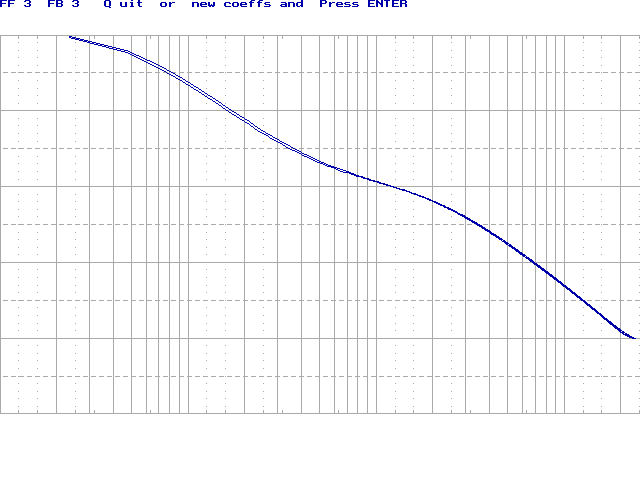

3_3.gif is SAI applied to Scott's FIR with 3 feedback and 3 feedforward coeffs. I'm a bit suspicious of his FIR as it appears to have some hash which you see as a thickening of the curve above 3kHz. 3_3 is clearly more than 0.2dB out below 800Hz

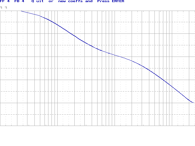

4_4.gif, 4 feedback & 4 feedforward, is out by 0.2dB
5_5.gif is out by 0.2dB at 90, 130, 320 & 670Hz
More coeffs are within 0.2dB ie no change on this display when overlaid
3 feedback & 3 feedforward is the 'same' computational load as 2 x 1st order bi-quads .. ie Scott's 2 x bi-quad RIAA solution is superior ... but as I said, I wouldn't use SAI for anything for which I had a s=jw function.
