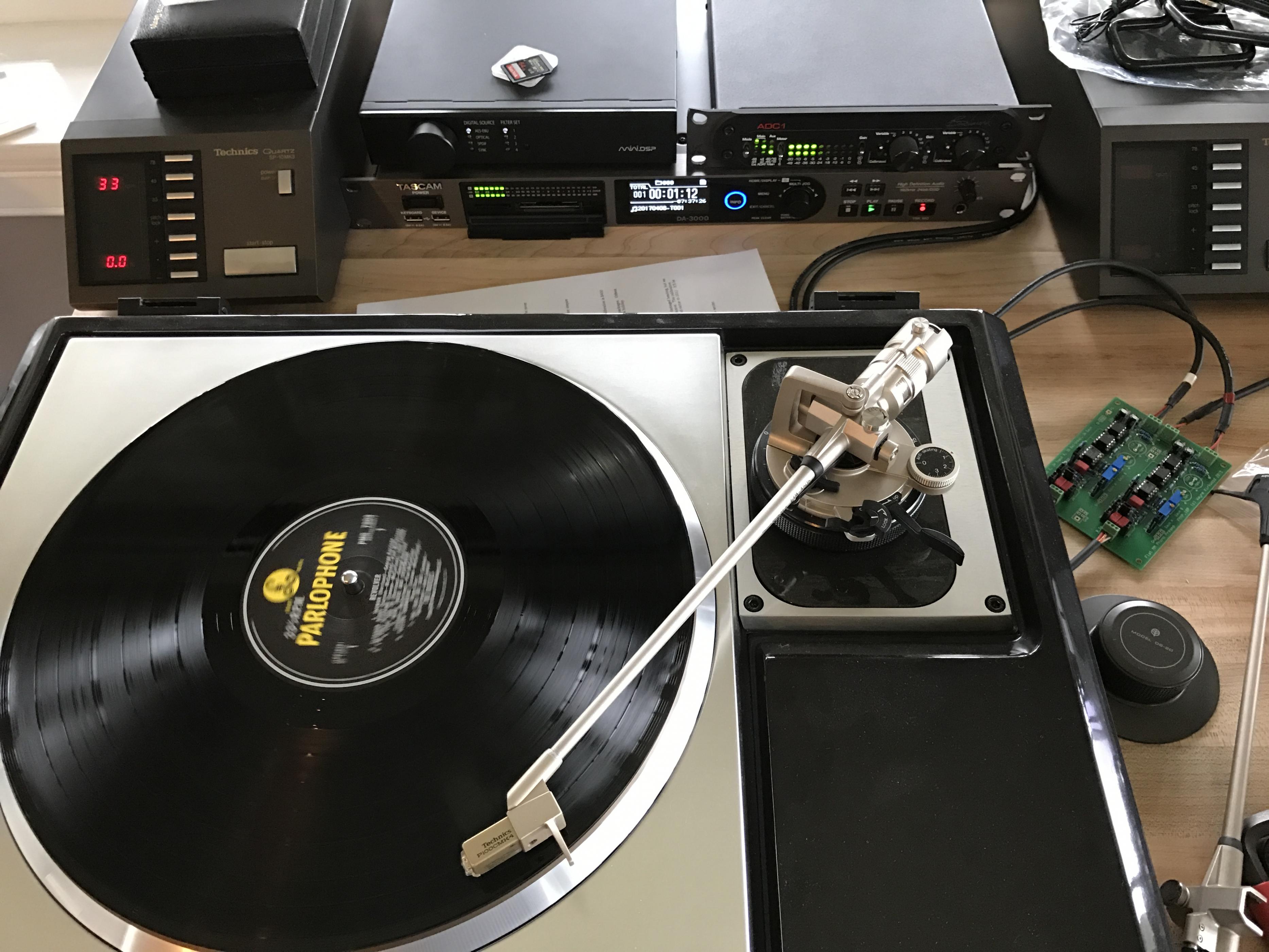

Hi Wayne,
Thanks for popping on. I have to say seriously considering building up the ZTX851 as vero board. There is something very satisfying about two 80p transistors and one 50p opamp getting to sniffing distance of fundamental limits.
And lots of other good stuff I want but currently have zero use for
Thanks JP for the kind words. Nice clean build!
