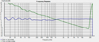

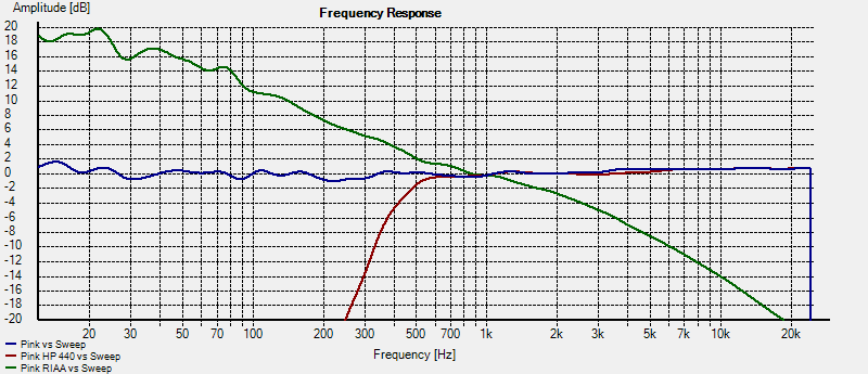

Just as a sanity check I compared pink noise to a log sweep in HOLMImpulse.
You'll see Pink noise, pink high passed @ 440Hz and pink passed thru a software RIAA filter (Audacity).
They look about how I'd expect, so I don't know what's gone wrong plotting your noise file. Since the pink noise plots flat compared to the log sweep, maybe your noise does not because it's not pink. What do you think?

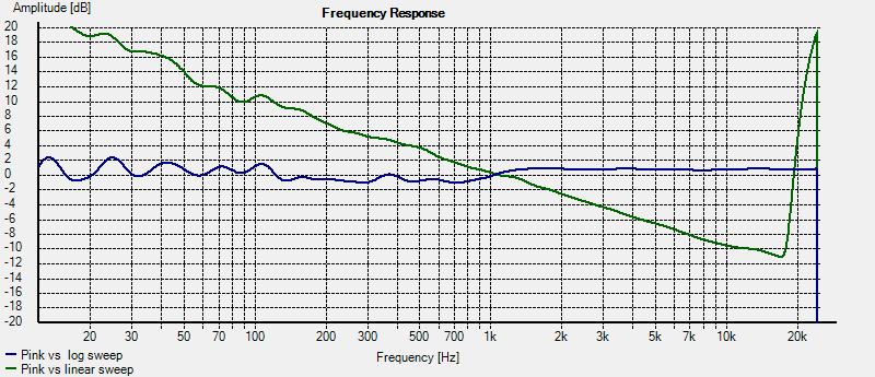

I had made a guess about Holm looking at the integral of the reference curve.
Most probably I was wrong but not totally wrong.
Maybe the plots that Holms is producing is not FFT plots (like me, Scott, Demian have shown) but RTA plots.
FFT: bins are of constant width in frequency
RTA: bins are of constant width in octave (or fractions of octave)
White noise: equal energy per Hz bandwidth
Pink noise: equal energy per octave bandwidth
So:
Log sweeps and pink noise show flat on RTA but dropping at 3dB/octave on FFT
Linear sweeps and white noise show rising at 3dB/oct on RTA but flat on FFT

Yes, George, that seems to be it. Below you will see the same pink noise plotted against a log sweep and against a linear sweep. The linear sweep looks like an FFT plor while the log looks like an RTA. Good catch.
Sorry for the diversion, I just wanted to look at your results in software that I know and use. A few years back I had a good FFT program that ran on WinXP, but it's long gone.

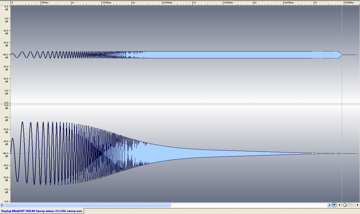

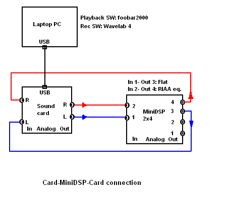

The file from the 2x4 MiniDSP output.
https://www.dropbox.com/s/iz3dbfj0hsl5af9/Replay%20MiniDSP%20HOLM%20Sweep%20minus%2023%20LOG%20sweep.wav?dl=0
The L channel is the flat output, the R channel is the RIAA output
Don’t use the original as reference. Use the L channel as the reference to see only the effects of the RIAA equalisation.

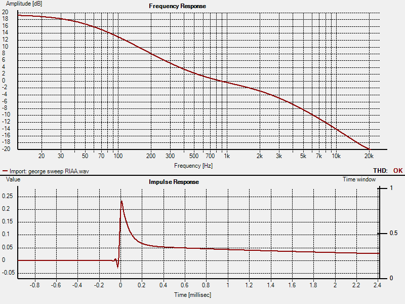

Thanks for running that George.

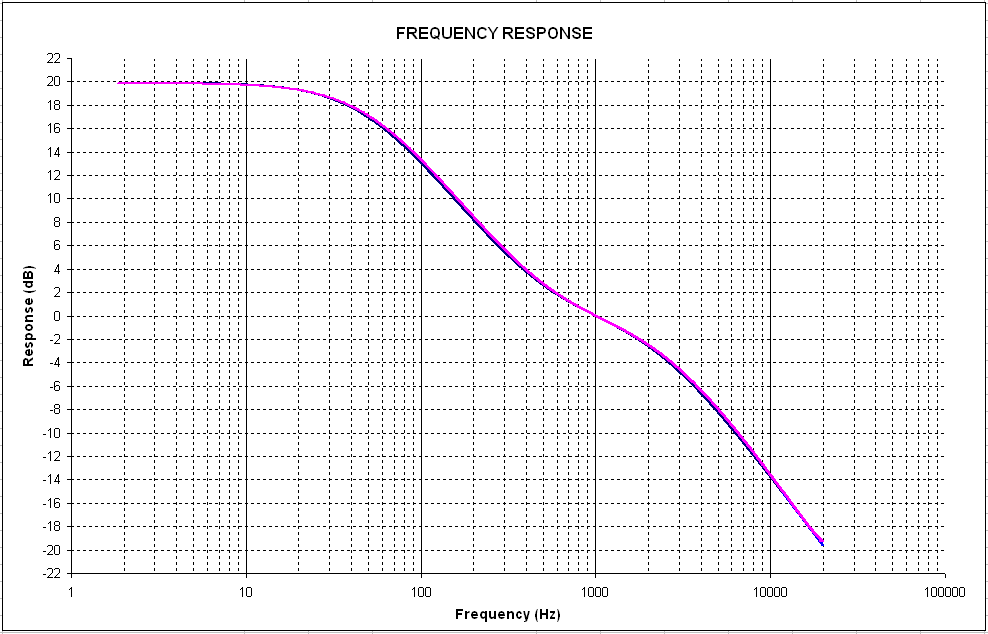

Here is what Holm plotted. I have also attached a txt file (zipped) of the response at 1024 points. You can look at those values to see exactly where the FR is at at given frequency. Sorry about all the values to the right of the decimal, that's how HOLMImpulse exports it.
Good Michael 😎
Here is the analysis of your text file.
Not bad at all
George
That looks good for the single biquad at 48k. The fitting algorithm stops at 20k therefore the abrupt drop due to the warped frequency space near fs/2.

George - have you figured out why the recorded miniDSP output is so off?
Thanks for doing that plot, George. I keep seeing a small depression at 1 KHz in the plots and wonder if it's not a HOLMIpulse artifact. Don't know what would cause it, but it keeps showing up in most signals. I see it being about 0.6 dB but your plots show less
I can only attribute it to the influence of a temporary strange cosmic perturbation (bad aspects in my transit Horoscope) 😀.

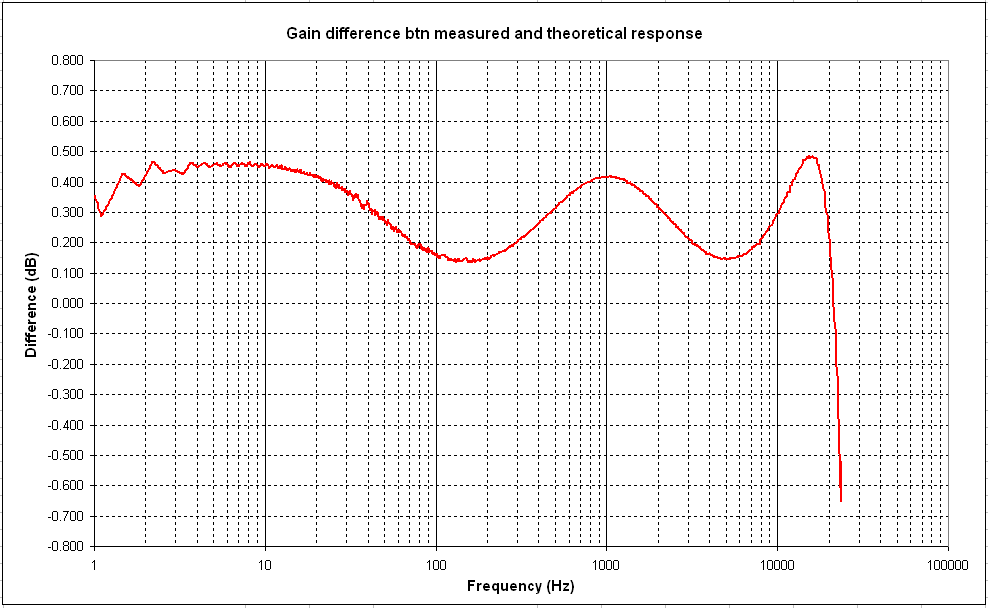

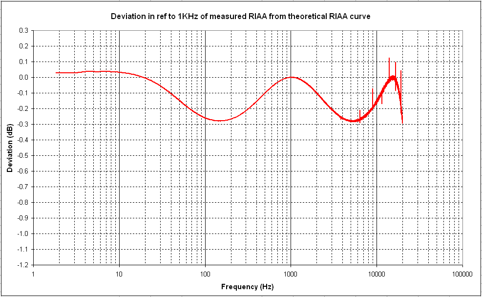

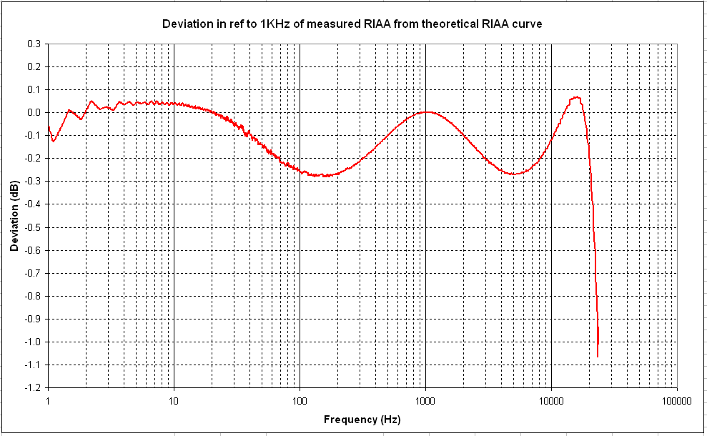

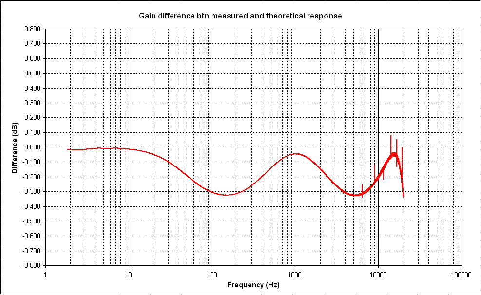

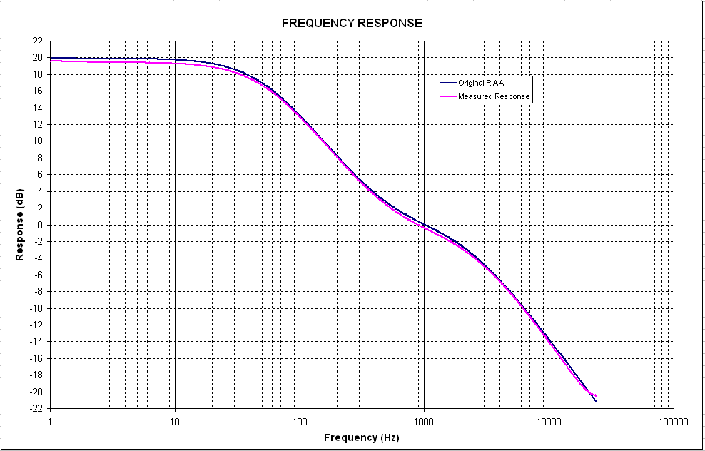

I tested again my 2x4 MiniDSP using the soundcard and REW V5.14 SW with Log sweep as test signal.
One channel (L) of the miniDSP flat and 0dB gain.
The other (R) with your RIAA 48k coefficients for a gain of 13.16dB@1KHz and by setting the input attenuator to –13dB in the plug-in, I brought the gain to 0dB.
I exported the measurements as text (.txt) which I imported in Excel.
Then I subtracted the data of the two outputs for to get the net effect of the DSP RIAA filter.
The results are very satisfactory. The ripple is 0.28dB p-p. (In your article you mention a theoretical ripple of +/- 0.13dB).
There are some glitches present, they are visible thanks to the high resolution of the measurement (54608 measurement points in each of the two measurements).
Bottom line: Your LA article is a great one. The coefficients work very well and the 2x4 MiniDSP does a decent job.

I'll pass on the Ouzo 😉, but everything is working as planned that is good.
BTW to pick a nit the .26dB vs .28dB is accounted for by taking 20Hz to 20kHz exclusively the maths are perfect they can't help it.
