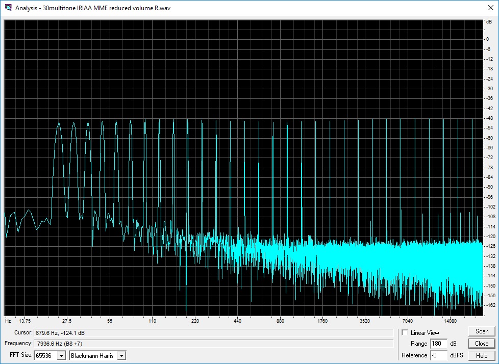

Zooming-in at the FFT :
Scott
This is the FFT from MiniDSP out when it is fed with the 30multitone_IRIAA_48 (att.1) and the psrnoise_IRIAA_48 (att.2).
The results are the same with either the RIAA biquad coefficients that you give on Table 1a of the LA article for gain of 13,16dB@1kHz
[a0:1, a1:1.73273489, a2:-0.73451925] [b0:1, b1:-0.75549731, b2:-0.16463057]
or these that I have used for gain of 0dB@1kHz
[a0:1, a1:1.73273489, a2:-0.73451925] [b0:0.219743778, b1: -0.166015833272721, b2:-0.036176543448862]
When I disable the RIAA equalisation, i.e. in flat configuration, the output of the MiniDSP is ruler flat when it is fed with 30multitone_flat_48 (att.3) or psrnoise_flat_48 (att.4).
I have varied the input level with no change. I even used another pc (of course, no change again)
Scott, when you have the time and you are in the mood, please check with your miniDSP if you get the same waviness with the RIAA implementation.🙂
George

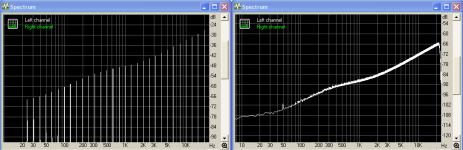

I set Excel to plot the deviation of the simulated RIAA from the theoretical RIAA curve
The simulated RIAA uses the same biquad coefficients as the 2x4MiniDSP uses for the RIAA equalisation.
http://www.diyaudio.com/forums/analogue-source/298896-digitizing-vinyl-23.html#post4907960
There is a similarity in the waviness btn the simulation results and the FFT of the2x4MiniDSP output when replaying the psrnoise_IRIAA_48.
There is also an x6 difference in amplitude (1.8dB p-p for the output’s FFT vs 0.28dB p-p for the simulation) and a shift along the frequency scale (almost by a frequency decade).
I don’t know if this provides any clue as to what is going on

Thanks for the files, George. This is what I found when plotting them.
The ones from #268??
This is what I got. Except for the wavy gravy considering the low level they look OK.
Did you look at any IRIAA data sets in flat mode?
Yes, see attachment. Macroscopically (and acoustically) the synthesized RIAA filter is doing a great job.
I just noticed it and I only want to know what is the source of it.

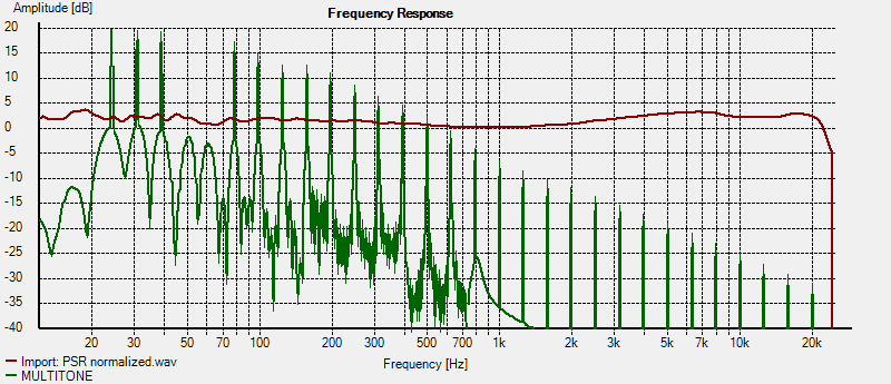

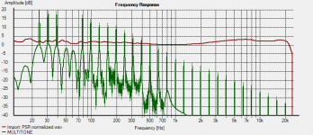

George the files I got from your link were:
psr_noise_IRIAA_48R.wav
30multitone IRIAA reduced volume R.wav

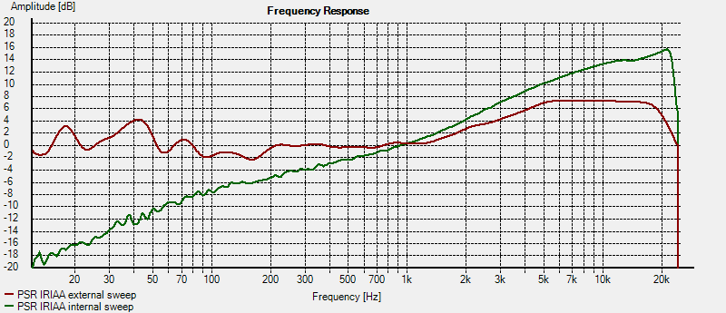

The strange thing is, I got two different plots in HOLMIpulse, depending on what reference sweep I used. In HOLM, you can import a reference file and a file to compare it to. HOLM will then plot the frequency response difference. You can use sweeps, noise, music, whatever. If you want to see the frequency response of a file against a linear plot, you just use a log sweep as the reference.
Normally I use the sweep file generated by HOLM itself. When I did that, the plot was a rising response. When I used a 5Hz-24Khz sweep generated in another software as reference, the plot was mostly flat. That's what I posted. I don't understand why the difference.
Below I have posted again. This time it is your psr noise file plotted against two different sweeps. The green line is the method I normally use.

Hi Michael
I’ve never used Holm but from your description, it must be a SW with a very artistic and creative temperament.😀
I guess you have to feed it apples as a reference when you want to check apples, i.e. sinewaves as a reference when testing sinewave sweeps.
Most probably it makes some decisions based on the integral of the reference signal you select.
From what I’ve seen in your attachments, it can produce very deceiving plots, throwing you totally off regarding the content of the file you test.
If it wasn’t Scott’s and Demian’s FFT attachments to verify my Rmaa FFTs, I would have started spinning on my head.
Now, I think you have to make a few checks to understand what’s the nature of that Holm beast when it compares files
Visit Jan’s site
https://linearaudio.net/downloads
Download these Scott’s test files and check them
1. https://linearaudio.net/sites/linearaudio.net/files/30multitone_flat_48.wav
The top of the 30 peaks should align in a straight horizontal line
2. https://linearaudio.net/sites/linearaudio.net/files/psrnoise_flat_48.wav
The noise trace should resemble a straight horizontal line
3. https://linearaudio.net/sites/linearaudio.net/files/psrnoise_flat_48_holes.wav
The noise trace should resemble a straight horizontal line which is bottomed down at four sections
4. https://linearaudio.net/sites/linearaudio.net/files/30multitone_IRIAA_48.wav
The top of the 30 peaks should align in the inverse RIAA line rising from low freq to high freq
5. https://linearaudio.net/sites/linearaudio.net/files/psrnoise_IRIAA_48.wav
The noise trace should resemble the inverse RIAA line rising from low freq to high freq
6. https://linearaudio.net/sites/linearaudio.net/files/psrnoise_IRIAA_48_holes.wav
The noise trace should resemble the inverse RIAA line rising from low freq to high freq but bottomed down at four sections
