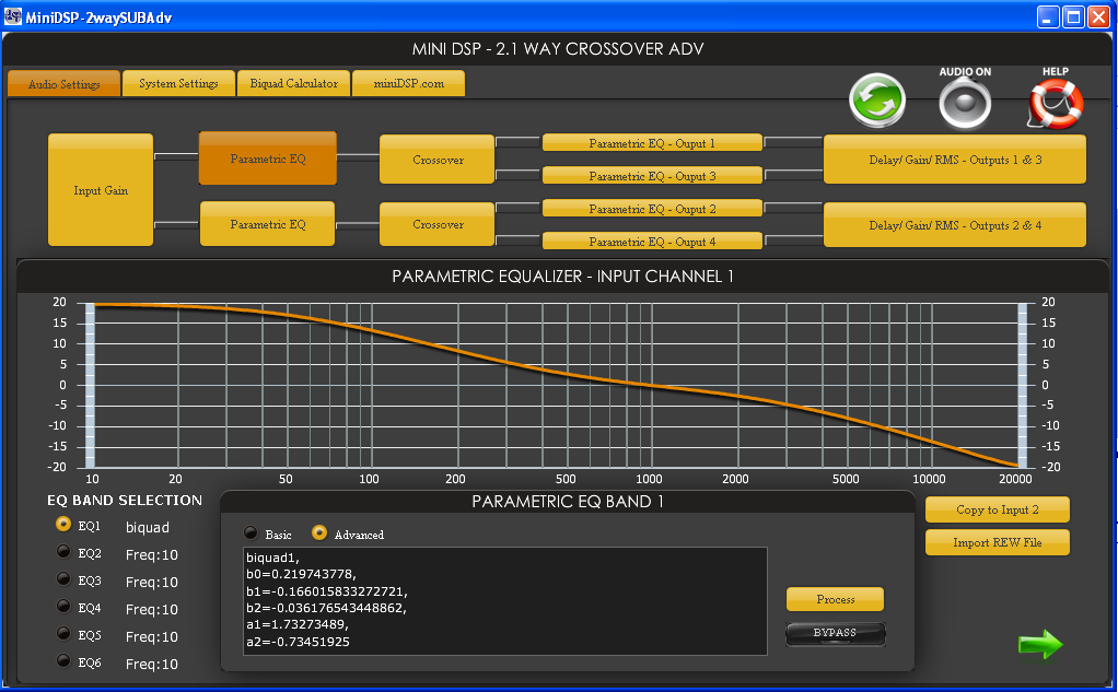

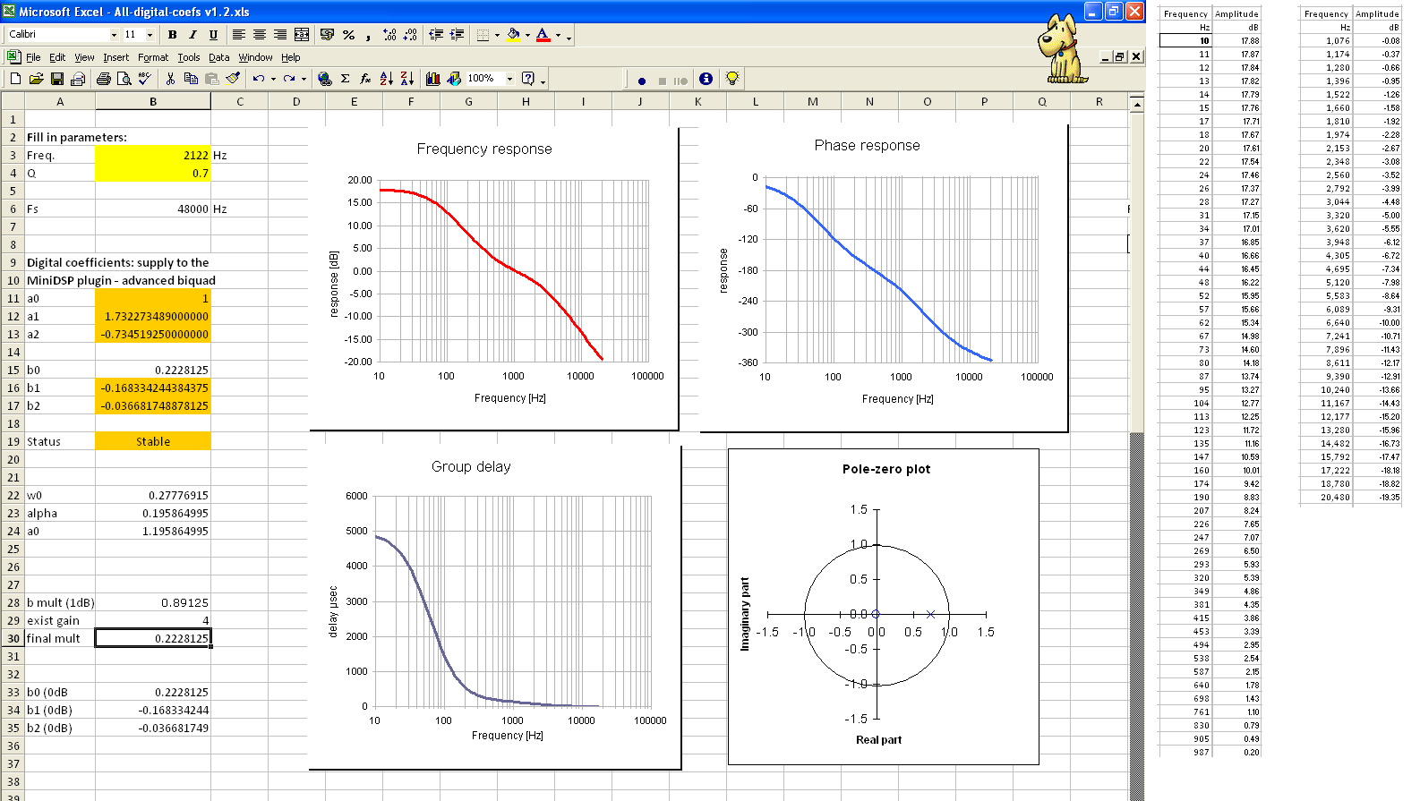

Here is what comes out when plugging these coefficients into the spreadsheet simulator (yes a1, a2 need to be sign inverted)
https://www.minidsp.com/images/fbfiles/files/All_digital_coefs_v1-20101026.zip
Tomorrow I will plug them into the real 2x4 miniDSP and take a frequency sweep measurement. I'll report back.
George
Looks right. The pole out at 2k or so causes the 1dB error at 1k, that is if you want the gain to be exactly 0dB at 1k for the entire RIAA you need to account for it. I set the gain just for this 2/3 RIAA. It won't matter. BTW the ripples in FR are at the .001dB level even at 48K.
EDIT - The gain normalization is simple a multiplier on the b coefficients you can make it anything you want within numerical sense.
Yes Scott, it looks OK.

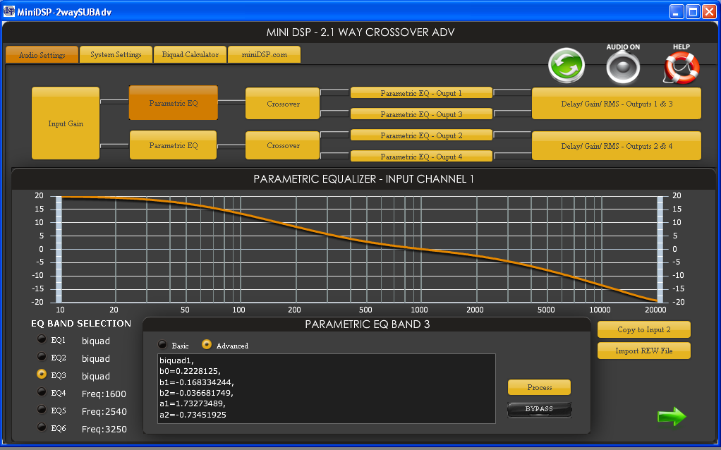

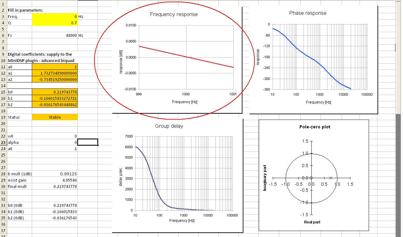

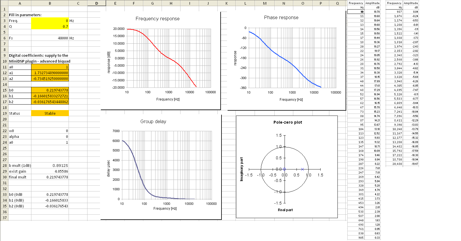

Yes Michael but I worked on it a bit more.
Not that it will matter in the application but respecting Scott’s effort, I tried to make things more precise.
Standard RIAA for 0dB gain with MiniDSP (48KHz sampling frequency and ‘a’ coefficients sign-inverted)

Looks perfect, when writing the article I listened to my Grado cart into a mic pre-amp with the miniDSP and my sound card. It sounded fine with no issues on the pops and ticks. It's too bad I bet a primitive but decent remover could fit into the miniDSP firmware if you are only doing RIAA. I think an even bigger benefit here is for folks with lots of older LP's who want to play with the equalizations.

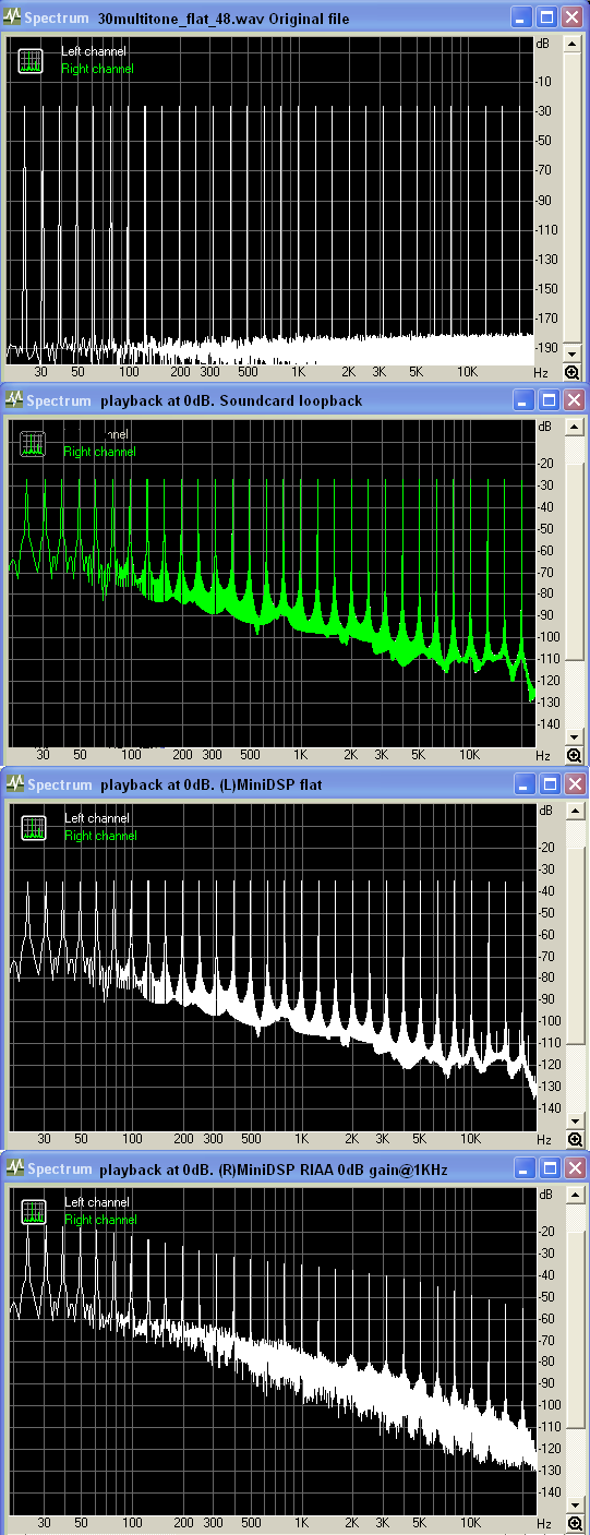

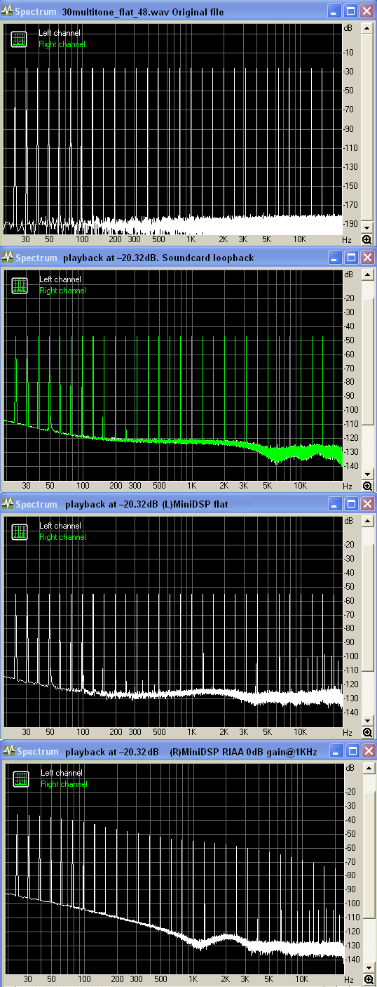

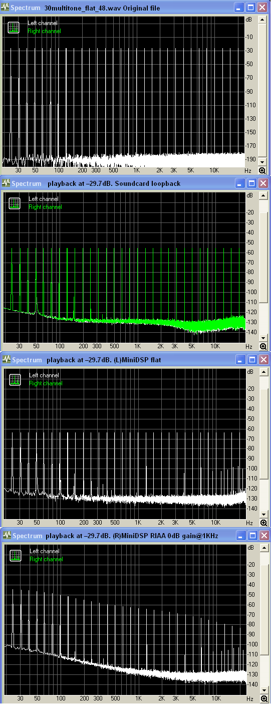

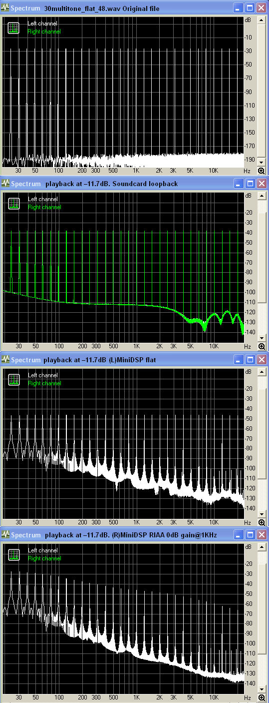

Well, yesterday I thought to test the 0dB @1KHz RIAA on the MiniDSP with the test files that Scott kindly provided and Jan kindly hosted
https://linearaudio.net/downloads
https://linearaudio.net/sites/linearaudio.net/files/v10%20sw%20test%20wave%26data%20files.zip
I start with the 30 discrete frequency tests, as it is the toughest and the most telling test IMO. I think that they are a bit tougher than the richest in frequency and as strong as an fffff music crescendo, so they are good to set the max input level in the ADC-DSP section and give guidance on the headroom required.
1. https://linearaudio.net/sites/linearaudio.net/files/30multitone_flat_48.wav
It was the first time I used a multifrequency format and this file with 30 frequency bins peaking 160dB above the noise-floor is not the easiest to say the least.

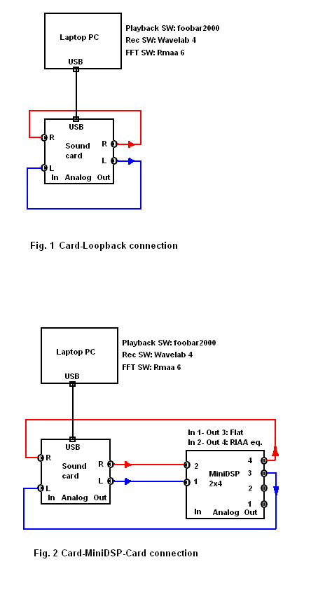

With foobar2000 as the playback SW and Wavelab4 as the recording SW, a laptop PC is USB connected to an external card (M-Audio Audiophile USB).
Card analog output is connected to 2x4 MiniDSP analog input and MiniDSP analog output is connected to card analog input. (att. 1)
One channel of the MiniDSP is set flat, the other is RIAA equalized. Coefficients as per post #227 (same as in #229).
FFT SW is the Rmaa6.
FFT 65536 samples, no window on 24bit/48KHz time trimmed and faded-in/out recordings.
I started with 0dB attenuation of foobar volume level. (att.2).
The overloading is seen from the intense spectral leakage between the freq peaks.
The soundcard stops overloading with the input brought down by 11.7dB (att.3) but MiniDSP output still overloads (high spread leakage) due to RIAA playback equalisation bass boost.
MiniDSP output stops overloading when foobar output level is set to –20dB (att.4)
The peak to noise level ends being 60dB at 20Hz, 70dB at 1KHz, 55dB at 20KHz.
Further reducing foobar level to –29dB (see att.5) only slightly reduces the peak to noise levels but does not eliminate or reduce the peaks of spurious frequencies above 1KHz.
George
>Edit.
First (top) FFT on each column is the original file
Second below is the loopback of the soundcard
Third is flat output from the MiniDSP
Forth (bottom) is the RIAA equalized output from the MiniDSP
