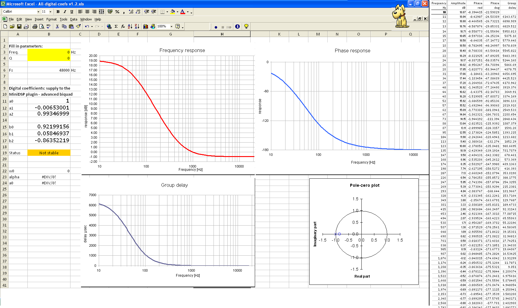

Here's the biquad for just the 50.05 Hz pole and 500.5 zero at 96K. Gain is 0db @ 1k
a = [ 1. , 0.00327033, -0.99672967]
b = [ 0.90862745, 0.02928162, -0.87934583]
George if you want to play with the miniDSP I could do the 48k ones. Don't forget to get the signs right the above is normal (SoX) signs. I forgot the different conventions for a vs b, numerator vs denominator. Only one will work for each application. Easiest visual test is in Audacity (using Nyquist prompt and LISP syntax) it's in their manual.

a = [ 1. , 0.00653001, -0.99346999]
b = [ 0.92199156, 0.05846937, -0.86352219]

If you missed it, they want to try doing the high pole of the RIAA in analog to increase overload margin so they needed the IIR filters for only the two lower time constants
Scott
Here is what comes out when plugging these coefficients into the spreadsheet simulator (yes a1, a2 need to be sign inverted)
https://www.minidsp.com/images/fbfiles/files/All_digital_coefs_v1-20101026.zip
Tomorrow I will plug them into the real 2x4 miniDSP and take a frequency sweep measurement. I'll report back.
