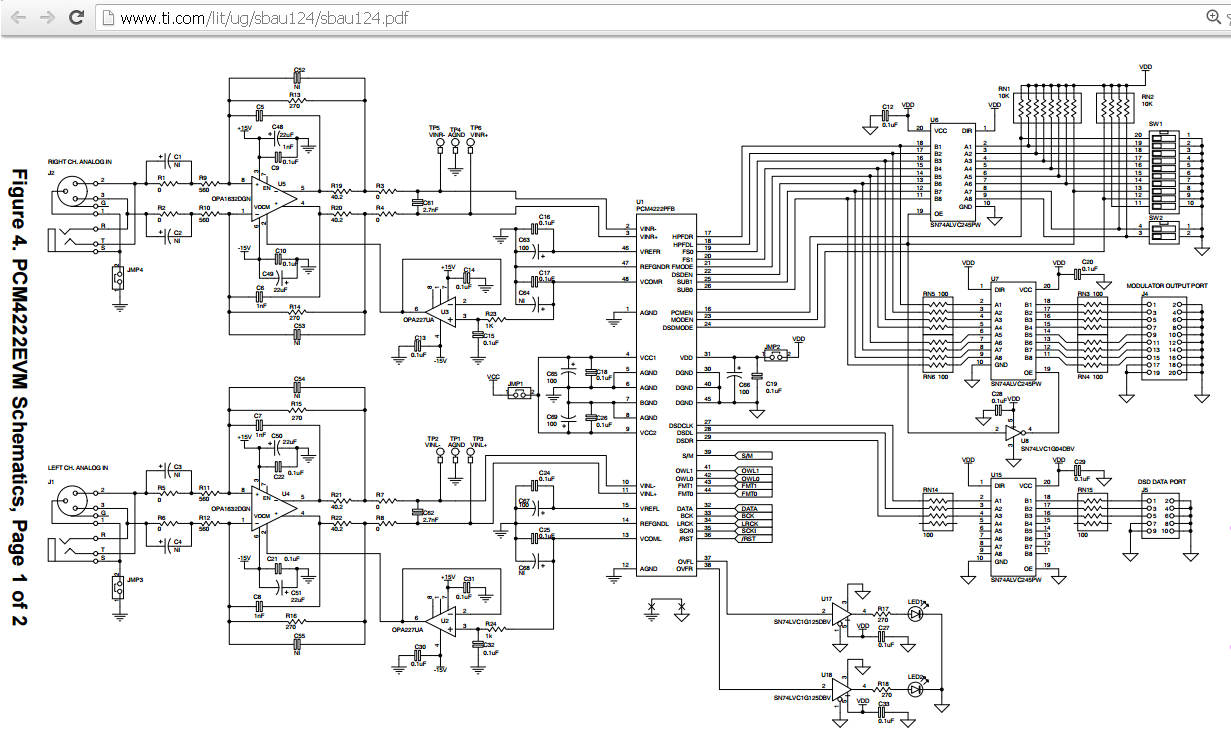

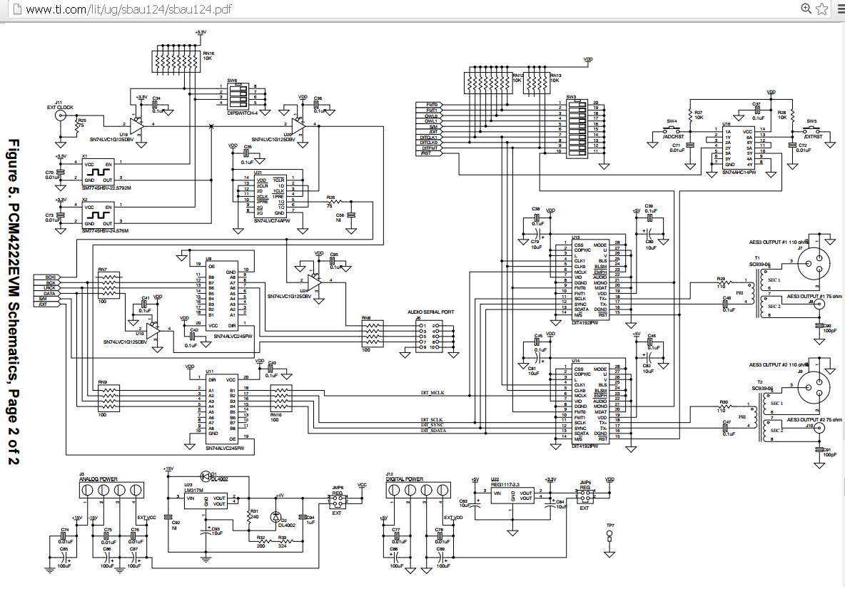

I use this adc.
PCM4222EVM - TEXAS INSTRUMENTS - Evaluation Module for 124dB SNR Stereo Audio ADC with PCM/DSD and Modulator Outputs | Farnell element14
and my own tube riaa preamp.

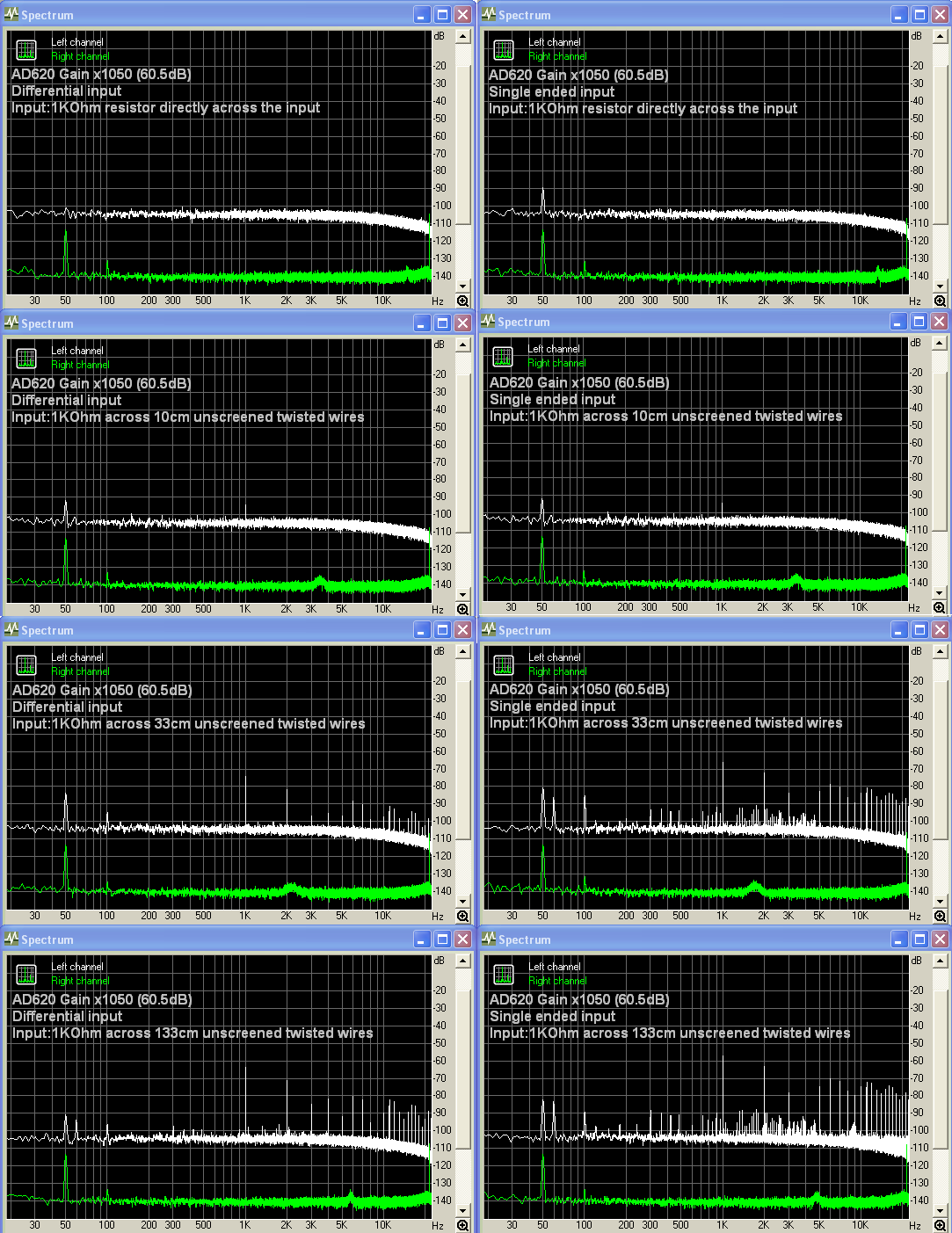

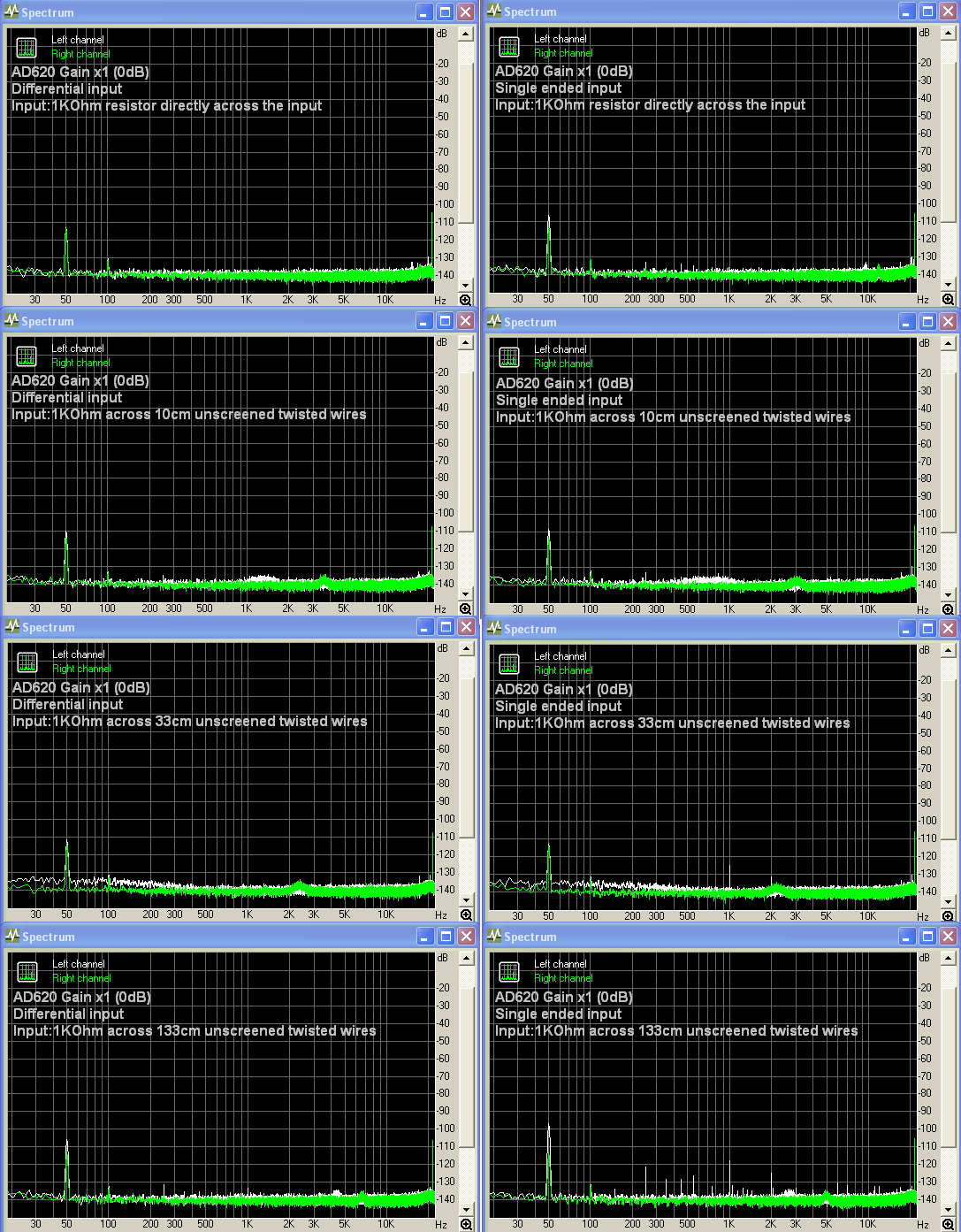

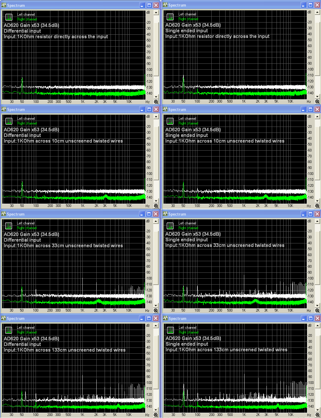

I have to do the 10cm and the 133cm runs again with a 1kOhm resistor in place of the AKG cartridge, for to take the cartridge pick-up of the magnetic field out of the picture and leave only the wire pick-up show on the FFTs
Here it is.
The same AD620 pre as in post #124.
Gain x1 (0dB), x53 (34.5dB), x1050 (60.5dB)
Left column shows the differential input mode, Right column shows the single ended input mode.

In all the tests I have done these days with this preamplifier I notice that the noise floor doesn’t seem to be amplified as much as the amplification factor dictates.
In the case of x53 (34.5dB) gain setting, the noise baseline raises by ~10dB.
In the case of x1050 (60.5dB) gain setting, the noise baseline raises by ~35dB.
This is nice of course but I don't understand how it happens.
On the other hand when I perform the amplification in the digital domain, the noise floor raises up exactly as many dBs as the gain setting.

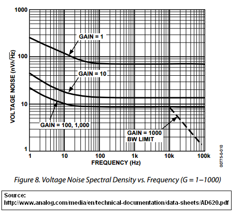

George refer all your noise sources to the output. The two gain settings are exactly 25dB apart so is the noise. The gain of 34.5dB is simply not enough to overcome the baseline (G = 1) total output noise, which includes what you are measuring it with.
Another thing George, this throws some people off but the noise at the output of instrumentation amplifiers is the rss combination of the RTO (G = 1) noise and G * (the input noise) so that at low gains there is more noise than you think because the datasheet stresses the low input referred noise.

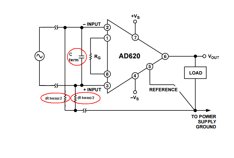

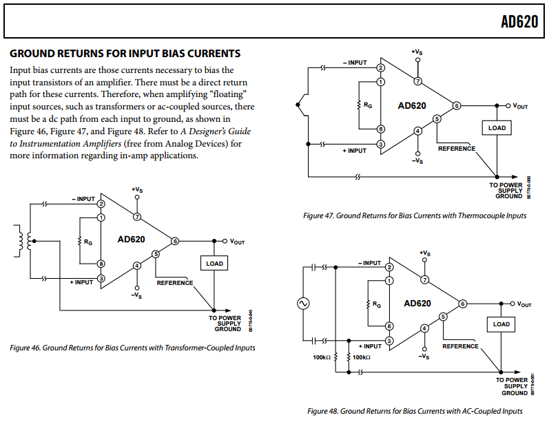

Does the INA need a DC path to ground on the inputs or its that internal? If so what is the recommended practice?
In the phono cartridge case its a floating voltage source and a differential input so if one wire is fixed to ground somewhere it still works essentially the same.
You split the termination resistor to ground and bridge the capacitance across the inputs. You might want to include your favorite EMI protection. I actually used the AD624/744 pre-amp that Walt and I did for years even with MC. I notice we split the R and C at the input.
You ‘ve solved that mystery for me and you covered the issue from all sides.
Thank you Scott.

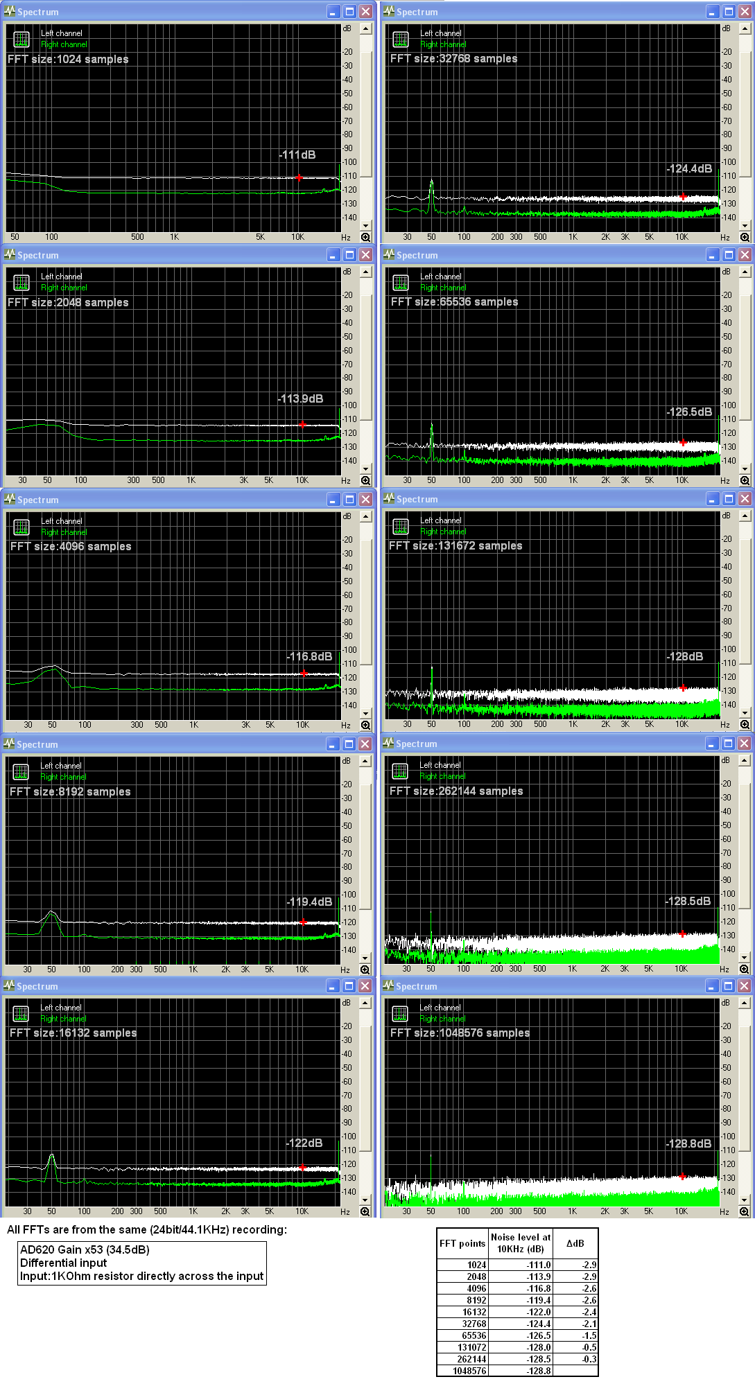

I also understand that what these FFTs show as noise floor is actually the (rms? sum of) the noise of the AD620 and everything that it is connected to it’s inputs plus the noise of the soundcard. All of this then is affected by the choice of the FFT size (65536 samples in my case).
This I had overlooked. In fact the datasheet makes clear (for the people who pay attention) that the total noise has such a relation with the G

Demian, for my part, I was looking for differences in interference pick-up btn differential input and single ended input configuration. And yes, the noise 3dB drop is not present for the reasons you mention.
In the data sheet it says that an external path to ground is needed. (att. 1)
I think Scott means this for the case of a floating cartridge at the input (att. 2)
George
Yes the cart floats and with care you can get the CMRR very high but need to watch out for the line noise at high frequencies which seems to get worse year after year with all these gadgets.
