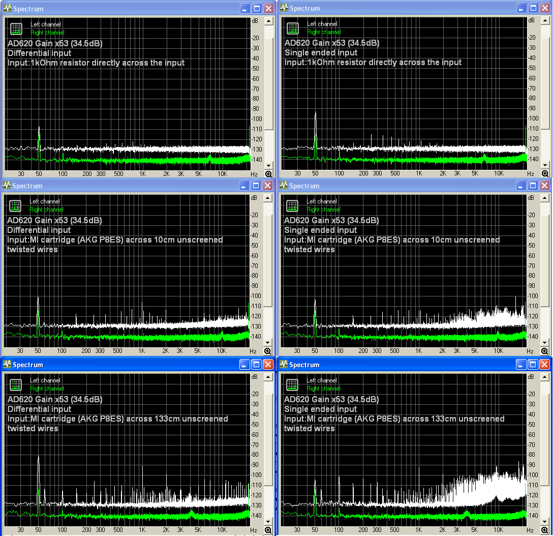

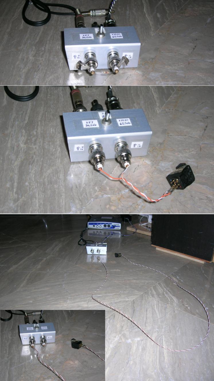

As the front end will be an instrumentational amplifier (INA), there is no point to fit it at the headshell (I am experimenting with an AD620, I’ll report soon).
Although the construction of this INA isn’t that symmetric (*) and doesn’t do justice to the AD620 CMRR, from the initial testings with an MI cartridge (AKG P8ES R=1050 Ohm, L=280mH), it is evident that a balanced input has noise advantage the more cartridge to preamplifier cable length increases

The differential input has more 50Hz noise, but lower HF noise?.... it is evident that a balanced input has noise advantage the more cartridge to preamplifier cable length increases

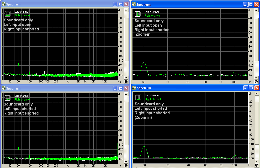

Michael,
With the AKG across the 133cm wire in differential mode it seems that 50Hz has peaked (*). Also note that the 50Hz spike is more or less an artifact of the sound card, see attachment below.
My bad. I forgot to note in the previous post that the measuring channel of the sound card was the Left channel (white trace). The Right channel (green trace) was shorted at the input..
George
(*) And as the measurements were done one at a time, I can not rule out that the 50Hz peak increase was due to an environmental interference.
If it was an environmental momentary issue, the cartridge would pick it up too and what the cart picks up, it shows as differential signal and not as common mode signal, thus the amplification.
I have to do the 10cm and the 133cm runs again with a 1kOhm resistor in place of the AKG cartridge, for to take the cartridge pick-up of the magnetic field out of the picture and leave only the wire pick-up show on the FFTs

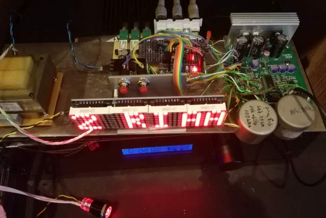

ESS made two ADCs (ES9102 & ES9112) that had RIAA filter @48kHz built in but they are out of production now because of bugs with custom filter manipulation. Anyway, I got ES9102 by a kind donation of one DIYA member and made an ADC with simple opamp line prepreamp for phono cartridge. It works very well for my needs; I didn't use analog preamp anymore so I couldn't listen to my old LP collection. Now I have choice of either phono preamp + line ADC or line prepre + riaa ADC. It's still missing the housing, but already it has no audible noise or hum. 🙂 Maybe will ESS reintroduce ADCs to the production?
