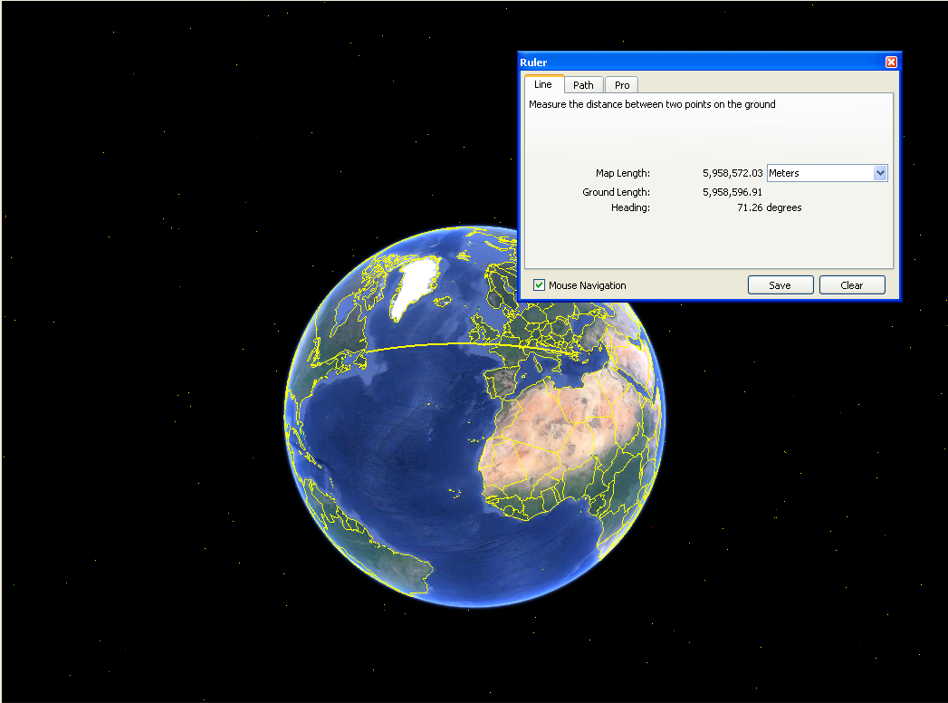

And where does this 60Hz interference comes from? 😕 (Greece-USA about 6000km apart 😀)
George
George
You know you have something when you get 16.66Hz from some of the rail lines. At your service for unexplained noise... ELF-Signals and Ground Currents
