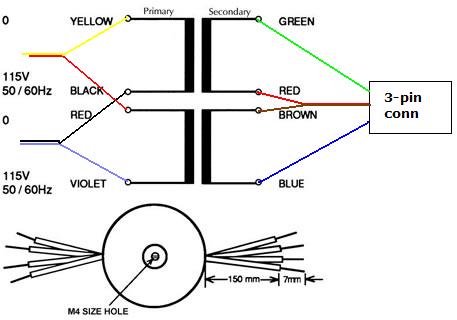

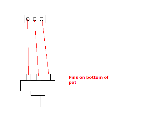

Ok here is where I am stuck. First the transformer hook up. I have the input side figured out but the out to the pre?? Series or parallel kinda lost there. Also the pin out of the pot? I searched all over for it and no luck. Also one other thing, do I need to change the gain on my BrianGT lm1875?? should have it up and running tonight. I'll try to post some pics. Thanks.
So, here a link to the wiring diagram for the trafo:
http://amveco.com/Miniature_Low_Profile_Transformers_2.htm
I meant to include this in the beta kits for those who bought the trafo, but, well, it's beta.
So you would wire it like this...
[edit] That's for 115V power. For 230V, you wire the two center primaries together, and run pwer to the two outside primaries.
