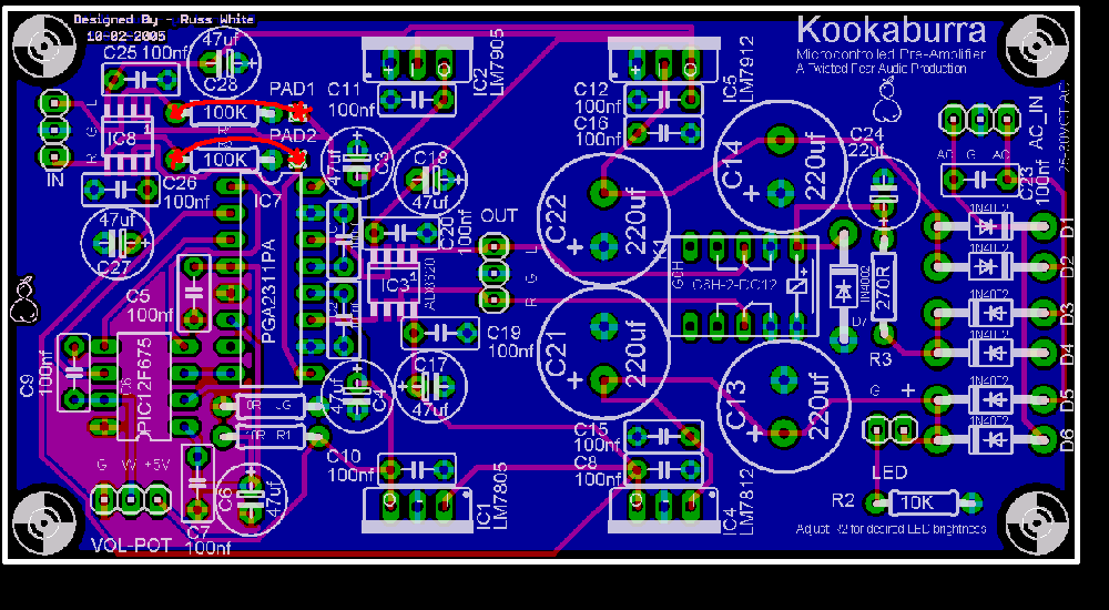

One other thing to remember is that the pots would not have to be panel mount mechancial pots, they could be digitally controlled pots, and that opens the door to remote control, or rotory encoder with push button, or just buttons, any combo really.
Russ White said:If you wanted them all to have the same volume, one other easy thing to do would be to take 3 PCBs and have them all share a common digital PS.
Notice the pot header has +5V, WIPER, and DGND pads.
So you would omit JG and R1 on the 2 "SLAVE" boards. You would then run a wire from the +5V pad on the "MASTER" PCB to the +5V pad on each "SLAVE" PCB. And you would likewise run a wire from DGND on the "MASTER" PCB to the DGND of each "SLAVE" PCB.
Then you would take the 3 wire cable from the "MASTER" PCB to a singal 5K linear pot. You would then run a single wire from the "WIPER" pad on the "MASTER" PCB to the "WIPER" pad on each of the "SLAVE" PCBS leavbing the other to pads empty. Then all 3 PCBs will use the same volume pot, and will have the same volume setting.
The easier way to do that would be that when you make your 3 wire connector for the POT header, you use two wires for each PIN(5V,wiper,GND), would would then put a second connector on one set, and the other set you would run to the POT. You could thus "daisy chain" the boards together, the important thing is that they all share a common PS, so omiting R1 and JG is important for the slave boards.

Well I received the beta kit yesterday and assembled last night. With a few minor hang ups took about an hour and a half. In all went pretty smooth. Great quality kit. I hope to be up and running this weekend. I may need a little help with the transformer hookup and with the jumpers at the input. Brian and Russ are you going to make a assembly guild? If so I can provide a little input on that. I'll keep everyone posted on the progress. 😎
bender460 said:Well I received the beta kit yesterday and assembled last night. With a few minor hang ups took about an hour and a half. In all went pretty smooth. Great quality kit. I hope to be up and running this weekend. I may need a little help with the transformer hookup and with the jumpers at the input. Brian and Russ are you going to make a assembly guild? If so I can provide a little input on that. I'll keep everyone posted on the progress. 😎
Hi Bender,
Great you can shoot me an email if you have any specific build input.
I will see about a build guide. I think I could throw one together. 🙂
As far as the jumper for omitting the input buffer it simply goes where R4 and R5 go neer the input buffer, only you put one leg of the 0R resistors(jumpers) in the jumper pads PAD1 and PAD2.
here is a PIC:
FWIW I would use the input buffer in most situations, it does just seem to make the thing sound better overall. You can use just about any unity gain stable SOIC dual opamp. A good relatively cheap choice is the OPA2227, or you could spring for another AD8620, you could even use two of either one. I have actually built one with both buffers being OPA2227 and one with both being AD8620, they both sound awesome, and you would be hard pressed to distinquish between the two.
Cheers!
Russ
Cheers!
Russ
Hi there Russ. From your previous posts that is what I thought on the jumpers thanks for clearing that up. An assembly guild is just a thought. I would put myself at a medium level builder. The guild would have only saved me from searching this thread once. So really this thread is a good guild by itself. 🙂 But for a real novice
We are actually thinking of chaging the op-amp included in the kits to the OPA2227, and including both. This would help keep the cost reasonable,as the 8620s are pretty pricey. Anyone have an opinion about that?
