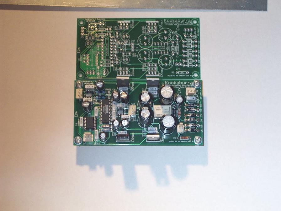

home to roost! 🙂
Got home from work, and a whole flock of Kookaburras was on my porch. Anyway the PCBs are great! A little annoying issue with the silkscreen made some of the lettering run into some hole, but nothing important. 🙂
Anyway, the thing sounds even better now that it has a serious ground plane and noise floor is even lower than before. The input buffer does seems to help the low end, even with ordinary (low Zout) sources. Probably because it increases the Zin.
Overall, I am very satified, and it should be a relief to the beta builders that you can be sure the PCB is OK. 😀
Has to be a record build for me, only took about an hour.
Now time for some pumpkin ale. :drink:
Cheers!
Russ
