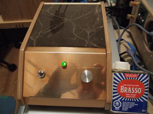

As mentioned before my pre will not work at all without this one jumper in. Anyways I was trying a few lower value resistors in that spot and also bypassing the resistor with some low value caps-100nf mfp and other ones.I got mixed results with nothing really doing anything except this last one: Every system is unique; what I ended up with was a 0r jumper by-passed with a axial 200vdc .1mfd. "silverfilm";I like it.
cheers
doggy🙂 🙂
Do you mean from the 0r jumper to ground? A straight cap in the 0r jumper spot will not work at all for me;I tried a few different values. Brian I am happy, it's sounding good.
Just to inform; the pre was working all along with th 0r jumper in but I just wanted to see if I could match it better to my system.
doggy🙂 🙂
p.s doing my xmas polishing; he..he..
