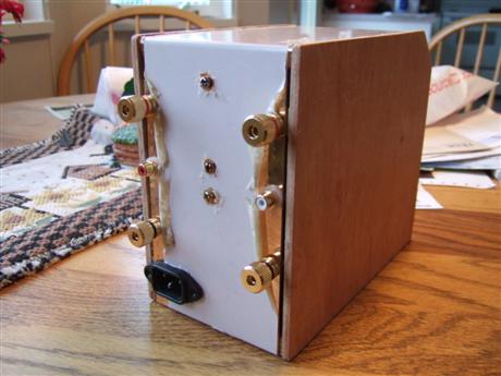

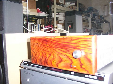

the housing
As allways with these projects the right housing is the challange.
As things look now, with Sinterklaas behind us the coming weekend will be listening time.

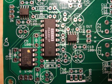

doggy said:Just want to make sure about the direction of the chips on the pcb; does this look correct? Concerned about the op amps especially.
thanks

Doggy, I spoke too soon. Your opamps appear to be reversed. I had to dig my prototype out of its case and look. The dot/indent on the opamp indicates pin 1, and the should match the "1" on the PCB.
