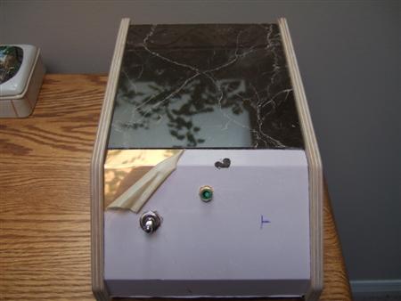

progress so far:
Chassis is wood; sides and back are left-over baltic birch [note plys]. Front is 1/8" bronze; top is marble tile-had a good time cutting with a wet saw; it wanted to chip! Will finish with nitro. lacquer[it drys fast].Front face has led, on-off toggle switch and volume control when the kit arrives. My source selector will be mounted at the back; close to the rca's.

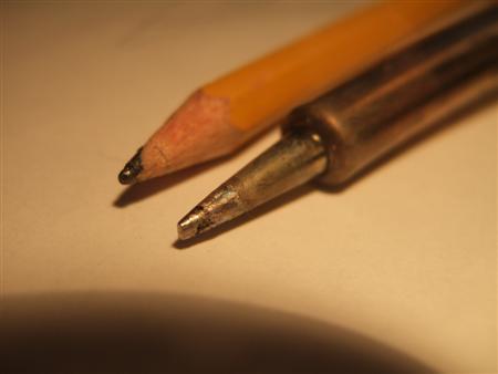

The Hako 936 soldering station cost about $120. but it is very good. Heat up is very fast, about 30 sec. and the tip is really durable. My last 40 watt iron, the copper tip eroded with use. Also the hako 907 iron is slim and able to get in tight spots
